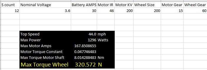

make a calculator… :grinning:
Show me the formulas :joy:
I checked your calculator… what you have labeled as “max wheel torque” is actually the vehicle thrust in newtons (starting off from a stop sign).
simply lower the resistance from 70mOhm to 20mOhm and you should see that thrust increase by a certain amount.
if you convert newtons of thrust to pounds of thrust we can do a comparison of our findings.

Thats a bigger difference that I anticipated.

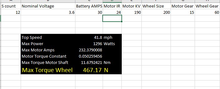

why did you change the kv and the resistance - we’re only talking about changing the resistance.
Because the 6354 motor is 200kv and the 6374 is 190. Changing it to 190kv on the 6354 is brings it to 340 N so not a big difference.

It might be… but regardless if you lower only the resistance with your calc, you get more torque, and the reason you are surprised by the amount is you are calculating for accelerating from a stop sign, where the effect would be hidden by the motor current limit. The additional thrust afforded by lower resistance decreases with additional speed, so by the time you get to 15mph where you are limited by the battery current setting and can feel the effect, it is a bit diminished from the case of accelerating from standstill.
