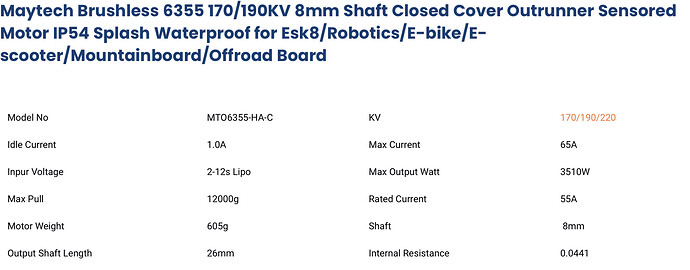

6355
65A 12000g pull =185g pull per amp

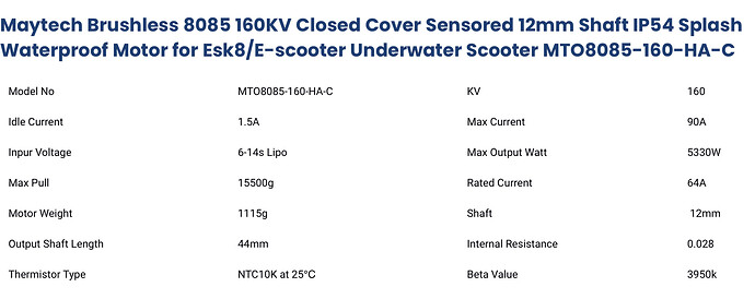

8085
90A 15500g pull = 172 pull per amp
Smaller motor is more efficient making motor power at the wheel unless it’s a limiting factor. Idle current is a direct representative of the losses in the motor. More losses need more ideal current to overcome.
i’m not familiar with “pull per amp” - there is a kt torque per amp constant, which is directly calculated from the kv of the motor only.
Idle current only represents iron loss (which is only a factor close to top speed - that’s the speed at which it’s measured).
If you also factor the I^2R loss you will
see this is the dominant loss until around 8000-10000 rpm depending on the details of the construction.
Not the only loss going on Iv already said
Accelerating through ~15-25mph, I^2R is the dominant loss, iron loss comes into play above ~30mph.
The faster the motor turns above 10000rpm, the greater the significance iron loss will become, but below 5000-8000rpm roughly, the larger motor wins the efficiency pageant, because I^2R losses (of the smaller motor) vastly exceed iron losses (of either motor).

…if you switch to a bigger, same kv motor and the resistance drops from 70mOhm to 20mOhm giving 10-12lbs additional thrust at 15mph w/ 30a bat / 80a mot limits per motor (2 motors, 12S, geared for 35-40mph)…
…or if you hold a 12lb weight in your hand…
…you’re going to feel it.
On top of what? 10lbs extra on on 20lbs is quite a bit but 10 lbs extra on 500lbs is nothing.
12 lbs on top of 72 lbs. (72 lbs → 84 lbs @ 15mph)
