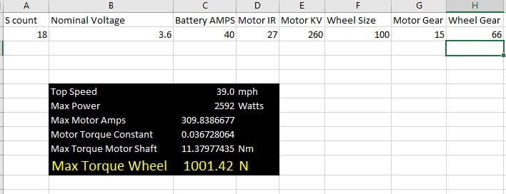

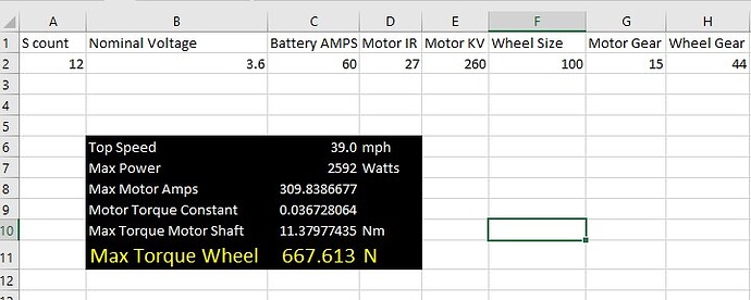

@Gamer43 Thanks, I am getting wildly different results to you for “Torque at wheel”
12s setup
12s3p samsung 30q
190kv motor
100mm wheels
15/32 gearing
battery amps = 60a total. motor amps are setup to 10000000amps. Motor IR = 55
Max Power = 43.2 x 60 = 2592 watts
Max Motor Amps = 217 amps
Max Torque constant = 0.05
Max torque at motor shaft = 10.9
Max torque at wheels = 1164
I used 32/15 * 10.9 * (100/2) = 1164 for the torque at wheels. You got 448. Where is the error? I am having the same issue with the 18s calculations.
I made a mistake in the last formula, divide by the wheel radius
Use standard SI units :man_facepalming:
I also got slightly less because I used 2400Watts instead of 2592W
Alright, thanks. Here is my calculations

The calc is inaccurate, see ohms law…
As one example, with 64.8v and 98mOhm, max possible motor current is 661.2a, not “162.6a”
I suggest starting a new thread since this has gotten far off topic.
But to summarize the answer to the OP’s question, 10-12lbs additional thrust @ 15mph is plausible by dropping the motor resistance from 70mOhm to 20mOhm with a larger, same kv motor and changing nothing else. I assumed 2 motors, 12s, geared for about 40mph, with 30a bat and 80a motor limits per motor. At 15mph, they’d be hitting the battery current limit and not the motor current limit, and essentially the lower resistance motor has more motor current at that speed than the higher resistance one on account of lower I^2R losses (both have less than 80a motor current available at that speed on account of the 30a battery limit, but the lower resistance motor’s motor current is higher).
I just followed @Gamer43 formulas yo.
If you’re getting 162.6a motor current with a motor that isn’t turning, and you have 98mOhms, then the voltage to the motor is 15.9v. (see ohms law) That’s also 2590 watts. Since the battery voltage is 64.8v that works out to about 40a battery amps.
