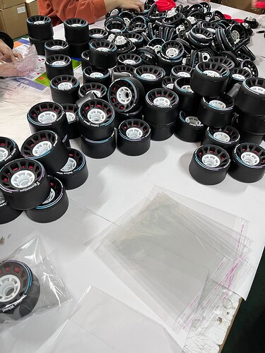

Update: Packing of V2 Comfort Wheels have started. They’ll board a boat before Xmas. Manufacturer anticipates next batch to arrive at my warehouse by the 20th of January. I think we have ironed out the shipping kinks last time so expecting high delivery accuracy.

V2 Comfort Hollow Wheels are on the boat and arriving on the 20th. I hope everyone had a great Xmas and are gearing up for a great 2023!

The V2 Hollow Wheel Comfort will be arriving by the 20th of January. The factory is packing the wheels this Tuesday and they will be boarding a shipping boat right before Christmas. We have learned a lot from the shipping experience of the batch 1 and think we will be able to get through the shipping experience as fast as possible without USA customs issues.

These all have the suspension inserts, in the pictures.
