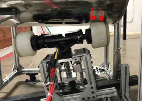

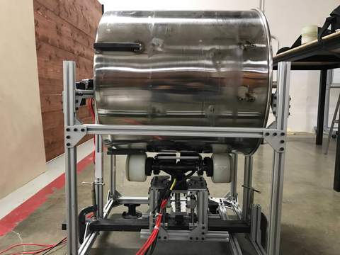

This is a testing machine that simulates pot hole riding: https://www.youtube.com/watch?v=8H4zavx8XDc
Figure 1: This is my testing machine where the wheels are attached to electric skateboard drivetrain.

What is this Test Rig Machine??
Designed to reduce durability testing time. Designed to simulate forces and temperature from real life.
  • Pothole impact forces
  • Cornering forces
  • Normal Riding forces
The machine has an electric skateboard drive train and has springs to simulate a rider of 500lbs (getting the test rig to rotate that at high speed is another story… Hint: doesn’t really roll that well at high speeds).

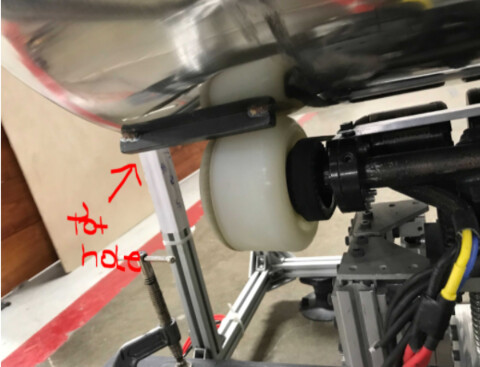

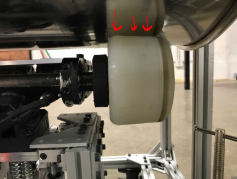

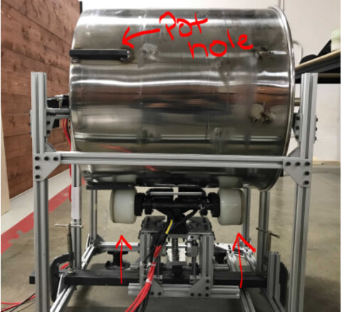

High Impact Pothole Forces
The wheels and drive train are placed under a drum to simulate road forces. In this configuration, we test normal riding with radial forces placed on the wheel as well as shock testing from a pothole.

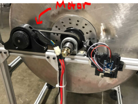

Rolling Road Resistance
The machine also places load on the core to simulate rolling road resistance as well. This is a picture of a motor which acts as a brake for the drum. Bonus points if you can guess what that motor is from.
Pothole and Radial Load Testing Method
The pothole testing is an example of a high accelerated life testing. A test is run at 35 mph, which means that the wheel is getting hit about 40 times per second. 35mph is the fastest I can go in this particular test because it turns out hitting a pothole 40 times a second makes it hard to travel much faster with the battery pack that I have (Thanks, Jansen!). This test is run for every 2 minutes and then checked. This means that every 2 minutes, the wheel takes a pothole hit 9,600 times every 2 minutes. The wheel is also heated to 130F. Then there is 2 minutes for inspection for failure. Then repeat till the wheel breaks.
So yes, I am brining the wheel to a point of failure. Now the question is… how do I correlate this to 2,000 miles? This is what is honestly confusing me.
