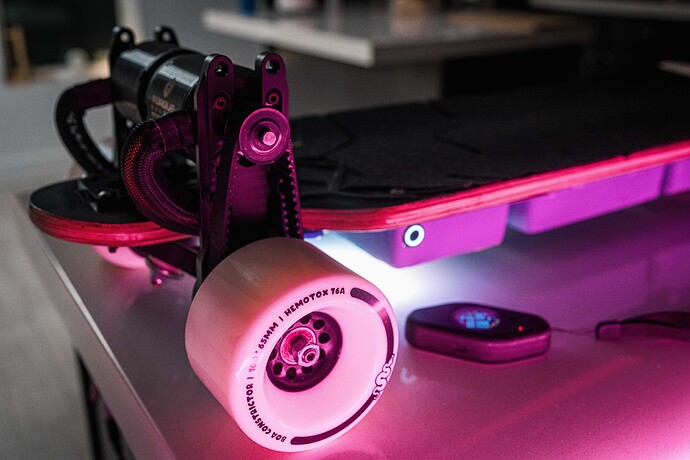

My all time favorite board to take out is the Evolve GTR, but I wanted more battery, higher top speed, and an option for RKP, so I built this one up from scratch. I wanted to keep the soft bamboo deck, low ride height and general form factor of the GTR.
I wanted a low ride height and used 85mm Caguamas, but I kept scraping the bottom on EVERYTHING (you’ll see that). Ended up with 100mm Boa Constrictors.
The drop through and split angle RKP trucks make it super easy to fly at high speeds; I can cruise at 38mph+, stay relaxed and keep confidence through road chudder.

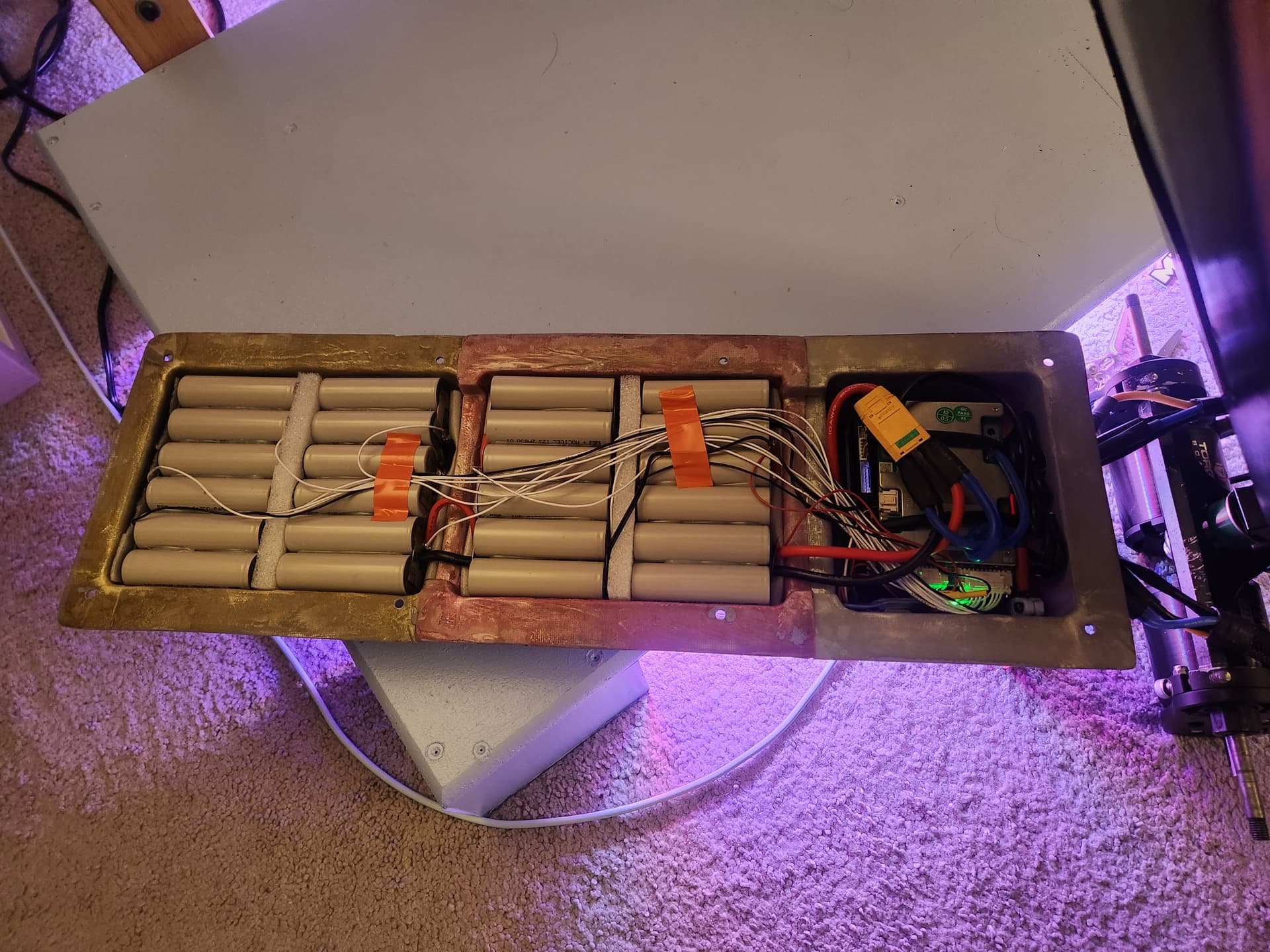

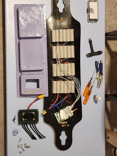

I printed a compression mold out of ABS, vapor smoothed, popped out 3 fiberglass sections (for flex). They align with the original Evolve GTX screw holes. Spray painted and masked off a slot for LEDs to shine through.
Molicel P45B 12s4p, LLT BMS etc… screw fishpaper, hope this works out.

I’m going to be brutially honest here, you have over 24 hours of read time on this forum, you should know that battery construction like this does not survive the vibration and forces of an esk8. This is dangerous at best.
I would highly recommend reading through a good chunk of this thread and finding out how and why we build esk8 packs in a very specific way.

But as others are saying, this battery is halfway to being an impossible-to-extinguish firebomb. It’s a hazard for you (it could cut out without warning) and to those around you (poor construction = ticking time bomb). This means everyone living in the houses and/or apartments adjacent + any flamable structure you take it into.

I like quirky DIY stuff like your own enclosure and such, but that pack has like 1.5/10 effort towards keeping it safe. You gotta pull that and make it safer. You had to have known posting that here is like a bucket of chum in a shark tank.
I realize that abrasion between the heatshrink could short a P group.
The cells are sitting on a plush layer of foam, and I check them occasionally.
I’ve built several packs before and I want to see how this turns out.
I understand the risk and am keeping an eye on it. If they show wear I’ll just pull them and wrap the P groups. Right now I’m around 700mi.

note, a foam bed only mitigates 1 axis of movement,
They are okay, but I’d prefer them to be under the deck. Unfortunately that just won’t work with this setup.
It’s possible to step into the motors on accident, or if you have bell bottom pants to get those caught up.
But in terms of clearance and keeping your motors and belts away from damage, they’re great.
LOL. Literally all you would have to do to make this not a fire hazard is wrap the center P-groups with fish paper or tesa tape.

not to mention, adding to this, the balance leads are also prone so wear and are just as much a concern as the 0 isolation.

'Cause there are at least a half dozen other things that constitute risks to life & property. Abrasion of balance leads & cell heatshrink are just two examples.
I could figure something like that, or I could shift the back trucks about .5in and re-drill holes, that would let the motors clear the tail too. But I’ve just been alright running it like this, it doesn’t really bother me anymore.
