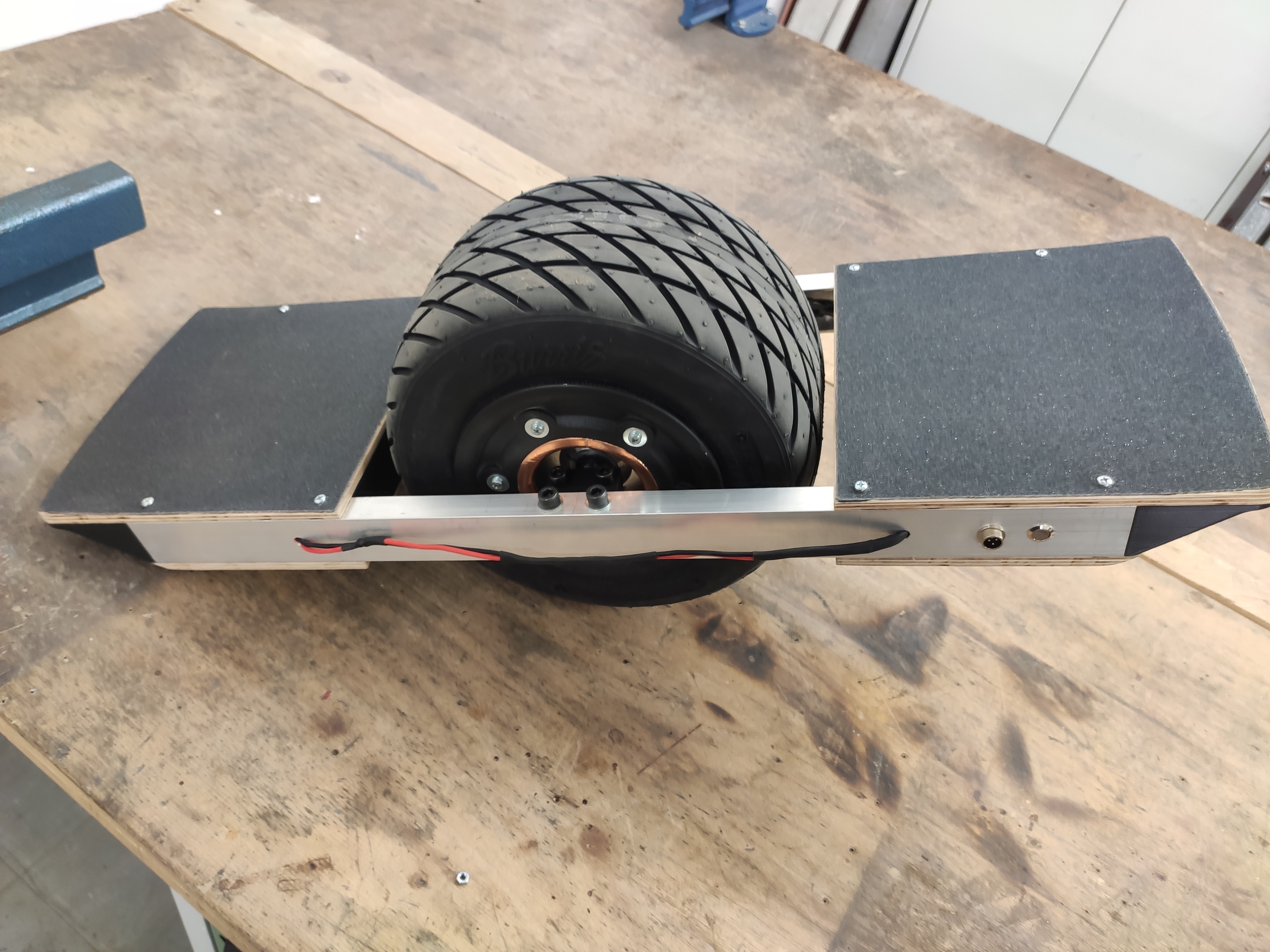

At the Moment it is nearly impossible to get up onto the board. As soon as I press the button by feet to activate the Gyroscope, the board starts running backwards because of leaning back.
Furthermore the board levels itself by pressing the powerbutton. So it starts moving till it’s horizontal and then stops suddenly. I think the Mainboard or Gyroscope is faulty or just not ideal for this project.
I tried to calibrate it leaning backwards, so that it won’t run backwards directly when pressing the activation button
I would put your foot on the low side first, then the high side. When you touch the button on the high side, it will pick up your foot that’s low.
Change the order of which foot you place first.
Thanks for your reply.
I changed the mainboard and gyroscope and now it is working much better. The one before did not work as it was supposed to.
I do start with the low side and then step on the high side with pressure sensitive pad.
The Pad is atm too sensitive which makes it even harder to get started.
I think I have to train hard :smiley:
I will print a cover for the Batterie-Cable, which also will be used as a charging-port-protector.
The majority is done.

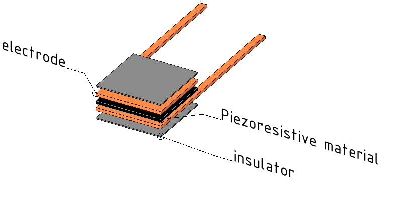

how did you make the sensors work? if the plates are screwed on?
I installed pressure sensitive Pads and connected them to the Gyroboard. I created a sandwich of Copper, Velostat and Copper, because other methods did not work well.
The cutouts are not necessary, because of the sandwich-method as shown here:
Also the wiring has to be as shown in the picture above.
