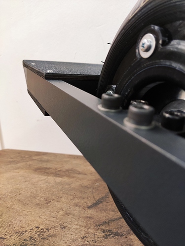

I just want to share my finished Onewheel.
It looks much nicer with some paint and it works flawless.

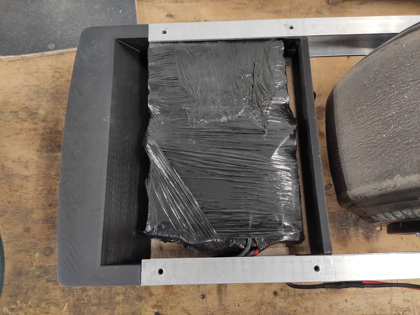

So the reason I’m here again is because I would like to make a bigger battery pack. I still use the stock battery, but I got my hands on 2 Hoverboard battery packs and I would like to fuse them together.
The only problem is that I don’t have a spark welder nor a balance charger and I don’t have much experience with building battery packs . On the internet, a lot of people don’t recommend using a soldering iron, but it’s possible.
What configuration do you advice? @Bionic24 made a dual 6S3P in series, but is this still the best option?

I am using 2 Hoverboard battery packs in parallel (10s4p). They are cheap and easy to get. Also, it is easy to connect them together just by soldering some cables and they last very long.
They do fit very well in my built. I don’t know if it will fit in yours.
First this was my idea too, but unfortunately it doesn’t fit in my board. It looked like a 6S3P has less height, so that one will probably fit. Anyway thank you for your commitment!
If you remove the blue shrinking tube, you can rearrange the cells without needing a spot welder.
Just two cables from the BMS need to be extended.
Otherwise there are some mini Spot welders on AliExpress for example. Using a soldering iron to connect the cells is pain in my opinion.
I would never solder cells. My advice would be to get a good spotwelder (I use a malectrics) or have someone to make a custom pack for you (probably cheapest for just one pack). I am going to build a pack with p42a cells for mine when upgrading to Vesc. Will try to fit a 12s3p
