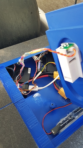

Velostat would be best but the hatch in the front with your switches is not very big. I had a problem with the griptape coming loose because my sensorpads where to big and left too little surface for the griptape to stick.
For now I made a bit of a hack with an old momentary switch underneath the hoverboard pushbutton. Not sure how to explain it best.
hmm I like that idea its simple and cheap just like this build :smiley: Mind sharing the STL? :slight_smile:
I don’t mind sharing, but it is really an amateur job made from basic shapes in 3d-builder. If you printed with PLA the parts will glue to the bottom of your pressureswitch plate with CA adhesive. The momentary switch that I took from an old FRSKY Taranis X9D slides in a bit tight.
switchholder.3mf (85.0 KB)
Sweet thanks! :slight_smile: Might do my own that screws in place but its a good start for inspiration
