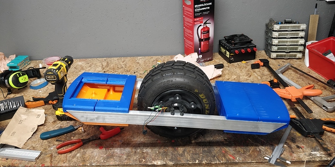

Yea I miss carving now that I built a Trampa that’s not carve friendly at all so this will be my fun 2nd board when riding in the city. Had some fitment issues with the big boxes as they warped a bit on my friends magnetic bed. If I cant get them to fit I will print new ones on my CR10S that I bought this past weekend. Just a huge upgrade from my Anet in every way.

Forgot that I dont have a BMS so ordered one but using it for charging only and will put on a meter to show the voltage. Don’t want to risk it switching of while riding lol had that happening with the hooverboard and it ain’t fun…

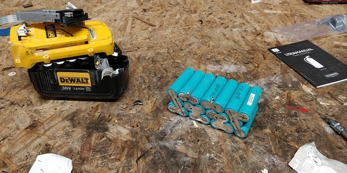

Got a few DeWalt 36v 4ah packs that I will use to build a pack.
Going to aim on a 12s4p but might not fit. Its 18650 Samsung 20R cells so not the best but they are free :joy: Will build with sanyo 20700B in the future if I want to keep this.
Looking sweet! You are almost there I see. I think 12S3P is the maximum you will be able to fit in the backside. For 4P you will need to put a small spacer in the battery compartment. Like they do on stretched limo’s.

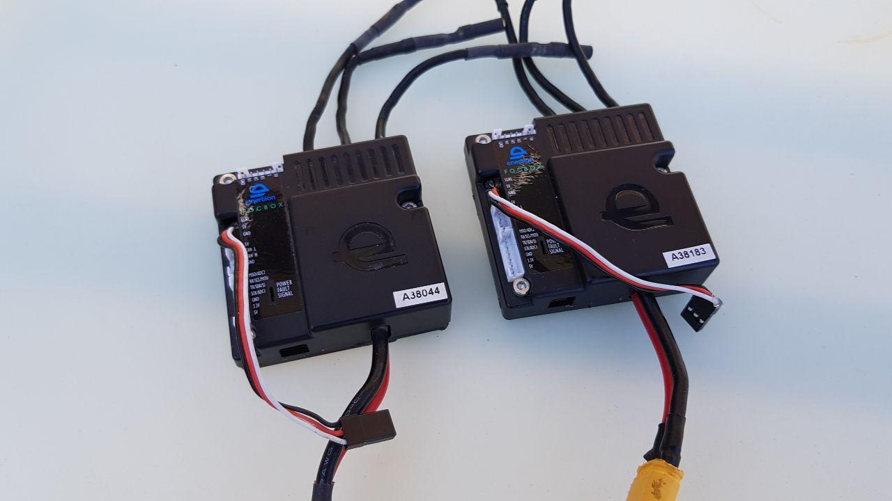

Yes, I am running it on a dual Focbox VESC setup right now. I will do a much needed update on the pros and the cons tonight…

So here is a long due update of my current board. I have exchanged the Hoverboards BLDC for a dual FOCbox setup running the latest VESC version 5 firmware.
Each motor is connected by its own set of hall sensor wires and the VESC are connected to each other with a Canbus cable so it acts like a master slave setup.
The master VESC is running the balance app and has an external IMU board. In my case it is the MPU6050 which can be bought at most electronic websites for a price ranging anywhere from 2$ to 8$.
FOCbox’es are not made anymore, but they seem to have a proven track record as reliable hardware and I purchased a mildly used set on this forum.

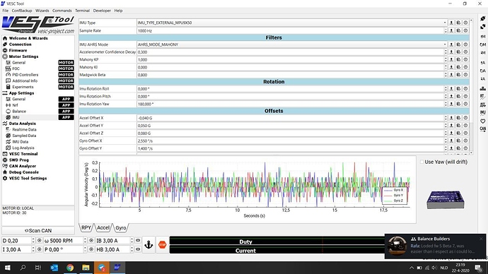

Initially the setup was really frustrating (and I am not frustrated quick). This being my first encounter with VESC firmware and not finding much references to similar builds made me feel like pioneering in the unknown and there is an endless amount of variables to overcome. At first I spend multiple days trying to find out why the motors where cogging up only to discover it is probably a piece of code from an old firmware that was not overwritten during the firmware update. Pressing the ‘load default motor settings’ on the right side in VESC tools application followed by ‘write motor configuration’ solved this issue.
After this the VESC motor setup is actually quite straight forward. I tested the motors while disassembled but I guess this could also be done while they are inside the hub as long as only 1 of the VESC is powered* to prevent them from working against eachother.
*Don’t (dis)connect the Canbus wire during use because it can damage the chip.
After setting up the motors it is time to look at the balance app. Once activated you can go to the IMU tab and select IMU_TYPE_EXTERNAL_MPU9X50 at IMU type, it uses the same library as the MPU6050. Mitch (@NuRxG) wrote a really cool IMU calibration wizard that calculates the gyro offsets automatically for you, just hold the sensor level and press start. In the Accelerometer graph at the bottom check if the value of X and Y are near zero and the value for Z at 1. ACC Z represents earths gravity and it is the only value you don’t want at 0.
In the balance tab you have options to set PID values, low voltage behaviors, tiltback / pushback, footsensor switches and a lot of other things that will make this story an instant ;tldr. If you get to this stage there are lots of knowledgeable people on this forum that can help out with your specific questions. Hopefully future releases of the firmware will include help text buttons explaining each function in layman’s terms but for now you will have to accept that you are exploring new grounds.
