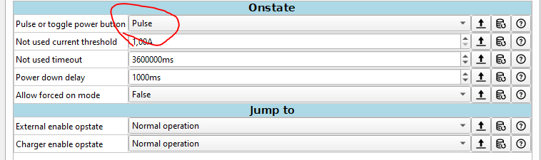

When I want to charge I always need to turn on the DBMS. Any Idea if I need to change settings?
Never had to fiddle with any settings for it to power up when a charger is input, I only use push to start tho, might have something to do with it
(Powering via button still works ofc, pulse might be a global variable applicable to more than the push to start and button is only button)
Just had a look at my settings and It is set to Pulse as well. Strange, not a big issue, just strange.
Ah well for now I’ll just manually turn on the board each time.

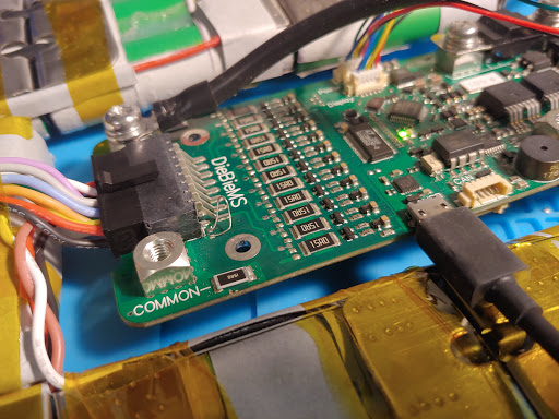

I have a DieBieMS from 2nd batch (@Samau18), V.0.8. Today was the first time hooking it up.
As I power it on, crossed battery is shown on the OLED. I think because default is 12S, I run 10S.
After downloading drivers, I was able to connect in DieBieMS-Tool V0.30 over USB (on both macOS and Windows). Firmware is 3.38.
But thats all… It seems, that I am unable to send any configurations to the BMS. I can’t read the settings and also not write. I tried writing configurations with M-arrow-down, followed by Floppy Disk button (is that how you are supposed to?). But the status bar shows no signs of uploading. While connected over USB, „Bye“ is written on the Display, one solid green LED is on, the other one green blinking. No change of this pattern after hitting upload button.
Does anyone have an idea what could help? Thanks!
I solved it.
Apparently, FW 3.38 doesn’t allow DieBieMS-Tool to read/write. After FW-update AND triggering the bootloader manually via terminal (as described in https://electric-skateboard.builders/t/diy-6s-to-12s-bms-with-can-diebiems/2639/415) it all works now.

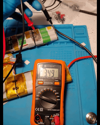

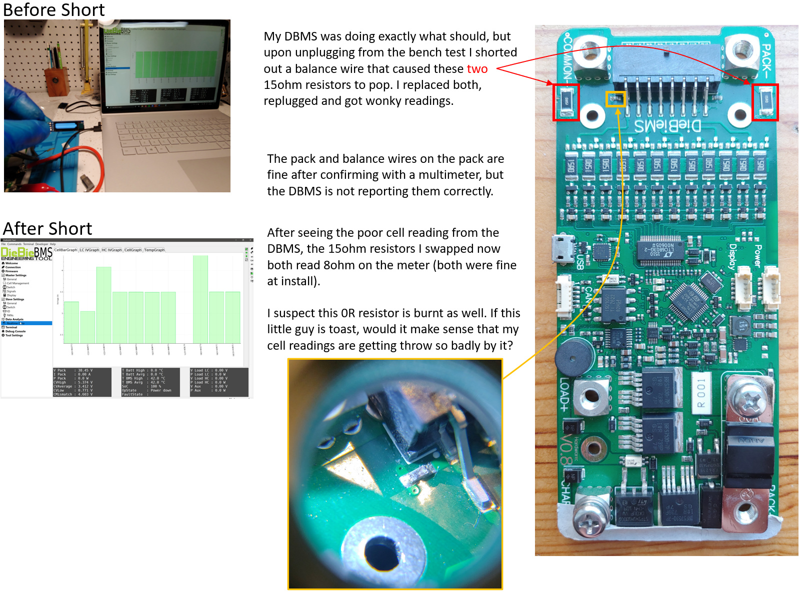

I recently shorted a balance wire in a bench test and damaged my DBMS, I’m hoping for some confirmation of what I think is wrong!
So I solder a bridge at the 0R location, and am getting better readings. But still not matching actual readings which are all ~3.50v for these four first groups.

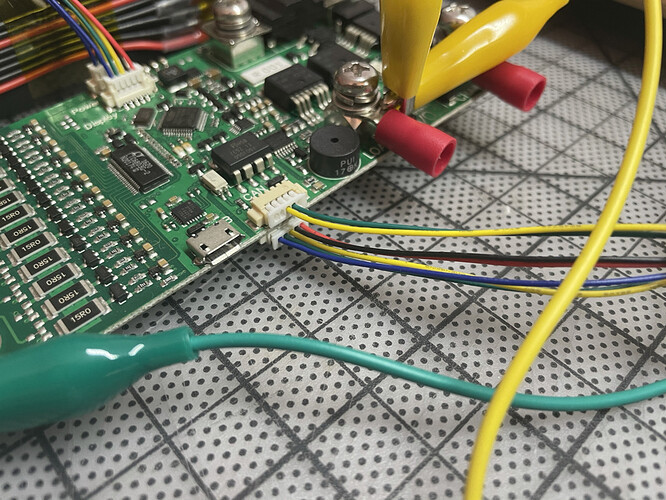

I am having trouble with the CAN bus on the DBMS. The VESCs plugged into the CAN connectors on the DBMS have no problem communicating, but the BMS does not show up in VESC Tool or on my Metr app (set to autodetect the DBMS). All devices are set to 500kbit/s throughput and VESC CAN style. Do I need to have “Emit stus over CAN” turned on? (it’s labeled as not implemented yet)
I am beginning to think I fried the CAN bus IC, but can’t pinpoint when it would have happened. Any tips to see if the ISO1050 CAN bus IC is alive?

Can the VESC’s see each other?
Do you perhaps have a multi meter and can you check whether there is power on the isolated side of the ISO1050? ( PIN 5 and 8 ) (should be within 250mV of 5V, she is very strict):
With the ISO1050 you can also beep out whether the can wires connect everywhere, so all CAN Highs should be connected to each other and all CAN Lows.
Danny, thanks for your response.
The VESCs have no issue seeing each other and the CAN highs and lows connect.
Between pin 1 and 4 I am seeing 3.25V
Between pin 5 and 8 I am seeing a floating value less than 100mV (it appears to slowly go up if I keep my meter on it)
Should I be seeing 5V on pin 1 and 5? Thanks for your help. Been sitting on this DBMS for a bit and am excited to finally be finishing up my board. I have no problem swapping out the ISO1050 if that appears to be the problem.
Yes with the minus of the multi meter on pin 5 and the positive on pin 8 you should see 5V. When this is absent the BMS cannot see the communication and cannot participate on the bus. Since the voltage should come from a VESC can you check whether it is present on the source VESC (between the GND and 5V of the source vesc)?
