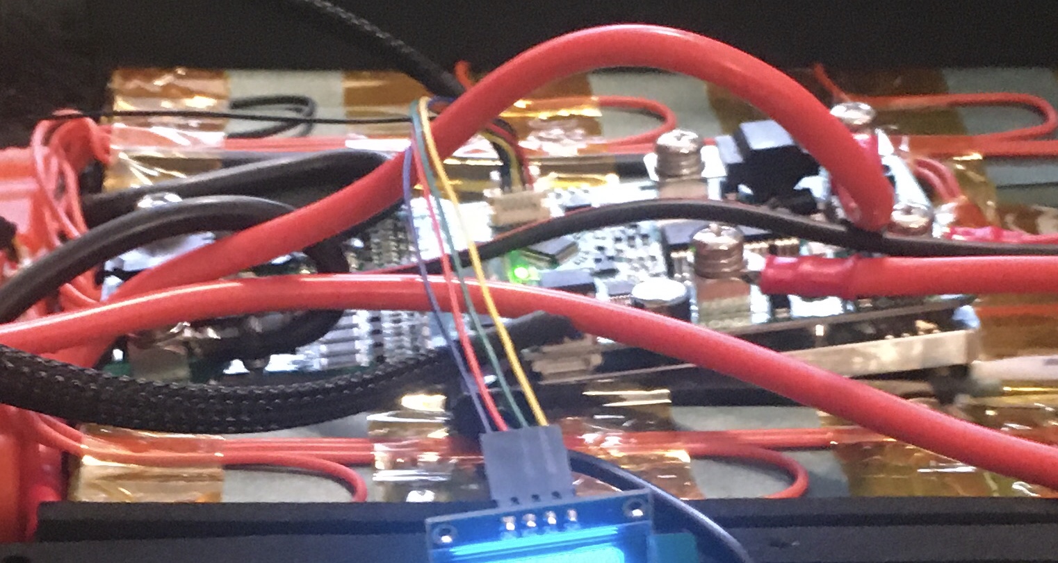

Just did it with some dupon. nothing battry at 35v as it’s never been charged
Iv not connected a load yet as I wanted to set it up first.
Starting to think there’s a issue with the PCB
Wired up a 2nd board and the green LED in the middle of the board stays on so faulty board is the issue nothing to do with me
The screen is helpful as it shows you messages as to why the board isnt working

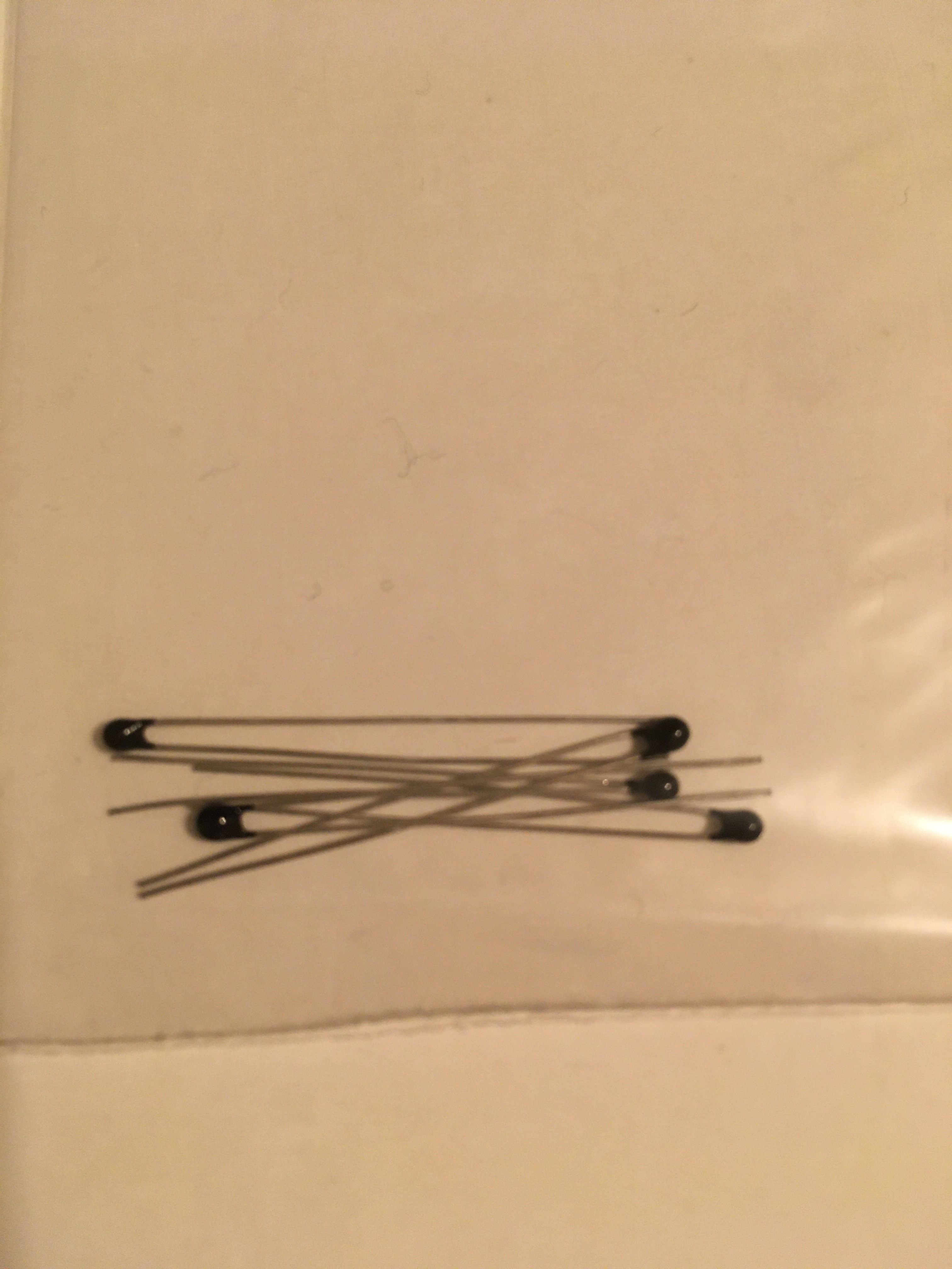

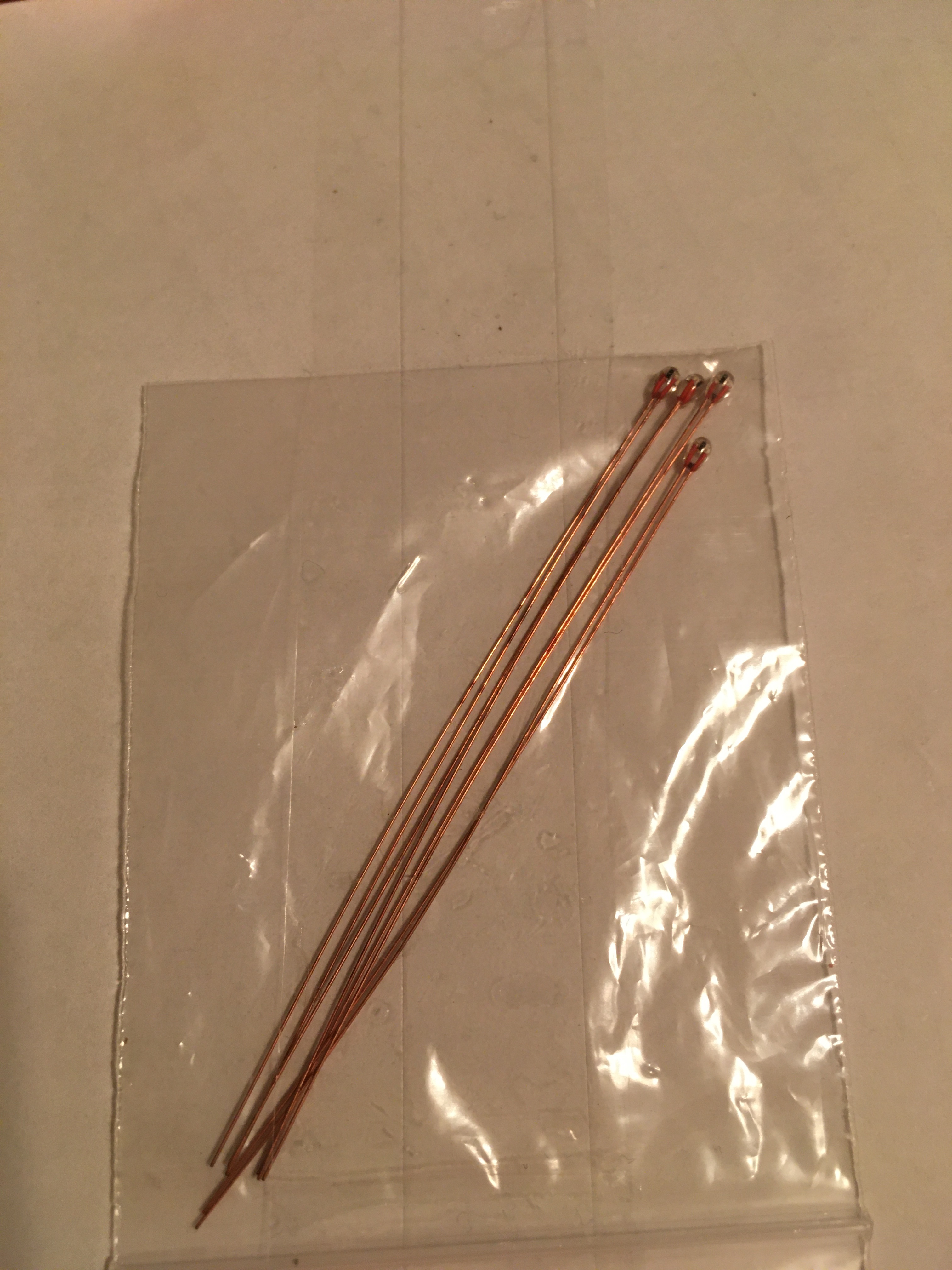

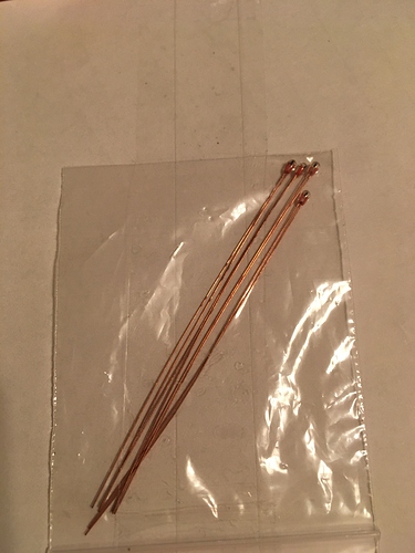

So I was thinking about putting a couple of temp sensors on the battery and picked up 2 difrent types on eBay.
Can any one tell me any pros or cons to the ones to the thermistors below? @janpom @SimosMCmuffin @rpasichnyk @Ricco
100K Ohm Thermistor Resistor MF52 B NTC-MF52AT NTC MF52E
R@25: K100K-1%
B25/50: K3950-1%
Model: B2-100-3950
Thermistor type: MJB
(Single-ended type glass bead closure)

No. What lights do you have on the DieBieMS I had a faulty unit that no lights came on
One light and a second light breefly when powering on. The Vecs also turns on. So I don’t think the BMS is faulty.
It was the USB cable… :upside_down_face:
