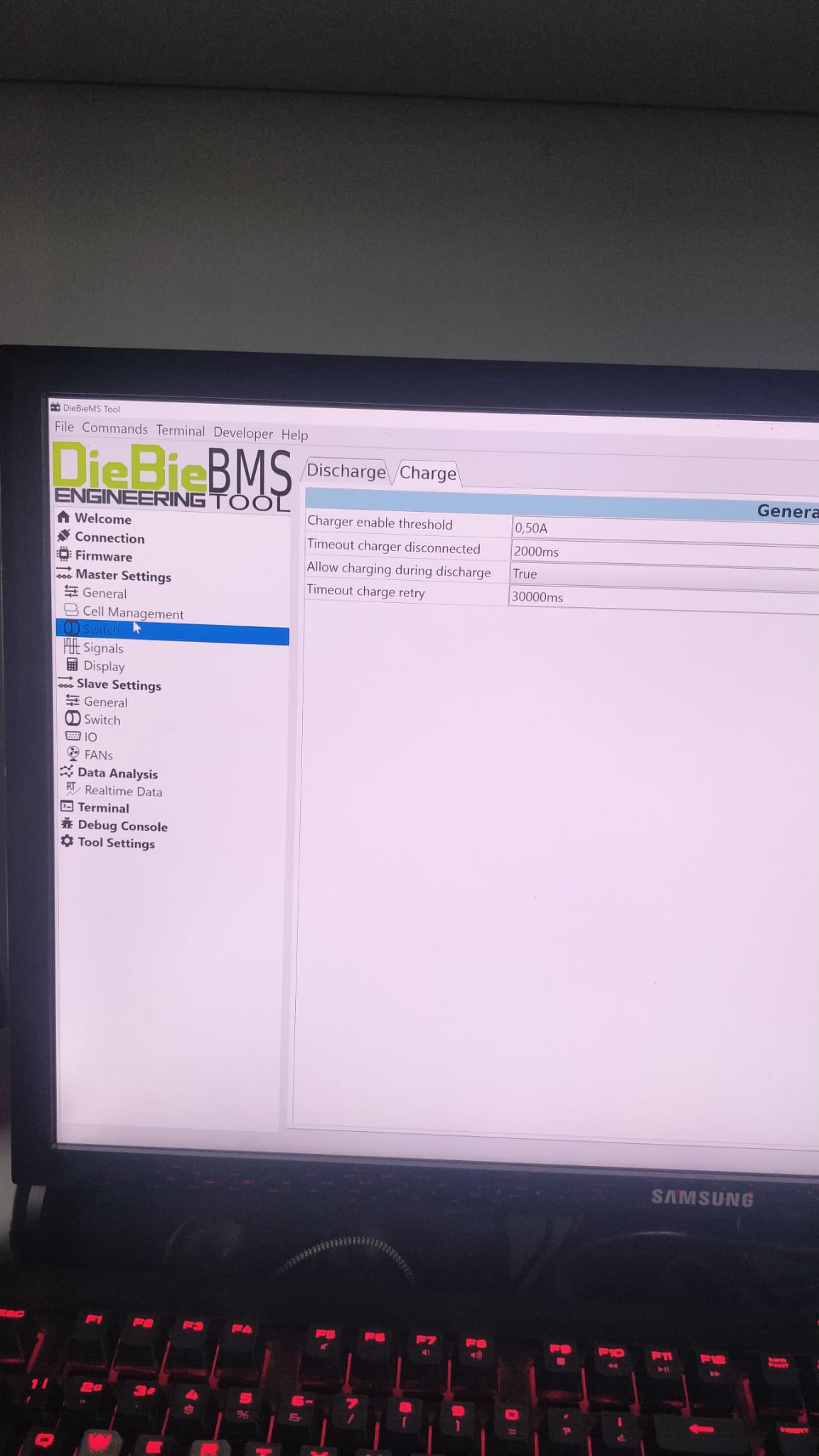

If you set hysteresis/voltage diff too narrow in the settings, the diebiems might trigger errors.
Think preset is like 5 errors until it stops working entirely. If you have one drifting Pgroup and your treshold for this setting is in the millivoltrange you’ll likely experience this. Usually happens during load and the weak pgroup dips slightly more than the others.

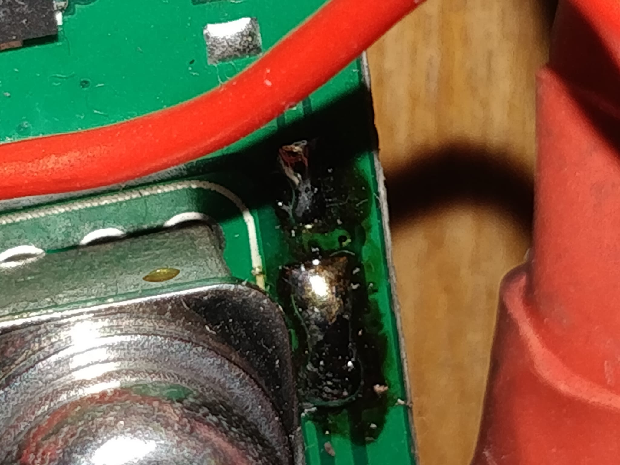

I will dm him if the problem persists. There is some userful information, but im no good with electronics, i can identify burned shit, which my bms has none, but i dont have a voltimeter. the only weird thing i found was this:
There should be two resistors therre, and i dont have them. ( it is not burn marks, just flux)
Here you can see the resistor im talking about.

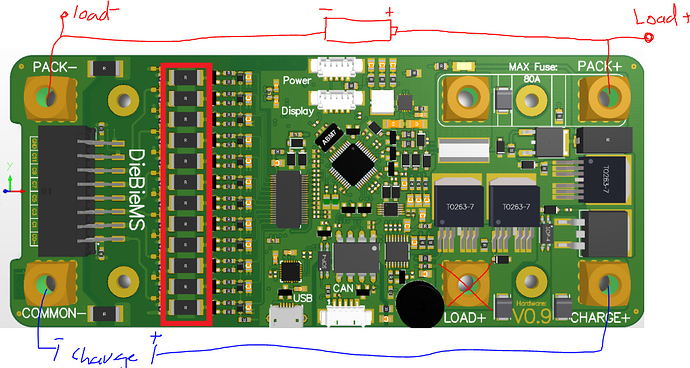

Well, ended up not doing the test due to bad weather and lots fo work. But turns out i didnt bypass the bms corrrectly. I have connected my vesc to the pack+, and pack- of the diebiems, leaving the load+ unplugged from everything, and the common - connected to just the charge port- ( the charger+ its on the charge+ port) Can someone explain to me what im doing wrong? Should i connect the vesc to the common-?
I havn’t bypassed the BMS, since part of the purpose is to be able to handle the current, all those pricey components need to do thier job if you ask me.
But in theory you would just have the BMS in parallell to the battery plus and minus. I take it you still charge via charge port tho? as in its bypass in discharge but not in charge? Doubt it will balance if you dont.
(Common- and pack- is the same electrical connection on the PCB(GND))
I have bypassed it because I really can’t bother to troubleshoot why the f the bms cuts my current. Ive been thinking of selling the diebiems and buying a simpler one, I simply don’t have time to troubleshoot.
For some reason, the bms doesn’t charge my battery in that configuration, the lights of it doesn’t turn on and the light of the charger doesn’t indicate that it’s charging. I don’t know what to do anymore :confounded:
Edit: Yes I want to charge thought the charge port, so the bms balances my pgroups. Just want to bypass on the discharge.

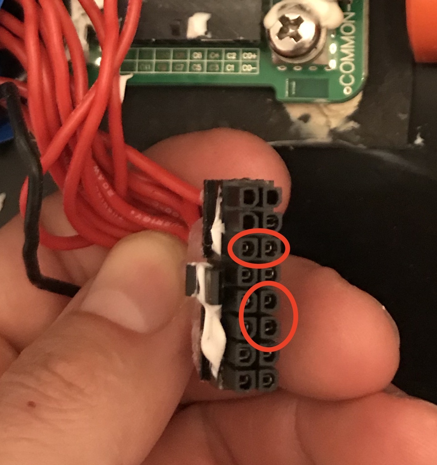

I had cutouts with DieBieMS but the reason for that was really simple, bad connection of balance cable. On the picture you can see some pins sit really deep and making bad contact.
I had to crimp all the balance leads again, also after plugging the connector I applied a bit of silicone around it to protect from vibrations.
I will have to check them then, Thanks for the advice!!

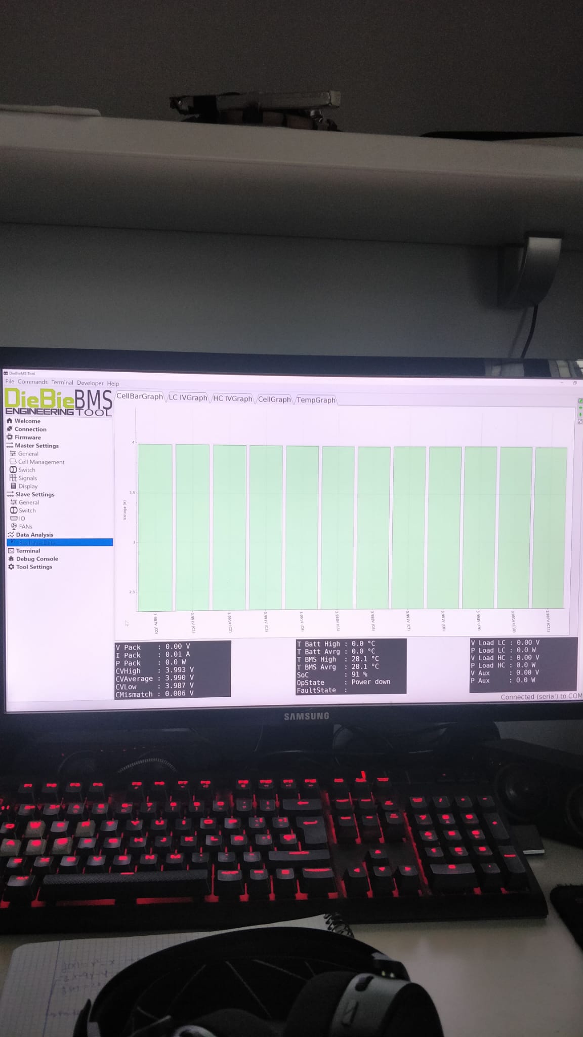

Okay, followed your instructions and got to the computer. As i said earlier when i connect the charger, no ligths turn on on the bms. i waited 20 secs and proceded to plug the bms to the computer, activated rt data and saw nothing special, smal voltage variation but nothing interesting, my pgroup voltage reads at 4v wich equals to the battery being 48v right now. I will take a short video so you can see the voltage variation with the charger versus without the charger.
After tacking the videos i realized the bms reads 49.2 volts and i dont know why.
Also, i later connected thee bms without the charger and the v pack reads 0 even though my rt data its on.
Charger connected b4 computer rtdata
Charger unplugged during rtdata
BMS settings
