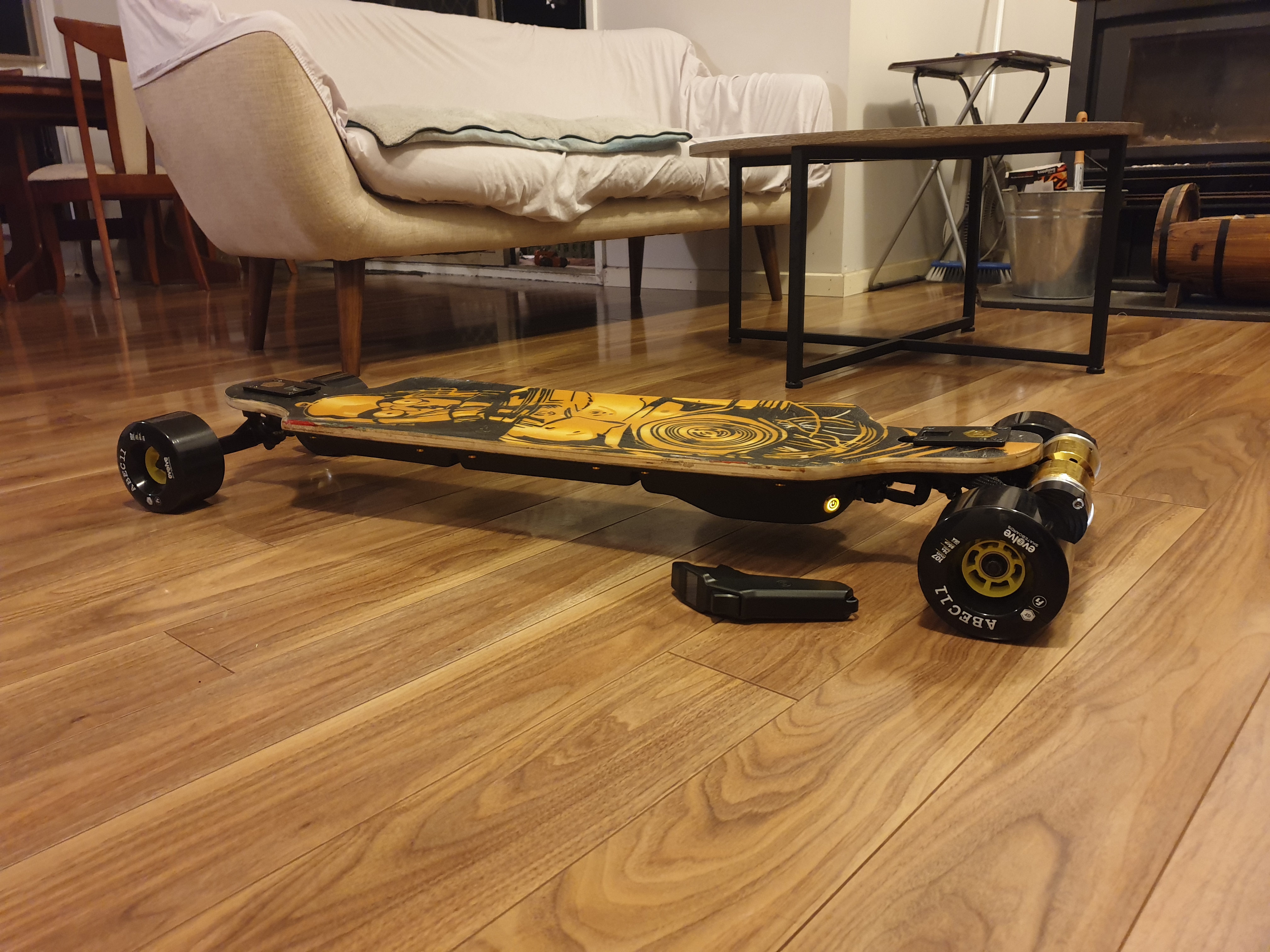

It’s been a long road! Started this build about 5 months ago and have learned a heap along the way!
Originally just wanted to replace the battery, but in my nature wanted to make a bigger and better battery. The dream was for a 10s6p, but was very difficult to fit in a single stack with flexible enclosure. I landed on 10s5p 30q.

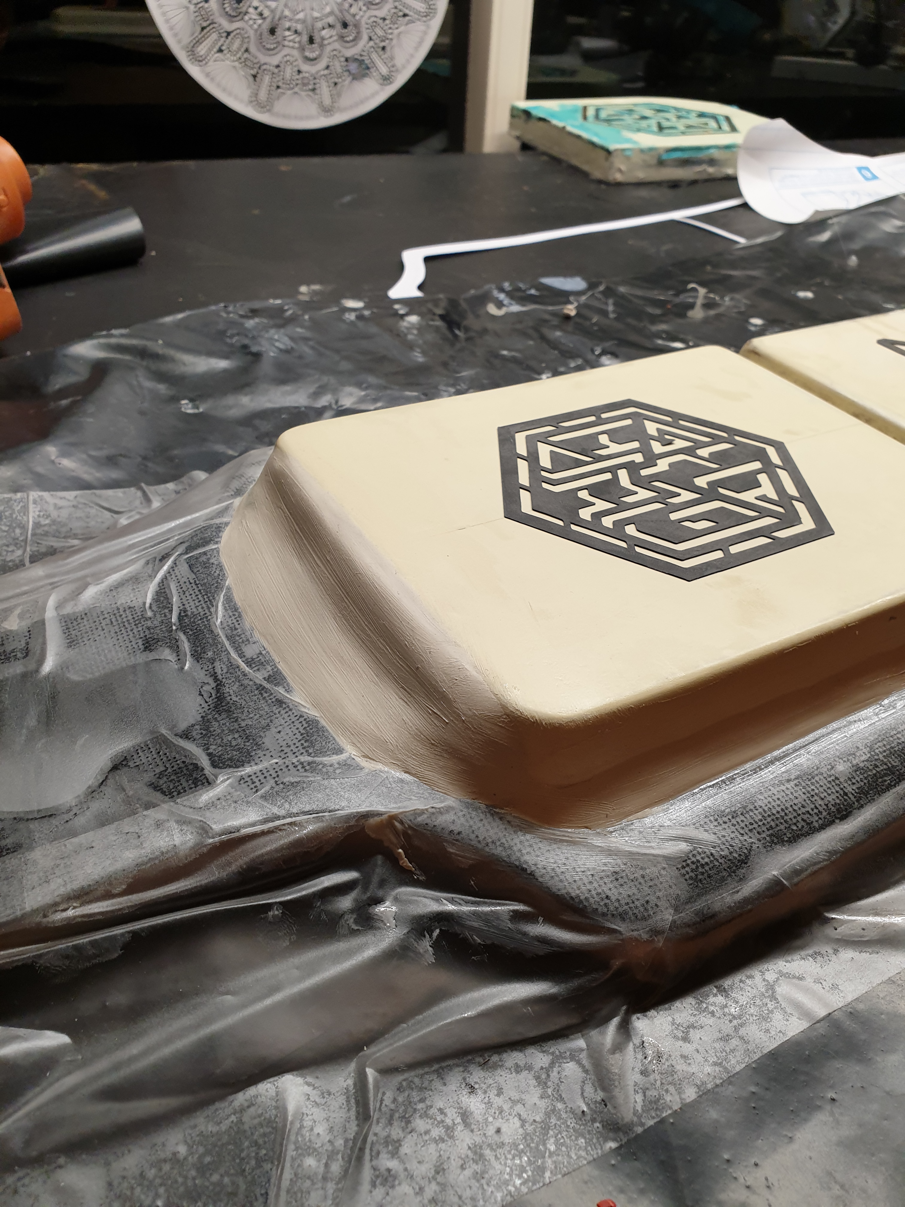

The enclosure is a story unto itself, several tries and fails and only just managed to pull off the final version but destroyed the mold in the process. I heavily routed the deck (which is far too flexy and now needs additional reinforcement) and made a fibreglass enclosure from scratch.

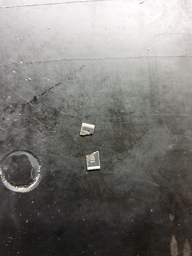

I put that one aside and got the new one out and managed to short it and blow a resistor. Good thing I had a spare parts board :rofl:
I used the Flipsky Dual 6.6 as I got it cheap from a local dude who abandoned his build. It works, but its annoying that it doeant have a CAN port to connect the BMS to.
Also got a metr pro in there and I’m using the Maytech R2 style remote.

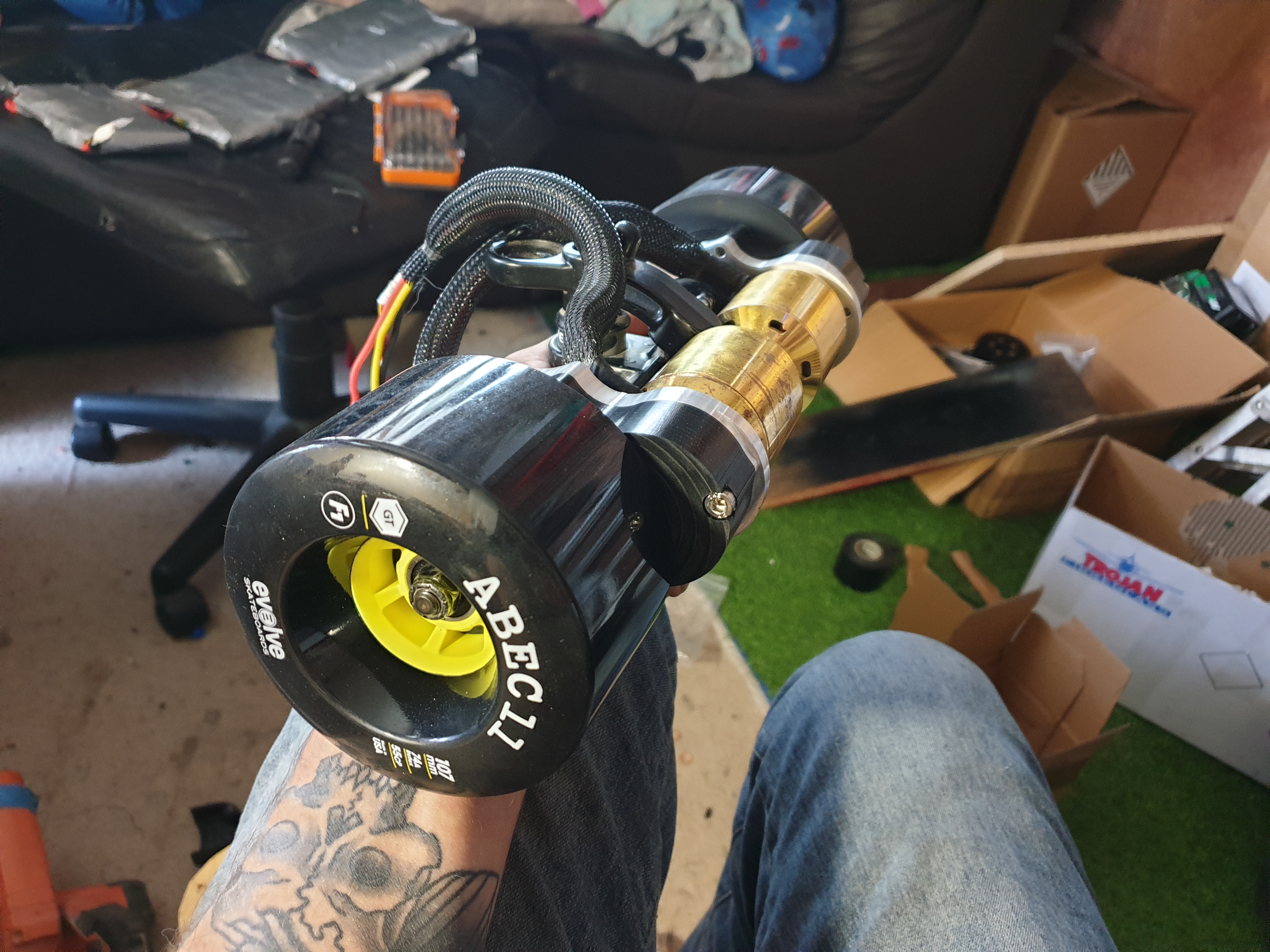

Edit: oops! Almost forgot the killer gear drive from Idea! Required a little modding to the truck but it looks awesome!

Yooo how did you get your longboard so nice? Is it glass frit?
So I still havent gotten around to doing the glass frit :sweat_smile: will get it done while reinforcing the deck. Texture on the skin is a happy accident from inexperience :joy:

Really like the gold accents and the C3PO, starwars ftw. The geardrive looks awesome aswell :relieved:
Looks fantastic bro. I followed the enclosure build and decided fuck that. Thanks for helping me not waste my time. Get some cf on the deck and you’re good to go and obviously it will be faster than anything else because gold motors. :stuck_out_tongue_winking_eye:

Those mods you made to the evolve trucks… that req’d to make those gear drives fit? Hacking part of the motor mounts off?
What fabric is the print on?
The cut on the trucks is for clearance so you can adjust the motor forward for the preload on the gears.
I have the same gear drive from @IDEA.
Thanks. Guess I’ll have to pick up a few wheels fie my dremel.
Another question… are these gear drives reversible?
Yeah you could probably run them facing forward if the holes in the mounting plate line up well enough. The holes o the drive are slotted for a bit of adjustment

Lol i thought I cut it pretty cleanly, barely a hack job!

Nah bro… not calling your work a hack job. It is clean indeed. Just the fact that we have to cut the mounts. Not a big deal and I’ve already ordered my set haha
