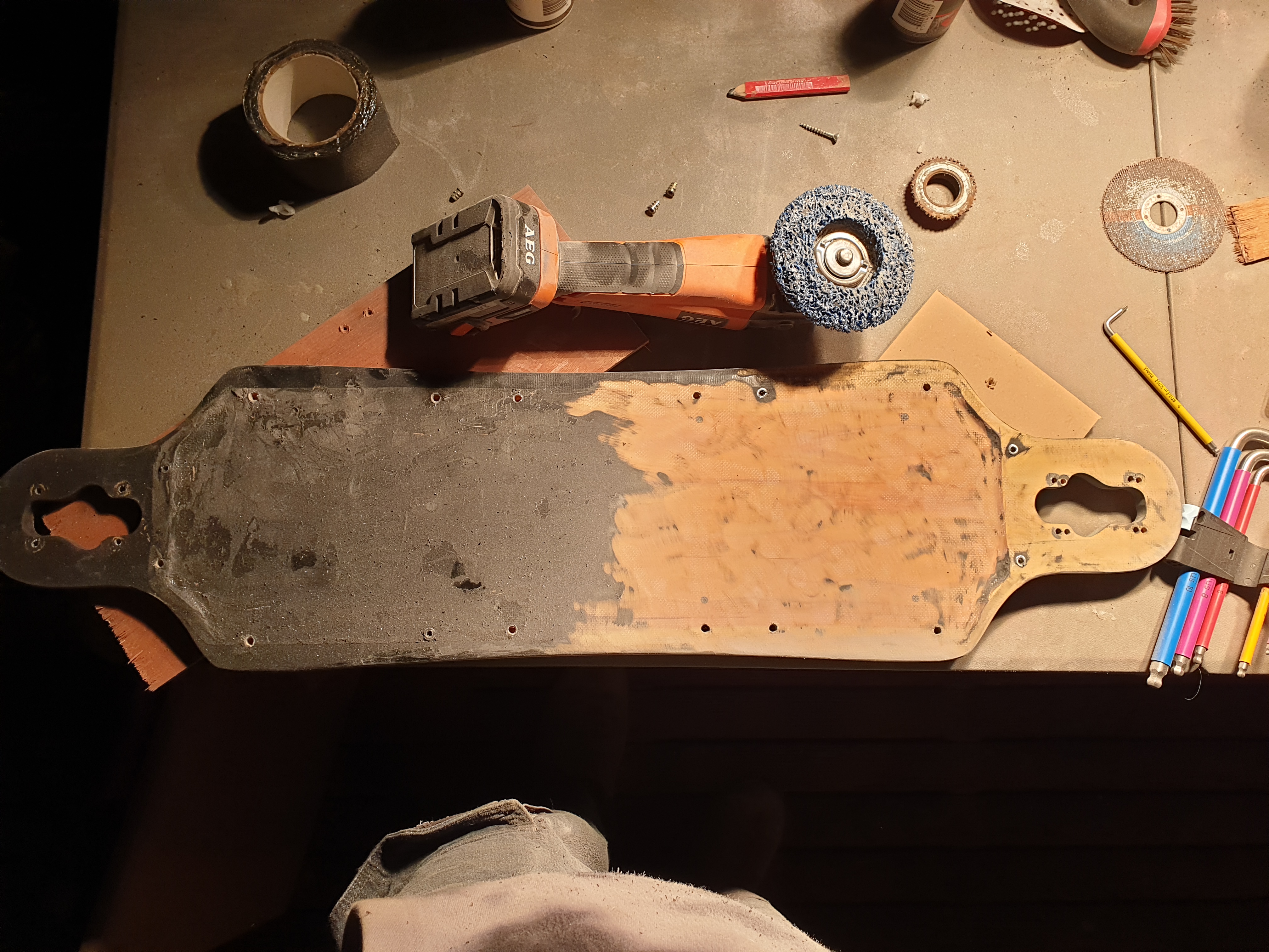

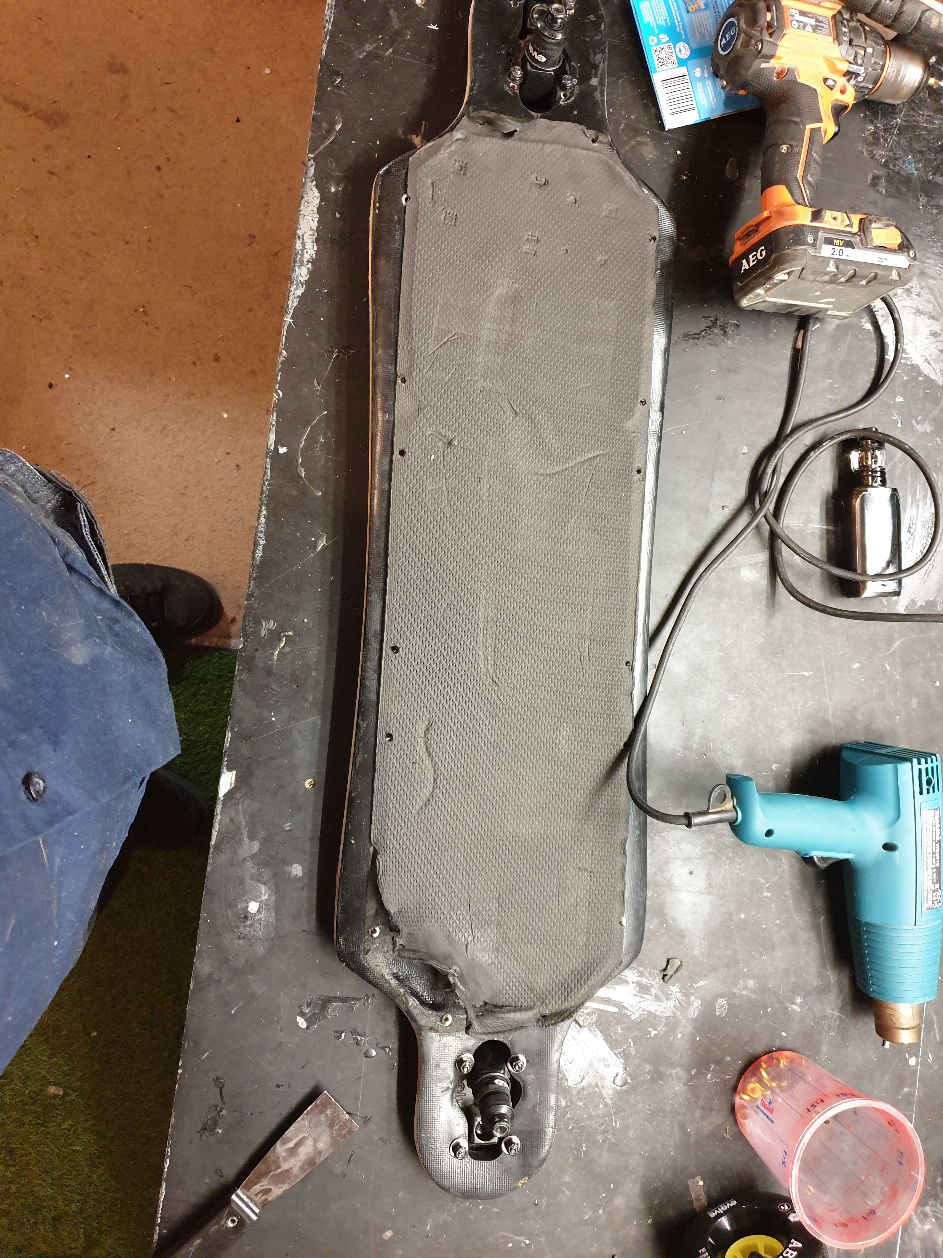

And here is the deck :sleepy:
Its gonna be a mongrel to get that foam adhesive off.

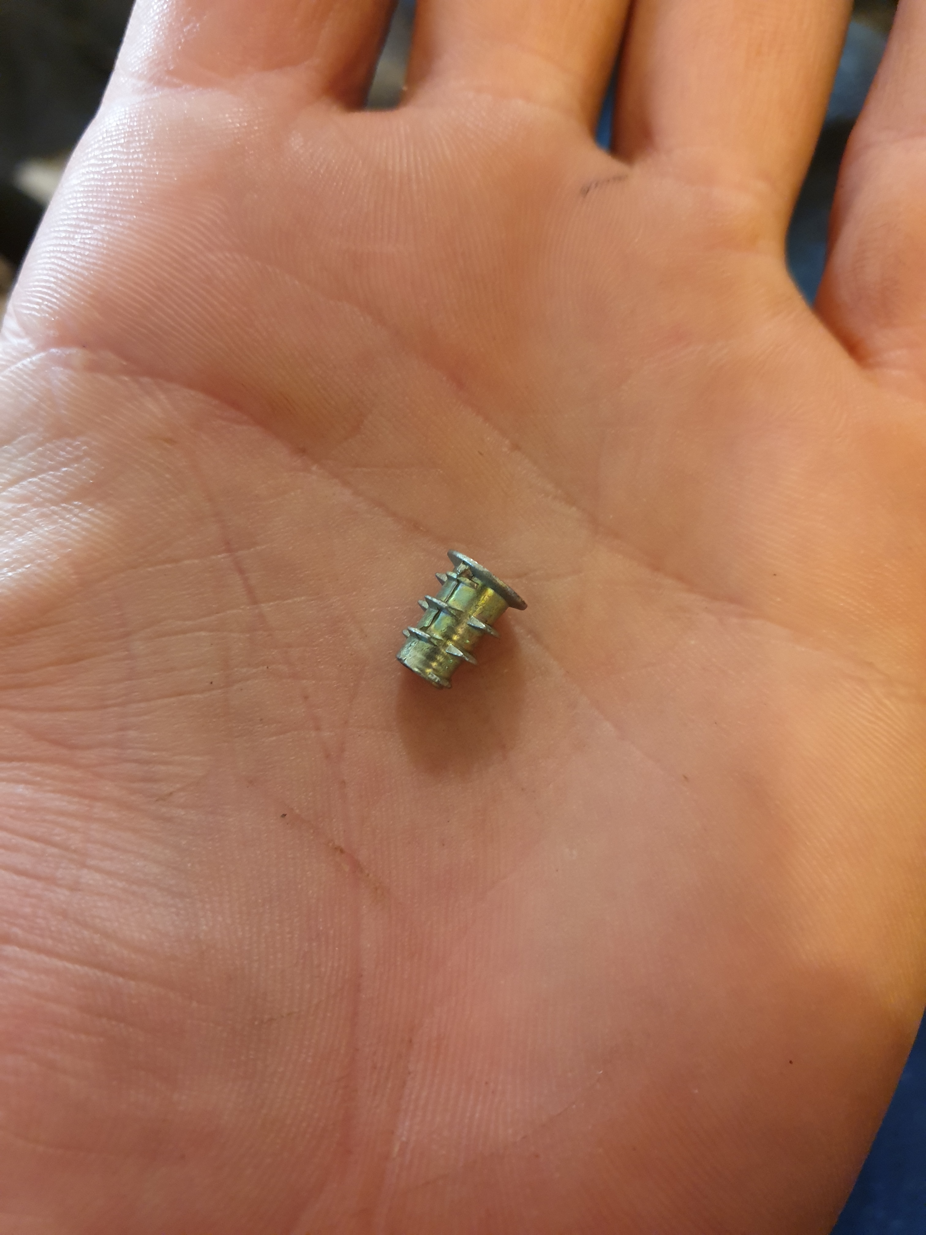

Any hot tips on how to retain the threaded inserts to be used again after skinning? @Sender ?

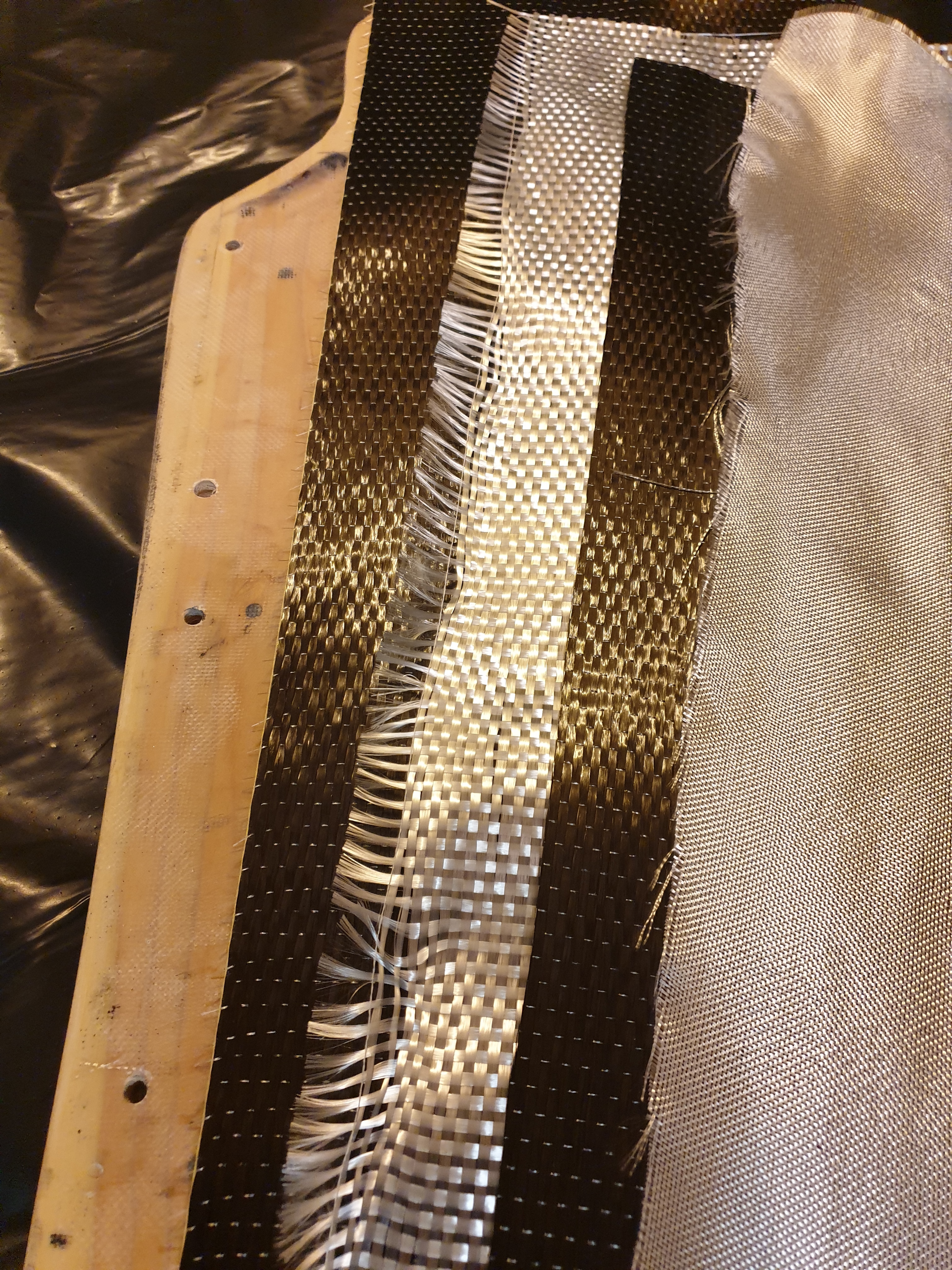

You spinning the bottom to reduce flex?
@Sender Yep, gonna do at least a couple of layers of carbon, its super flexy.
I doubt they are gonna be salvageable without great pains. Are they easy at all to remove? Can’t quite tell the type in the picture
These ones. Didnt glue them in, but did strip one of the hex bits :rofl: i think I will try to remove them :sleepy:
:sob::sob::sob:
Was going to say drilling those inserts out is the only way if they strip which 5 out of 10 will do because they like to fuck you. Looks like you worked that one out for yourself. Lucky for you no epoxy or you would be sourcing great big inserts right now for the huge holes in the deck or filling them in and starting again. Good job.
There will be filling :rofl:

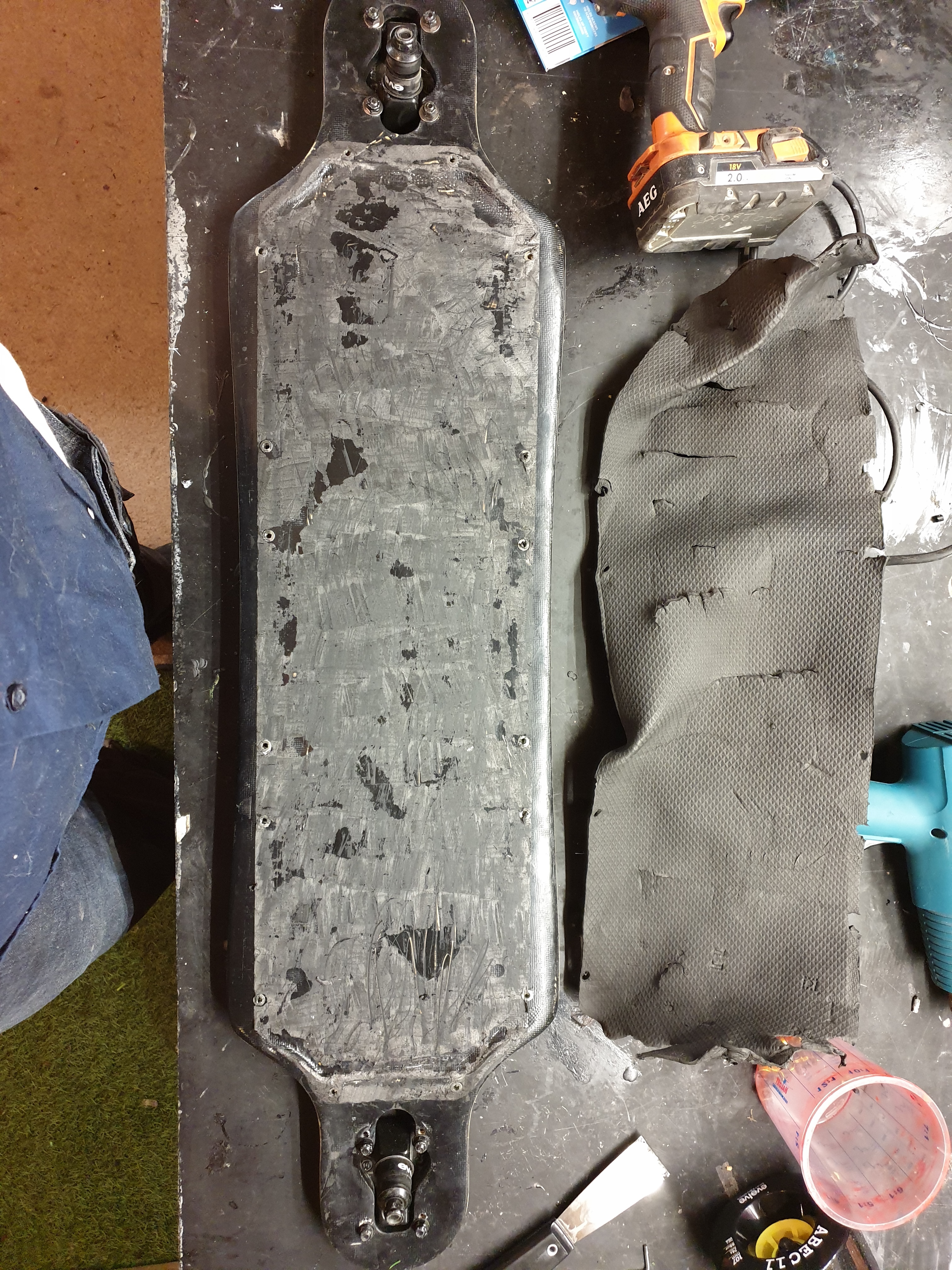

The stiffening begins.

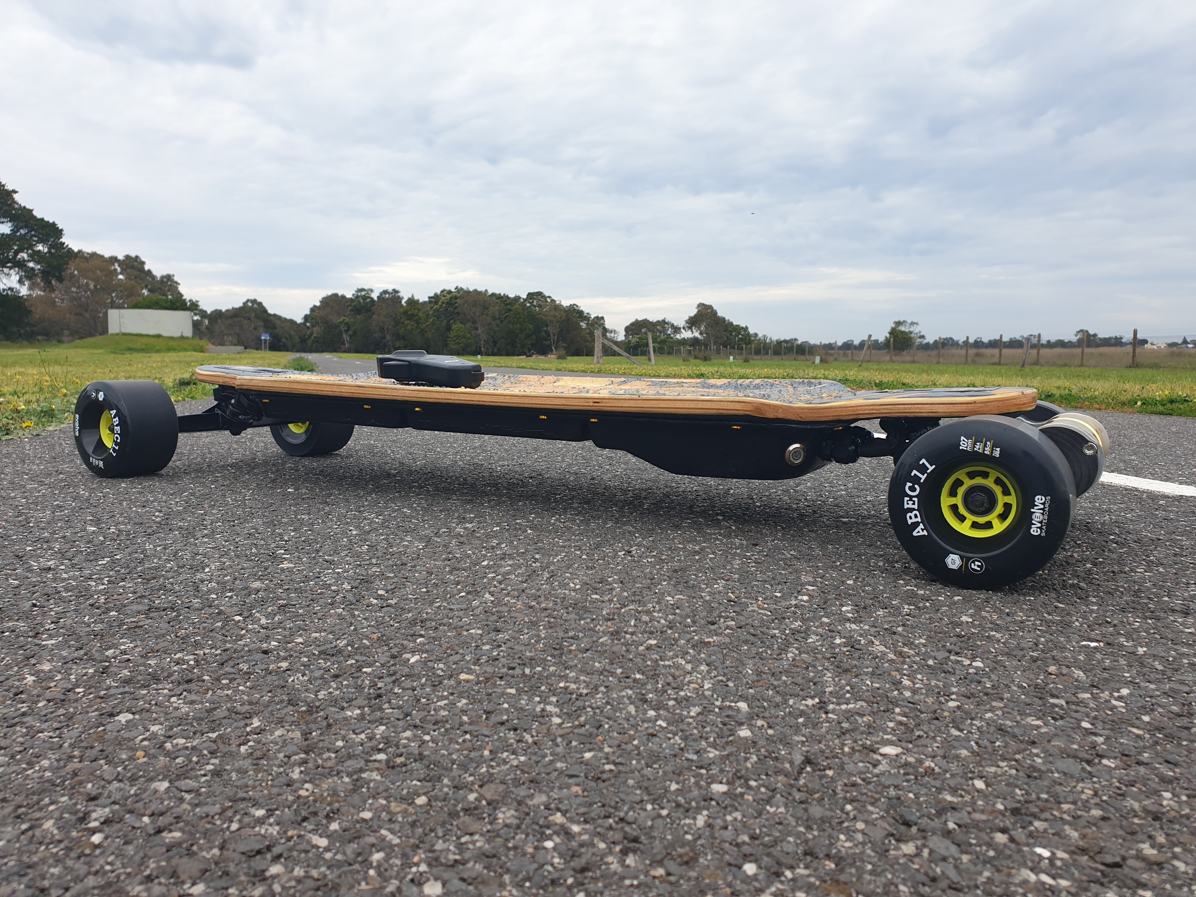

So i got the board stiffened no dramas and got the enclosure back on.
Maiden voyage was going great until one side of the ESC just shit itself after about 3km :sob: it was the side that the METR is connected too also so i lost connection with that to be able to try and change anything :man_facepalming:
Opened it up, the whole side of the vesc seems to be not working, but the metr was still receiving power, just not talking. Cos of the way its all put together in there, im gonna need to pull all the guts apart :man_facepalming:
Worst case scenario, i have 2 single flipskys i can replace the dual with, and i might swap out the diebiems for a small charge only bms while im in there.
Darn, hope you get it fixed soon and get back to riding! The first 3km must have been exhilarating
Cheers mate! Ive got everything i need to get it back on the road… everything except time :sweat_smile:
To be perfectly honest, the ride wasnt that thrilling :rofl: ive pretty much been exclusively riding high power boards for the past few months… the esc settings with the 2:1 ratio of the drive and stock evolve motors left me with quite a mellow ride :rofl: but it was definitely ab awesome feeling rolling down that path on my very first build!
