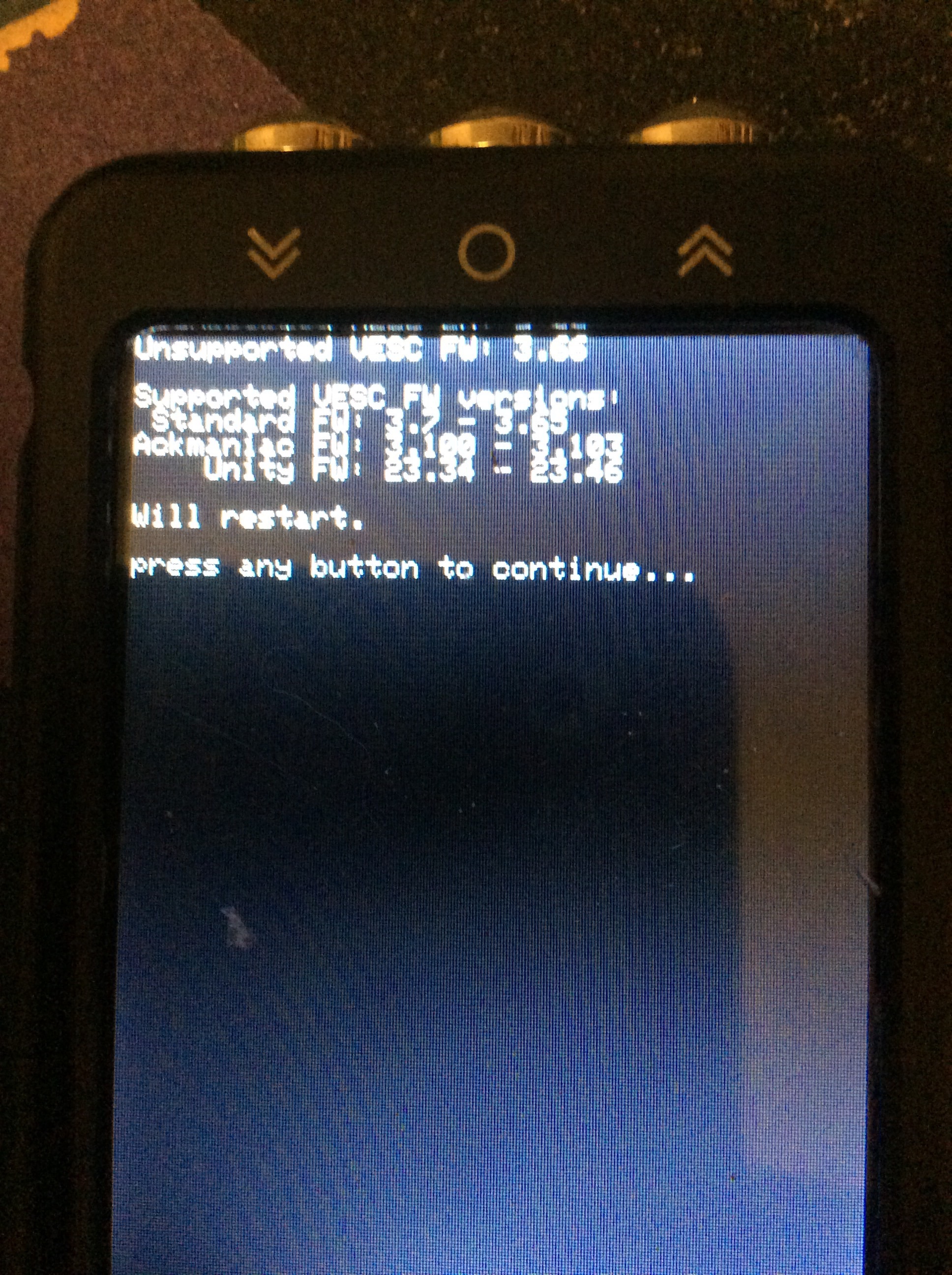

Got the new firmware Andy now I get this message
@janpom
Support for VESCs up to FW v3.67 added in v2.0.1.
Do I have to connect to a computer to get that firmware or will it come under updates
Can be installed over WiFi. You need to hold the middle button while booting up to prevent the error.
So for some reason when I try going on settings it just comes up with a bunch of errors even when I go down to an old version of the firmware
I need more details. You shouldn’t go back to a v1.x firmware. That won’t work with the bootloader v2.0. The major versions must agree as explained above. Please switch to the FW v2.0.0 and send the error you’re getting.

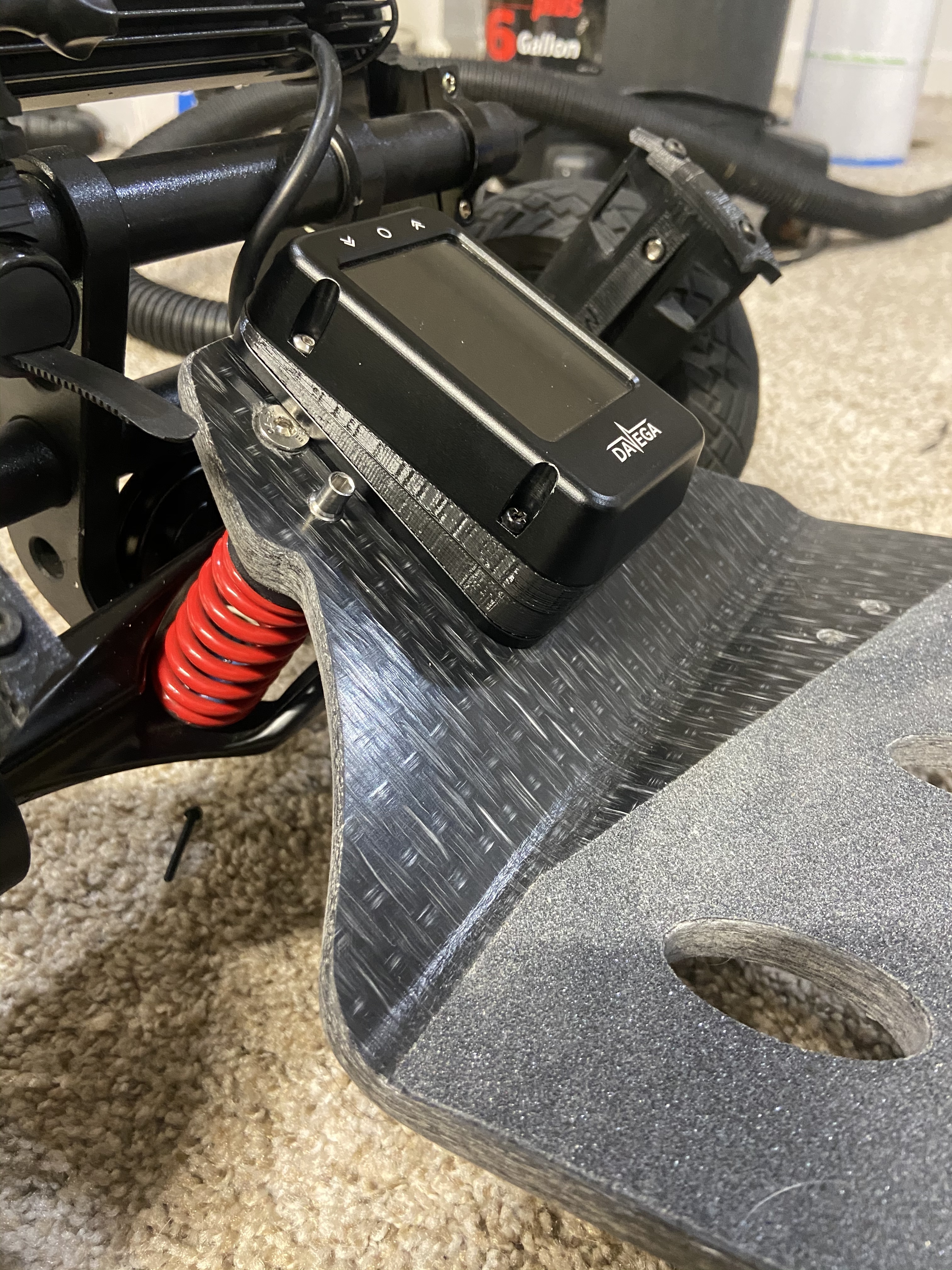

Finally got around to installing the wedges @annihil8ted printed for me. They look great. I think this will make the screen a lot easier to just glance at.
Yah I wedged mine just a few degrees and it’s a lot better. Yours looks like it has more wedge which should be even better
Yea I stacked two. But finding m3 screws tgat worked sucked. :rofl:

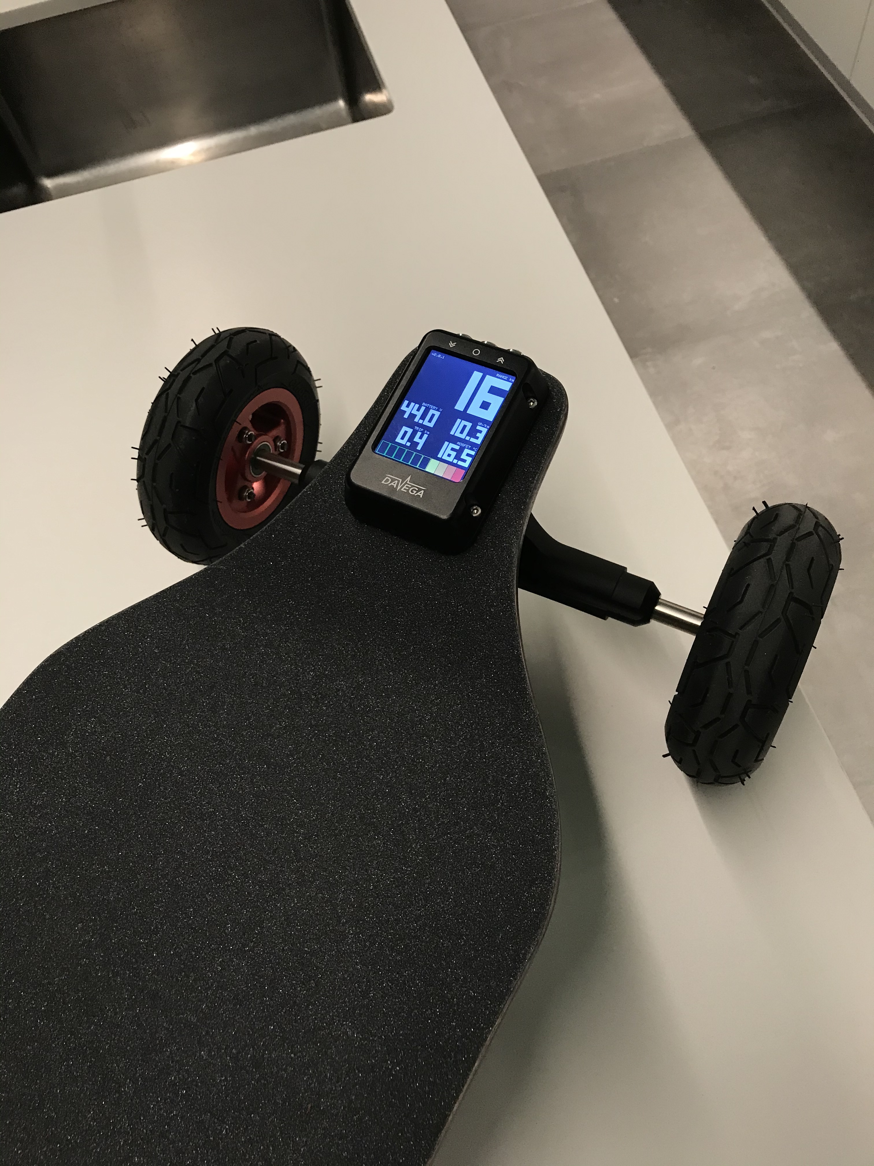

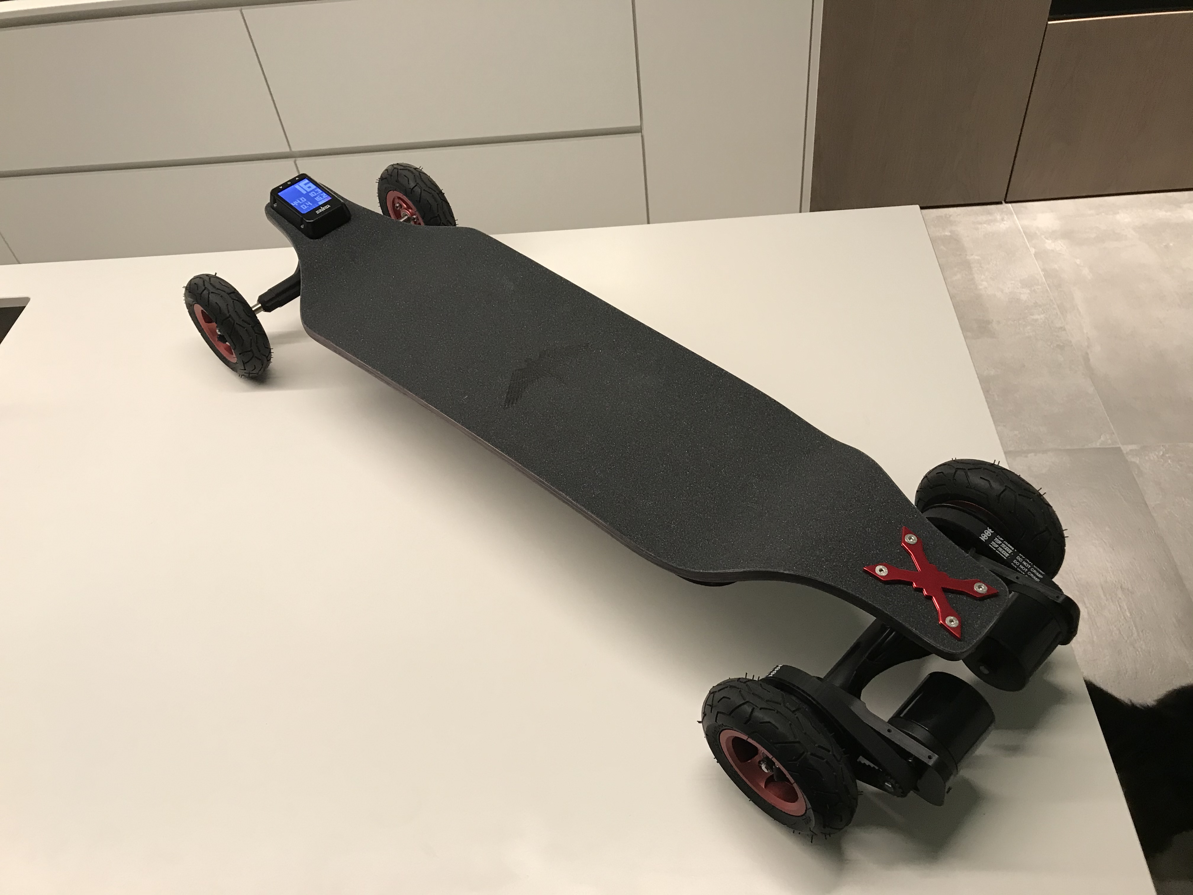

Finished my board yesterday. The Davega X is super on it!! @janpom Thanks for developing this for us!
