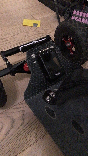

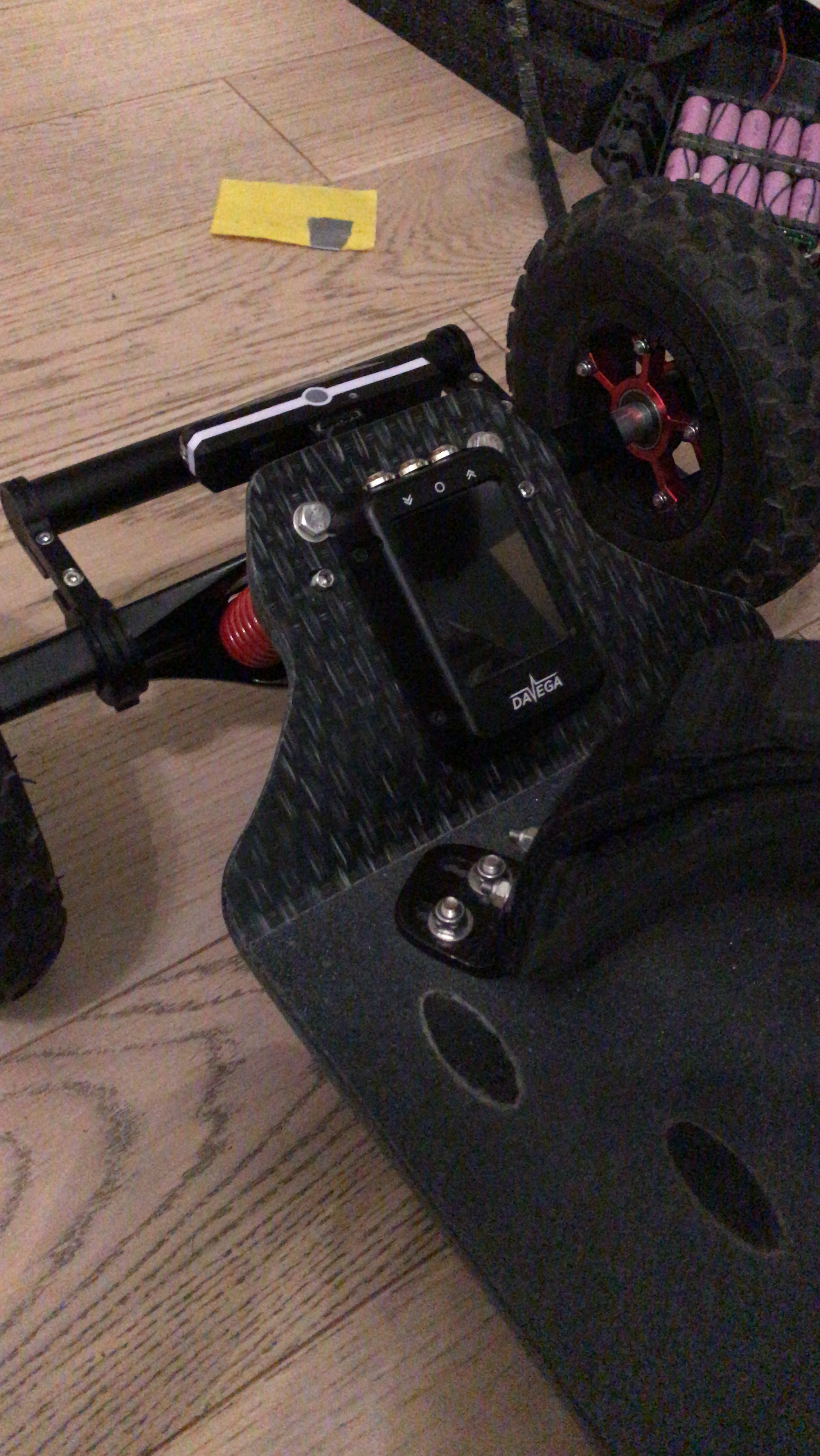

I finally installed DAVEGA on my Tayto deck. I didn’t think the portrait layout would work but I wanted to give it a try before going for the landscape. I was worried it would take off too much of the deck’s real estate and won’t allow for comfortable stance. It’s actually really good though. I won’t be changing to landscape. I put my right foot right behind the housing and it doubles as a foot stop. I’m actually more comfortable on the deck now than without the DAVEGA since the foot stop makes a lot of a difference.
We had a lovely winter day today. Temperature slightly below zero but a lot of sunshine and mostly dry roads. I put on my snowboarding helmet and had a great ride. :slight_smile:

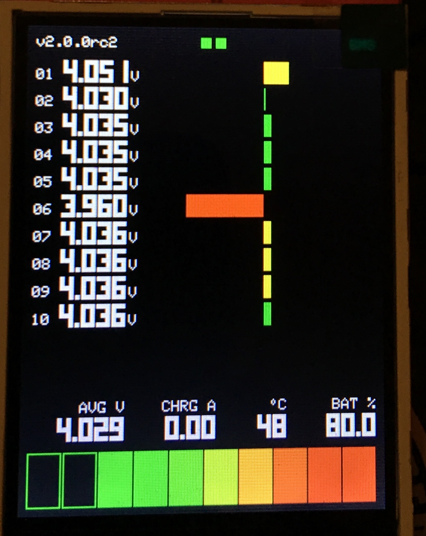

I’m about to release the bootloader v2.0 that will allow using FW v2.x.x. The main feature is the support for DieBieMS and FlexiBMS (in progress; mainly FlexiBMS side). Other than that, there’s a few small things, better memory management (fewer memory errors) and some bug fixes.
The firmware v2.0.0rc3 is already available. Please don’t install before updating the bootloader though, i.e. don’t install it yet.

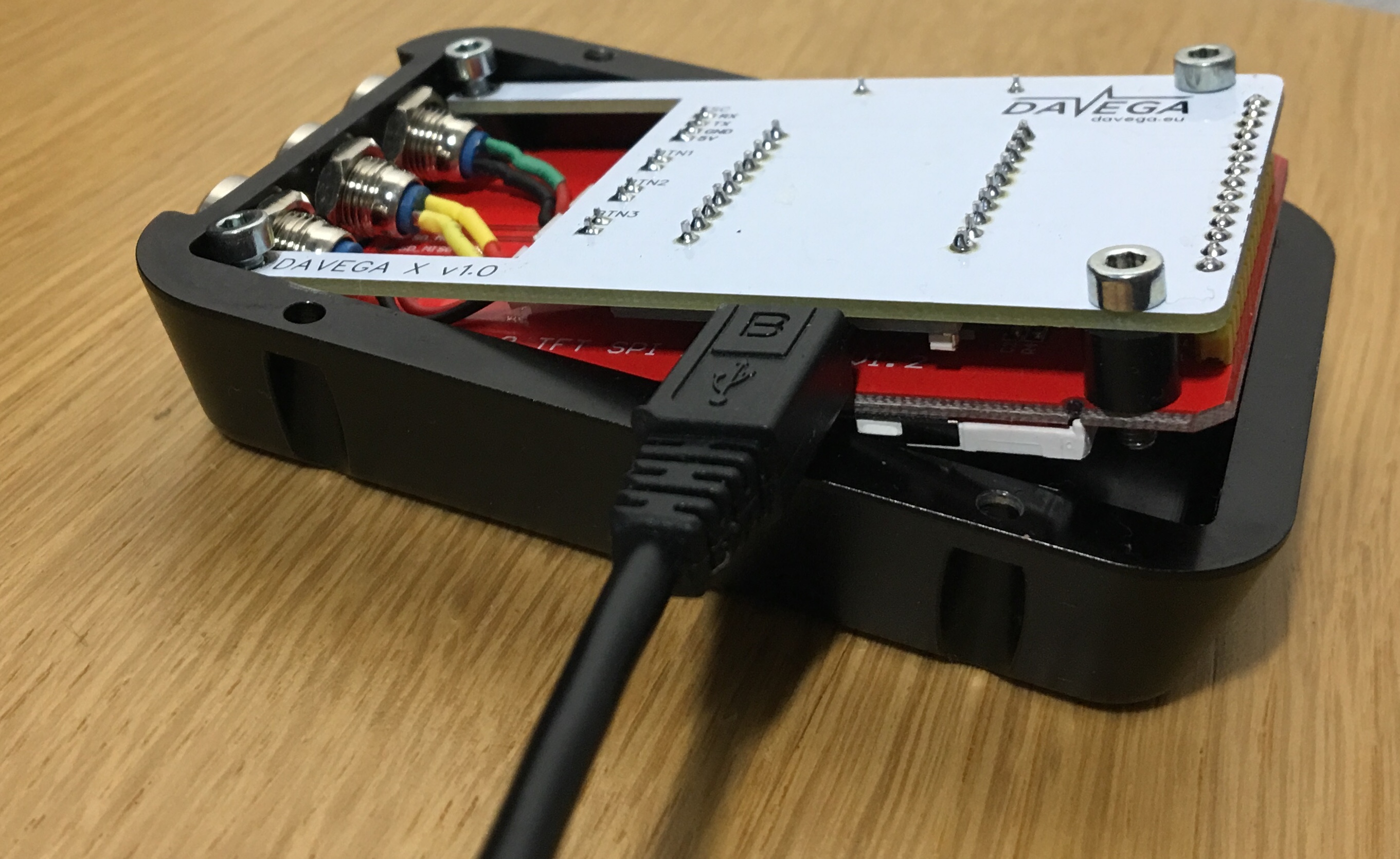

Getting access to the microUSB port
The easiest way to access the DAVEGA microUSB port is as follows:
  • loosen the 4 bolts that hold the PCB to the alu housing
  • carefully lift the side away from the buttons
  • plug the cable in

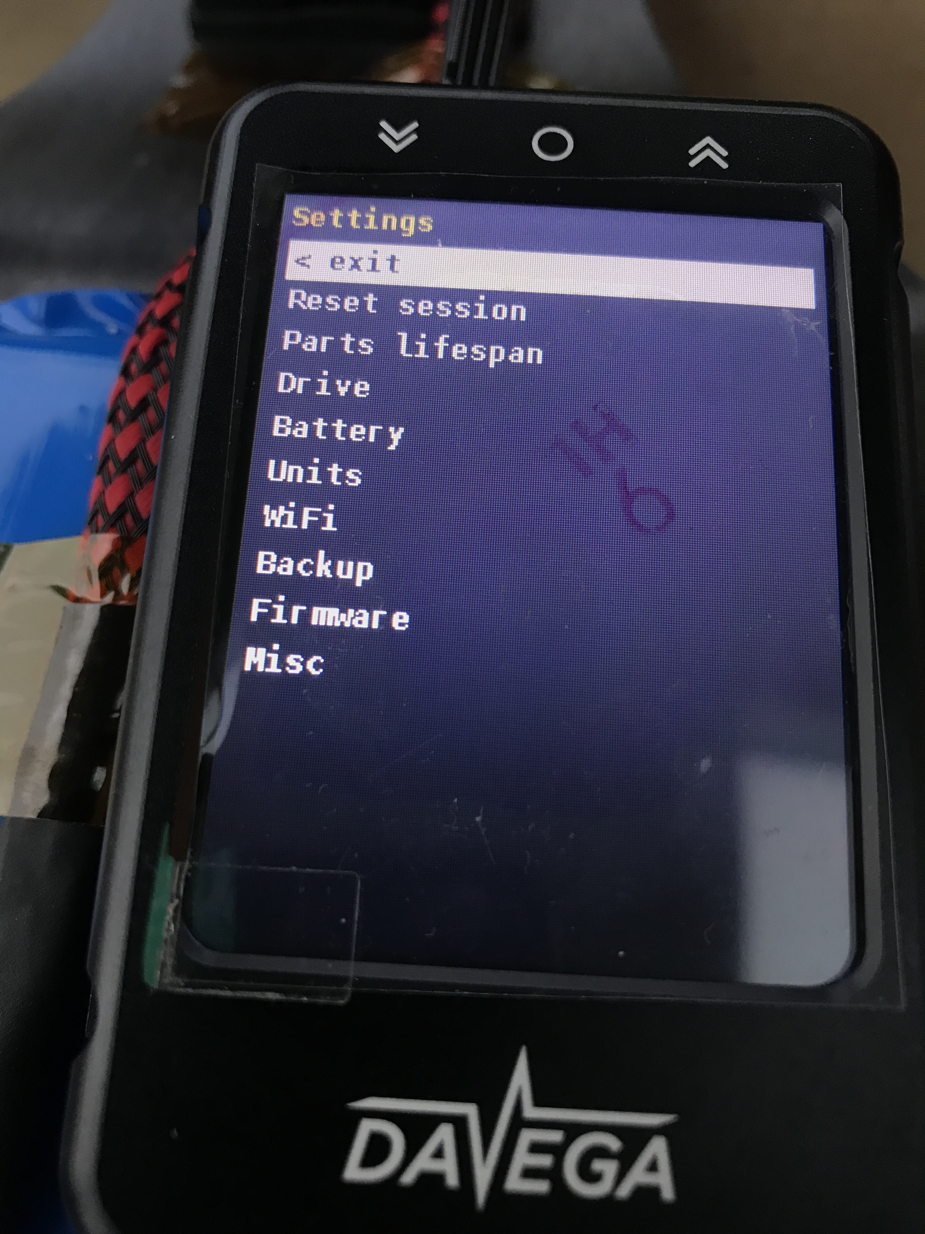

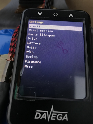

In the menu I can’t see a section “About” to see my device ID.
