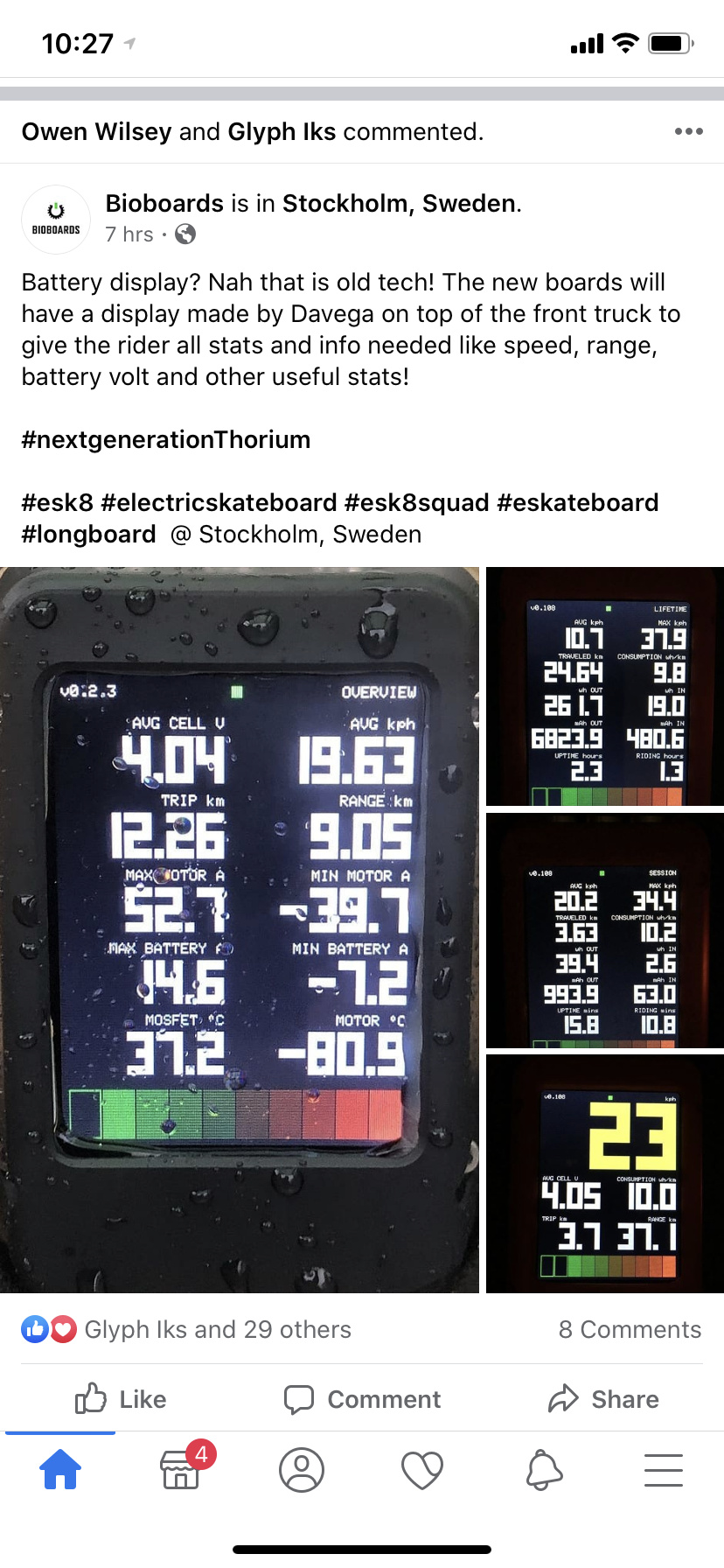

Finally some more significant developments. Looking for DieBieMS + DAVEGA X users for testing.

I’ll have all three once my flexi arrives :smiley: What exactly do you need tested?

Perfect! Do you have the DieBieMS connected to your VESC via CANBUS? If you do, I could just send you the development version of the DAVEGA firmware to check everything is working as expected on your end, especially reading the BMS data.

How power on would work? Any way to have the Davega power on when the charger is connected?
For now you need the VESC to be on for the DAVEGA to be on since:
  1. It takes 5V from VESC.
  2. It communicates via the VESC. Currently DAVEGA can’t communicate to DieBieMS directly. It needs the VESC to relay.
Then the question is if DieBieMS can be configured such that it enables discharge (and powers on VESCs and DAVEGA) once the charger is connected. I haven’t yet looked into it.
Next generation of DAVEGA will have CANBUS and then VESC is no longer needed to relay so it can remain off while charging.
