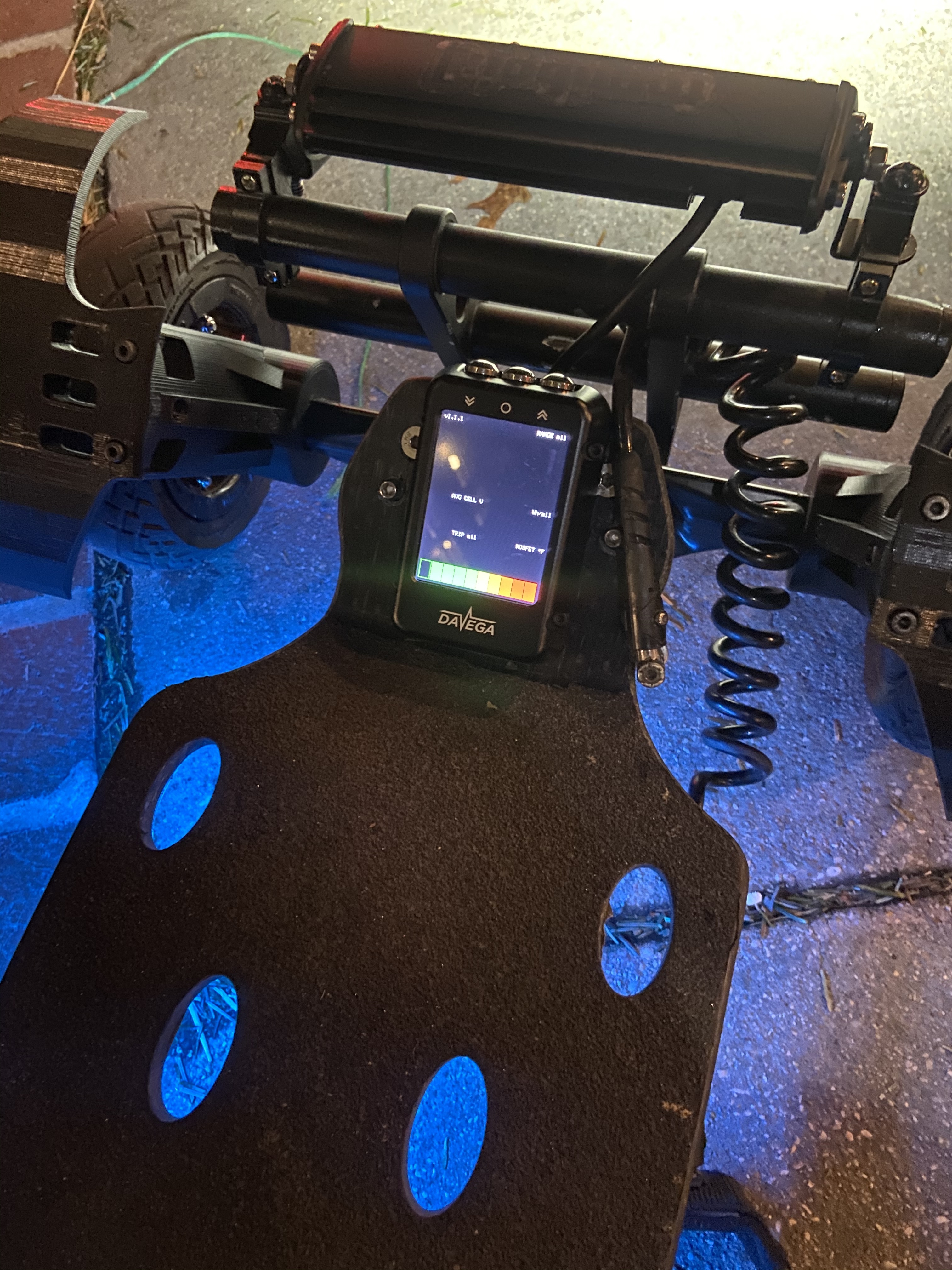

So this is my biggest issue w my unit. Only happens when my ttl has all the lights hooked in.
No data. Just battery bar.
Does the screen freeze or is there a red dot blinking at the top?
If the latter, that would mean the UART connection breaks for some reason. How are the lights set up? Do you have a Metr module that you could plug to UART instead of DAVEGA and see if it also looses the connection when the lights switch on?
The red dot goes. I’ll check w my metr
I ran the DAVEgaX solo for 15 miles today. No issues to report
