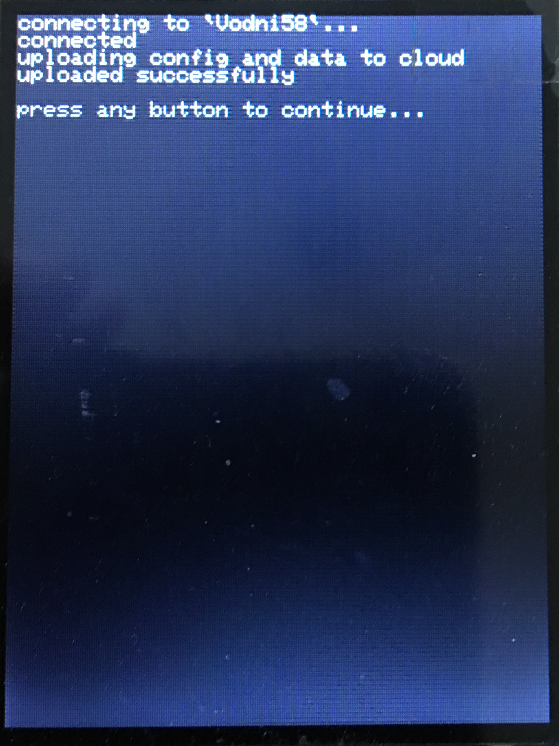

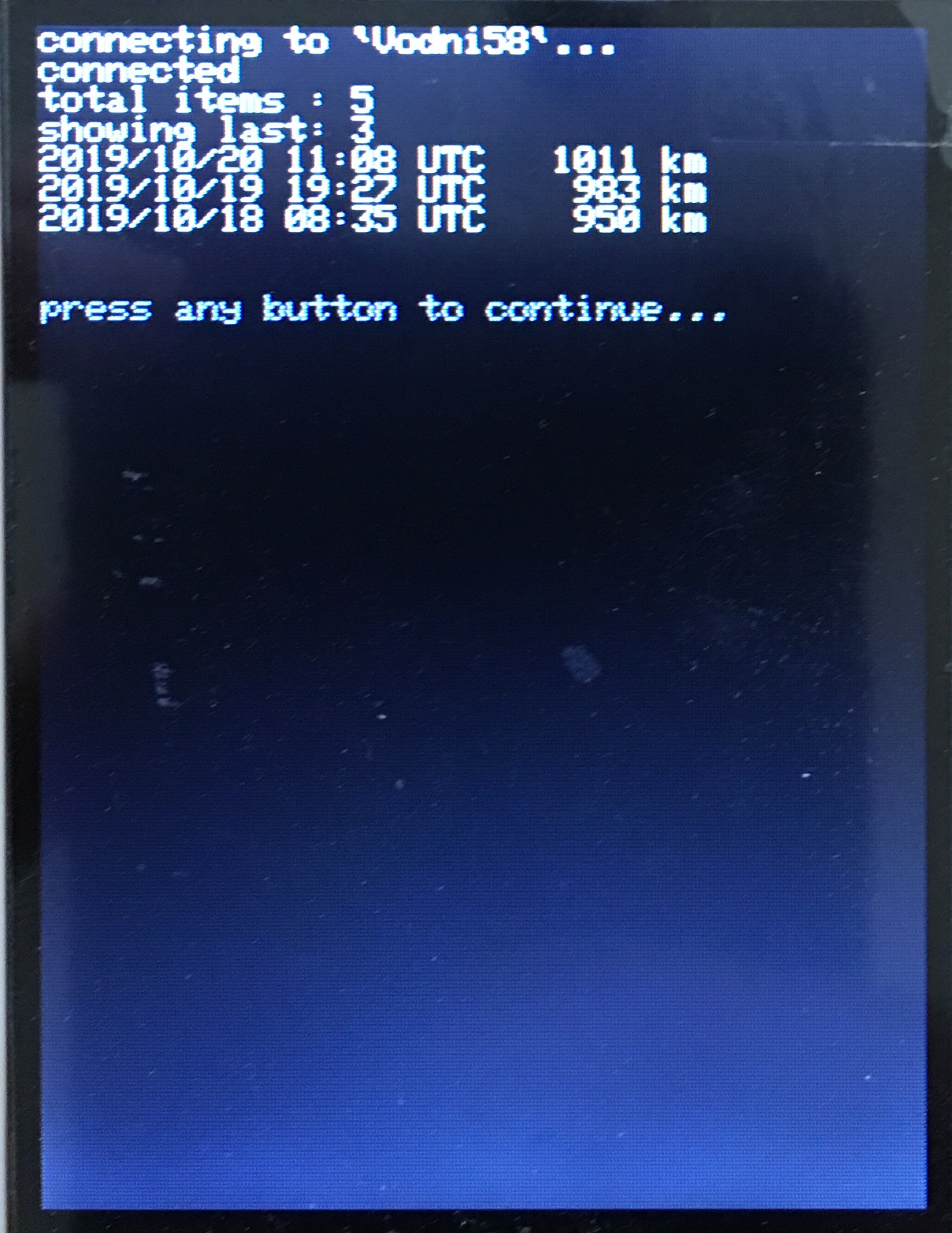

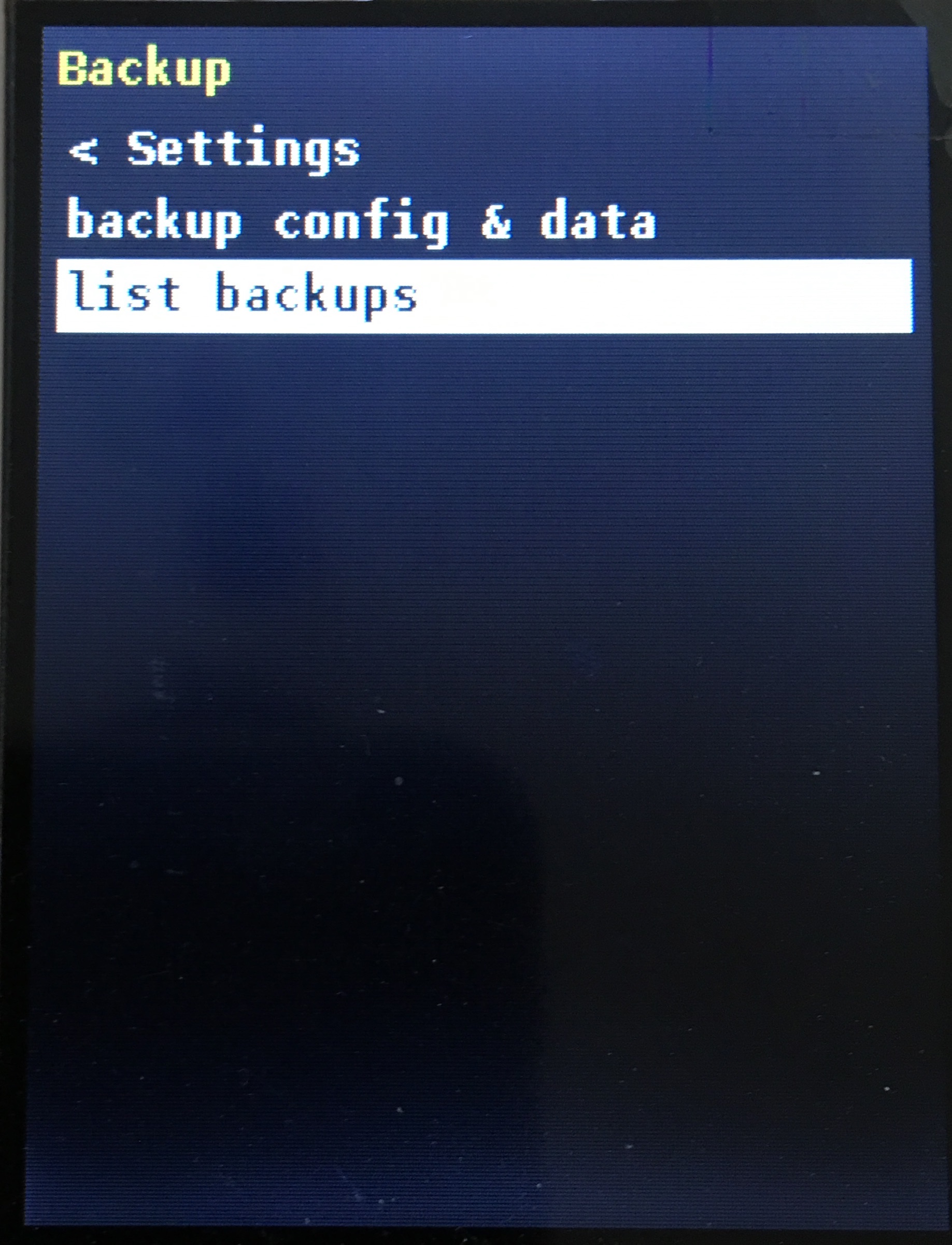

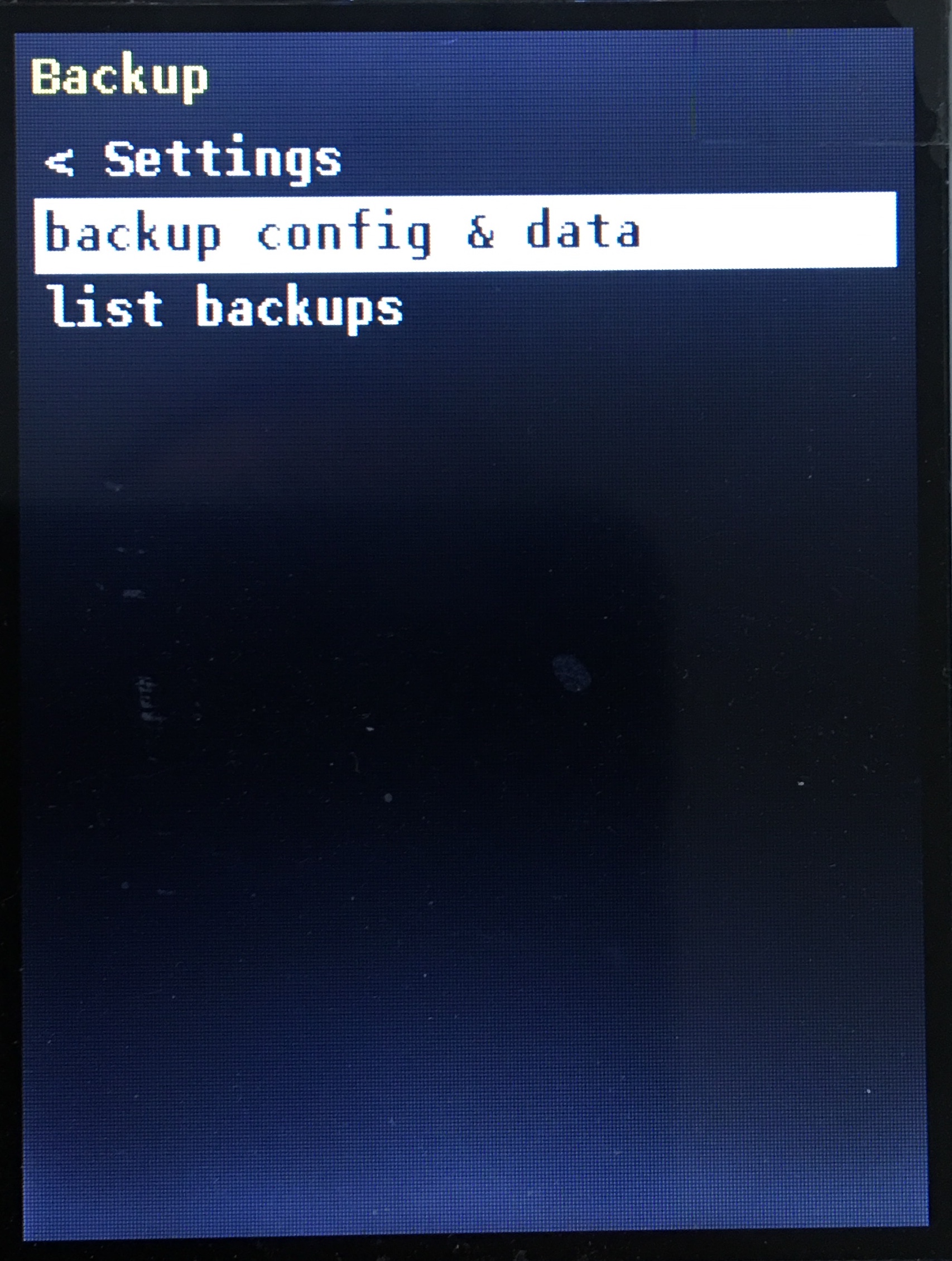

Sneak peek of a new feature: backing up config/data to cloud. This is mainly to allow restoring the data in case something goes wrong with your davega. However, there’s more that could be done with the data if you upload it on regular basis. For example, I could plot timelapse charts with your odometers; show how your consumption or avg speed or max speed evolves, etc.
Also, we could have some fun with the data and have scoreboards for the fastest / most active / most efficient riders in the last week/month, etc. Thanks @mackann for the idea.
Other ideas/suggestions are welcome.

If anyone feels adventures, you can install the FW v1.2.0rc (release candidate) and test backing up your data/config to the cloud. Note that you may get a memory error when trying to upload. In that case please restart the davega and hold the middle button while it’s starting up. That opens the menu immediately after boot up. Then try to do the upload again.
I’m going to spend more time on the memory errors before making an official release.
