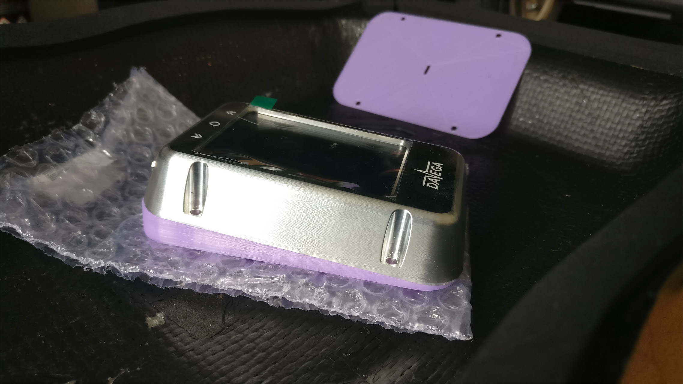

Quick raw print, the design is not finished (as the color print ^^) but its to make an overview :slight_smile: (its around 40mm heigth - the shield, with à 2.5° riser)
I’m having a slow moment here but how will angled risers work?
It seems like that bolts won’t align with the thread holes?
Yes, its why I extrude holes from both side (flat and 5° one), then made a centered hole from of the previous two with a bit extra room (actually 3.6mm for the m3 screw … with 4 screws screwed it’s gonna be ok) :relaxed:

Hmm sorry I don’t quite follow even looking at the stl.
Would the angled risers also involve angling the bottom plate of the Davega? That to me would make more sense.

Sorry, but if I understand you well, no.
Not to me. For me the bottom plate it the support to fix the Dav on the deck,
plus the riser will reduice the tiny little hole that could let watter in between the bottom plate and the top case (then just add some glue around the the hole and wires).
I do it that way, but I guess other will work too :slight_smile:
Oh do you not use screws to hold the top? Is it held together by glue? The way I see it is if it’s at an angle, the screws won’t go into the thread holes.

Yes, I did use screws! I told you I make holes, there was for the screws, like I already explain.
Be sure I see the same thing that you :relaxed: , and once again its why I adapt the weird design for it.
Other way will/could work too.
In any case, with only 2.5° or 5° riser, it works perfectly :
It’s why I didn’t make a 30° one, but I will see how work 10 or 15° now :wink:

Duh, it finally clicked in my head, haha I was thinking too hard about it. At a slight angle, it wouldn’t affect the seating of the screws which is why maybe 30 degrees wouldn’t work. Thanks for bearing with me :sweat_smile:
Yes, 5° isn’t changing that much, its why I didn’t share the 2.5° on Thingiverse.
But it will be useful for the support of the shield I think… we will see ^^
