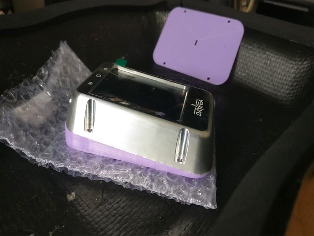

What the DAVEgaX really needs for us trampa guys is a wedge like baseplate mount to correct the 35 degree angle. I’m thinking like a 20 degree wedge would be perfect.
Someone could easily design and print a wedge to mount it that way.
Imo the 35° angle works fine, no glare and its nicely readable.
:relaxed: I have shared something like that this afternoon, on thingiverse (0°/flat and 5° for now, 2.5° on upload soon, 10° could be made if someone need it, but it will start to be high !) :
Edit Pics :

Could that be of interest to someone ?
I definitely want the wedge.
I just checked out your full catalog on thingstaverse. Well done sir.
Great stuff! Thanks a lot for sharing man. I love the sun shield. :+1:
Do you have a picture of the shield installed?
Beautiful creations and renderings! Love the angled risers, will definitely print one out since my DaVega lays flat.
