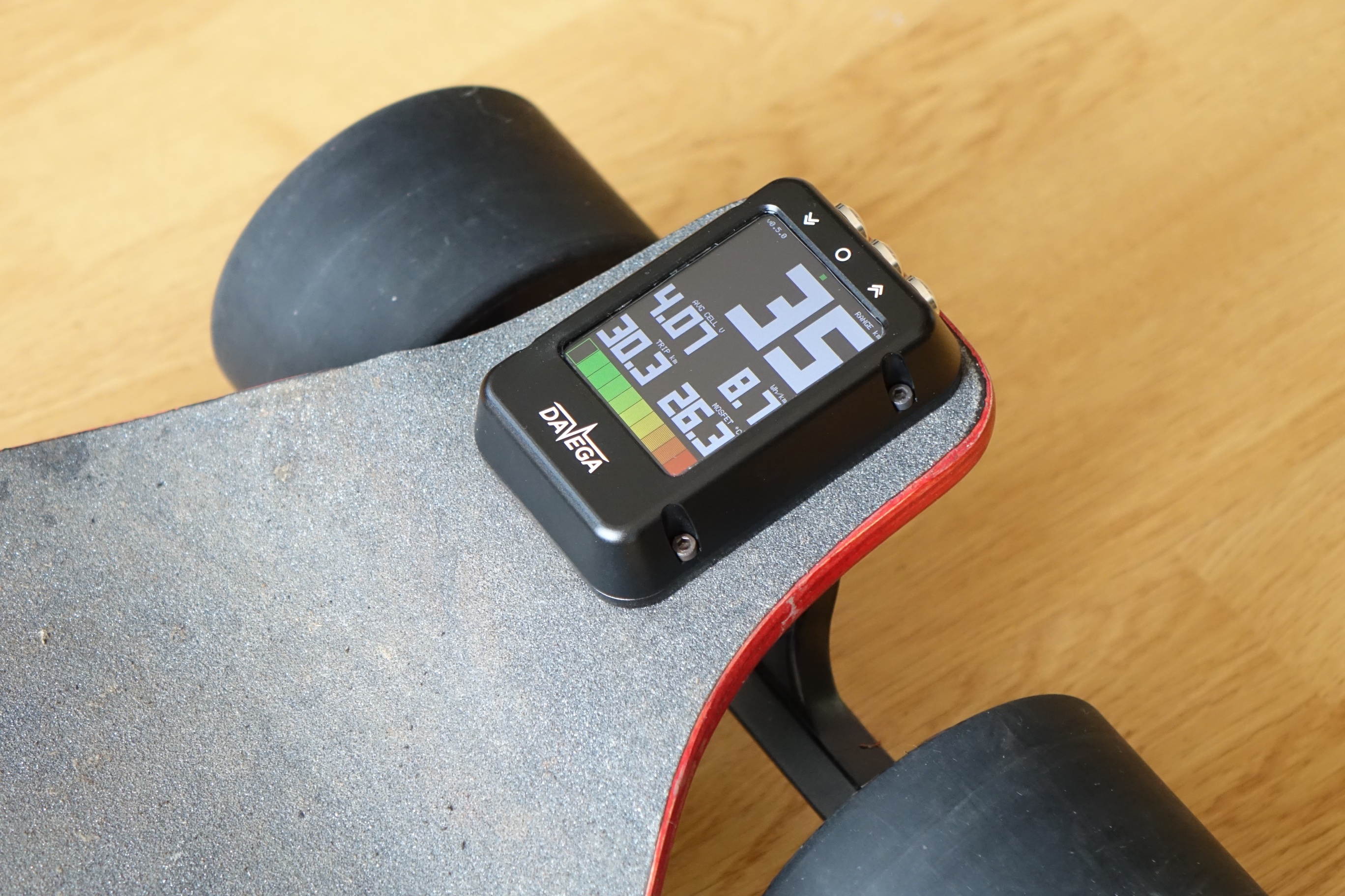

I’m really looking forward to this. Visually it’s stunning, both the case and the UI. I’m sure it’s at a minimum as good quality as the OS version, so zero worries there.
I look forward to be able to order a couple. Good job as always @janpom.

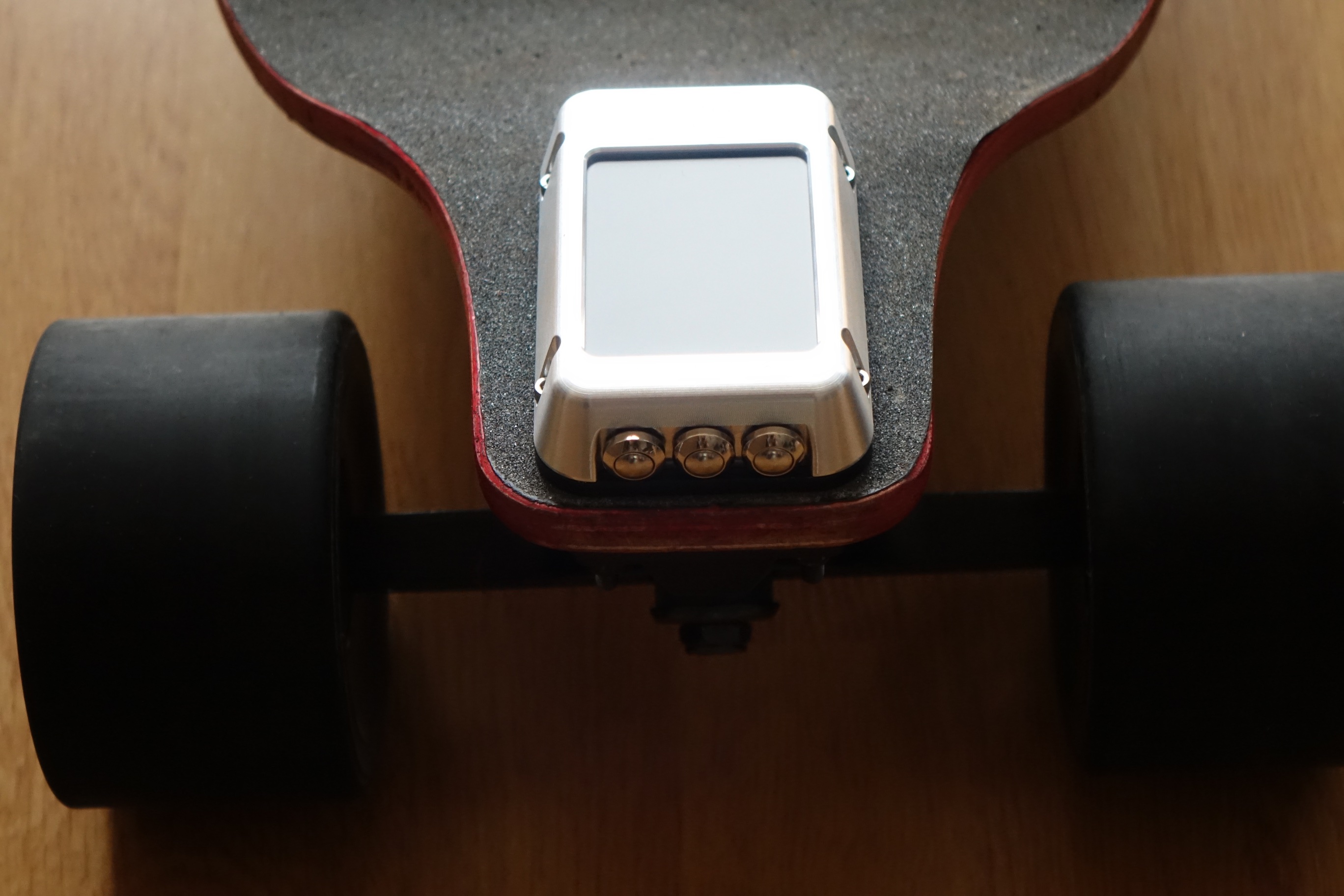

This is the sexiest davega enclosure ever made! Well done @LR-designs!
It sure is! Where’s the form!?
Everyone asks here for that! I CAN’T wait. I need now.:crazy_face:
You’ve got my attention now :slight_smile:

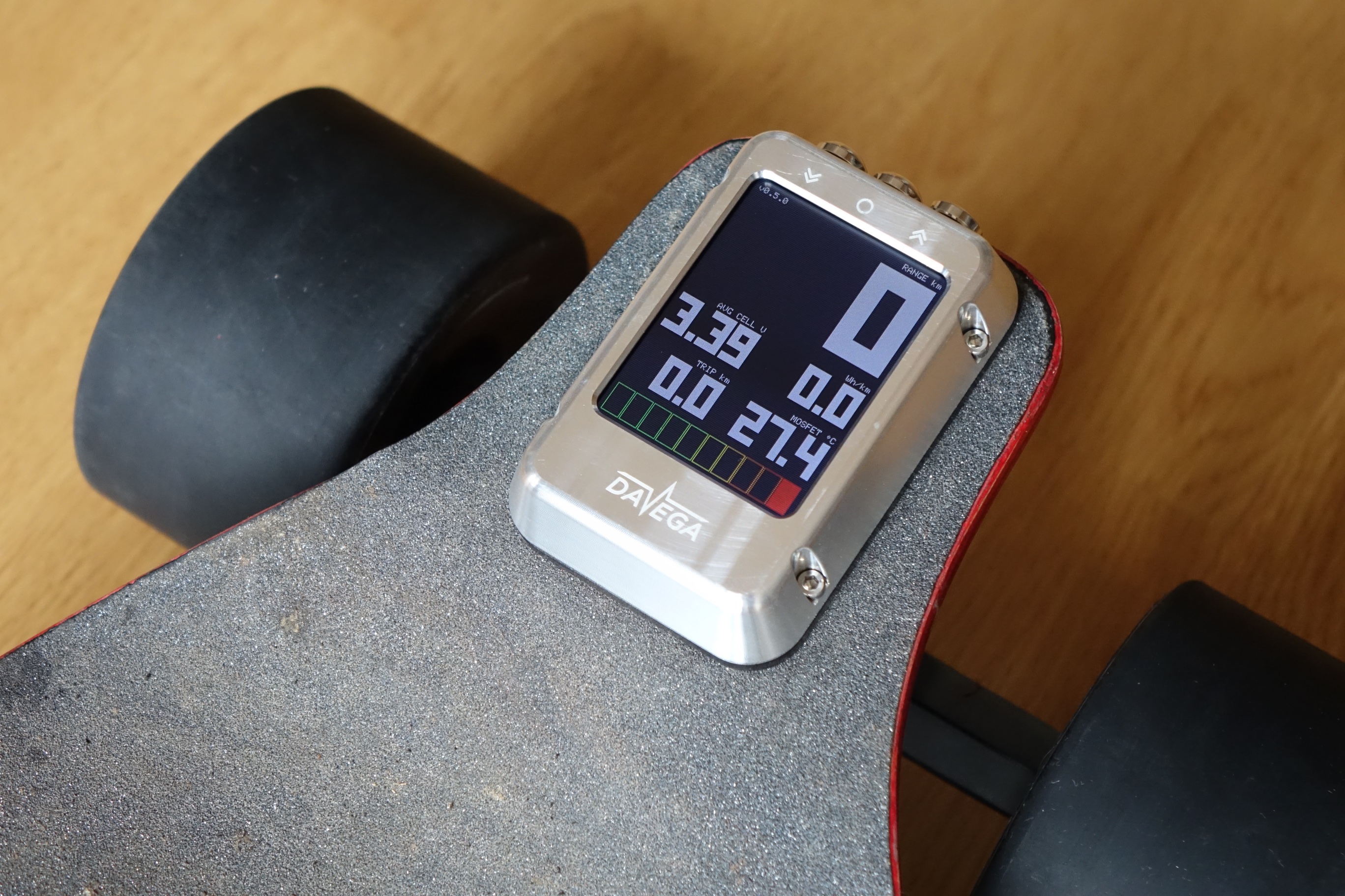

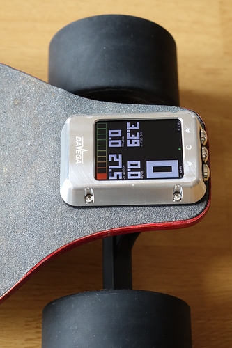

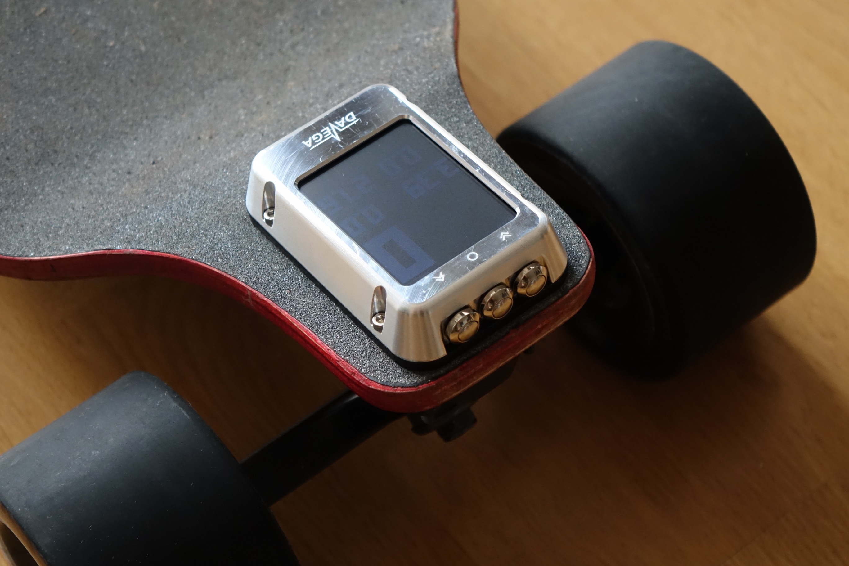

metal > not-metal
I didn’t give enough credit to the raw until I installed it. It really shines on the board, despite the small scratches from machining that haven’t been covered by anodizing. I think I’m keeping that one.
BTW, raw housing will come with raw baseplate. I was just too lazy to change the baseplate for the picture.
