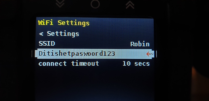

I got a problem with the WiFi password… I made a mistake and fill the whole Line with characters… Now i’m stuck on the last karakter en de back button doesn’t work anymore… i can’t remove The characters anymore??? It doesn’t Matter how much Times i press the back button (arrow to left)

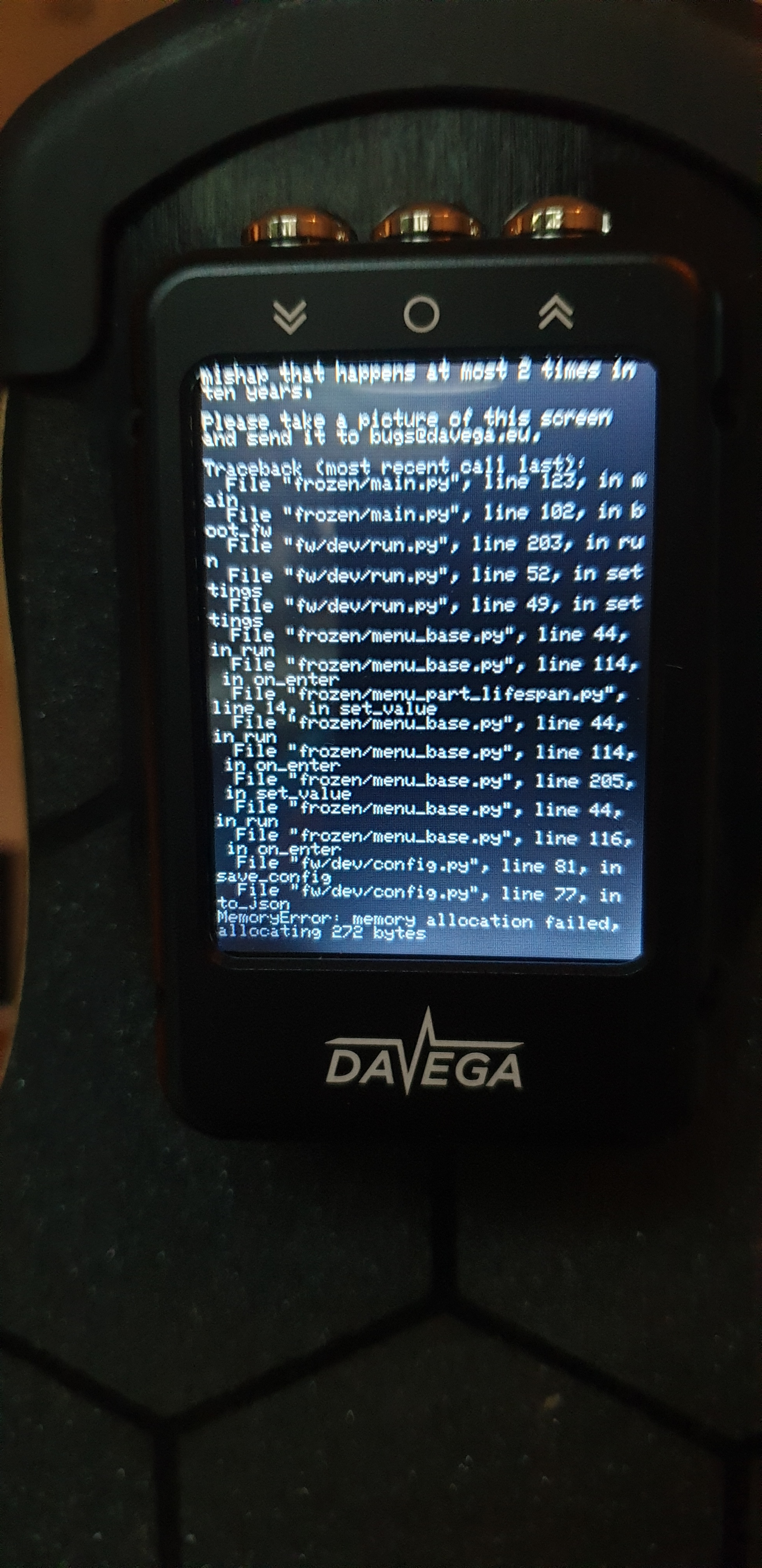

And have some errors …

The problem with the characters is solved… I had to press de delete button for about 13 Times​:grin::+1:
But the error is coming up every few minutes and i still can’t connect to the wi-fi… I change my password change the ssid many Times but still can’t connect to the wi-fi… Before The last update i can connect to wifi but now not anymore…:frowning:
I’m 500% sure that the SSID and password is correct :+1:

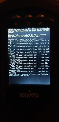

I’m aware of the other error. It happens in FW 1.2.0 when trying to add a new part and customize its name. Sorry about it. I’ll fix it soon. A workaround is to temporarily switch to an older FW version, change the part name, and switch back.
I’m not sure what you mean by this. The stacktrace that you posted above is clearly from the part lifespan tracking menu.
Do you also get memory errors when trying to connect to wifi? Can you please post the error screen?
OK, I see. Please try setting the ā€œconnect timeoutā€ to the max value (I think it’s 30 secs) and report back.
Can you also try another wifi? Maybe create a hotspot with your mobile phone?

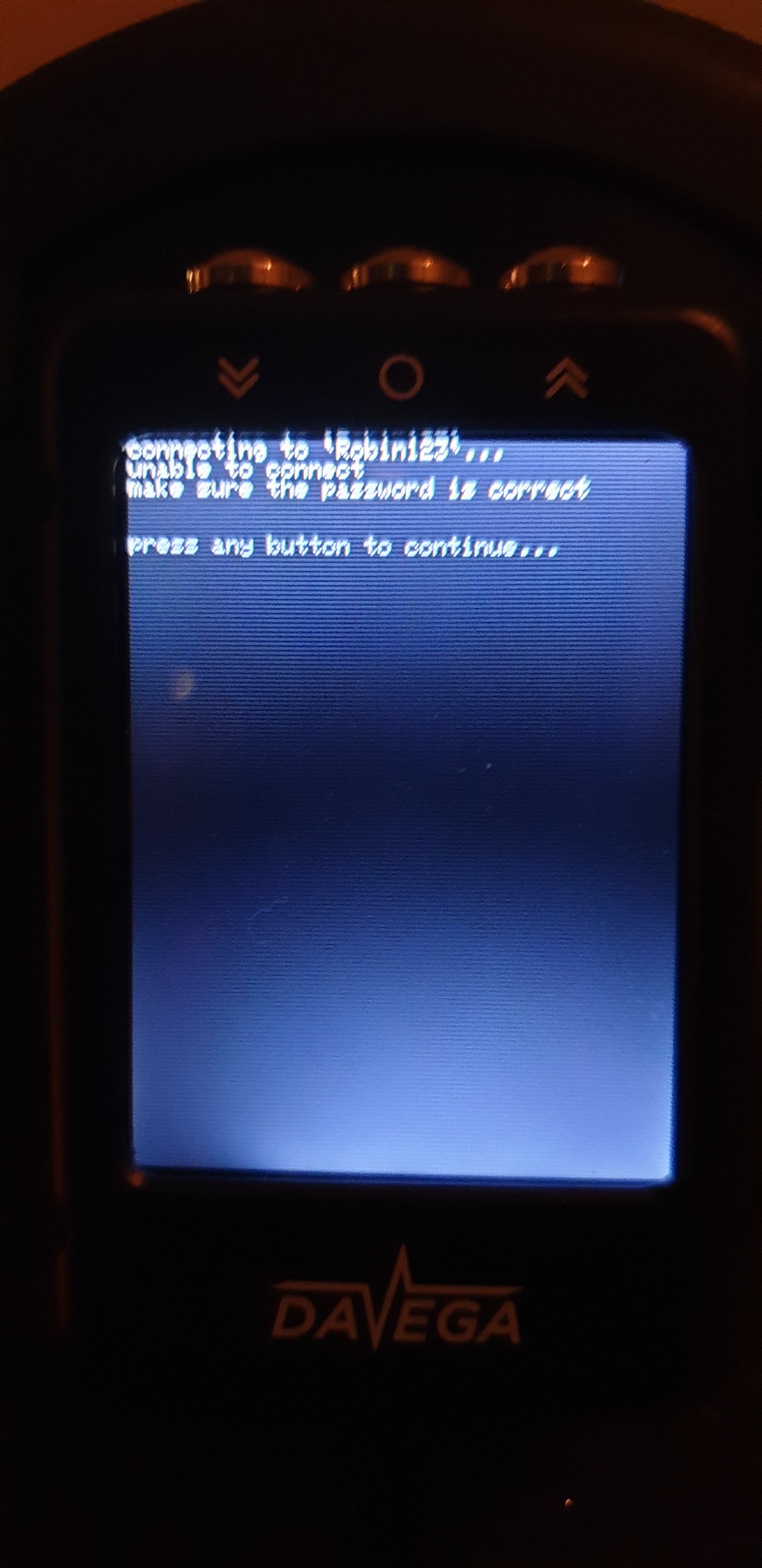

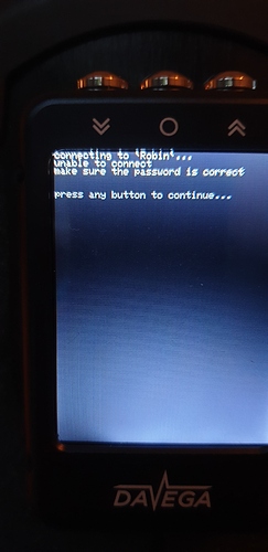

I did already a hotspot on my phone…not working also…try now on v1.1.0 not working and on 1.1.2 also not…can’t connect to the wi-fi error…
Can i do a Total factory reset?
You can. Hold all 3 buttons for 10 seconds while booting up.
That’s weird though. Have you tried increasing the ā€œconnect timeoutā€?
@janpomI gonna try that and i increase that to thirty seconds stil nothing…
I did a factory reset, direct after scanning the wifi network i get this in my display
Okay, this is not normal. You may have a faulty unit, in which case I’ll of course send you a replacement.

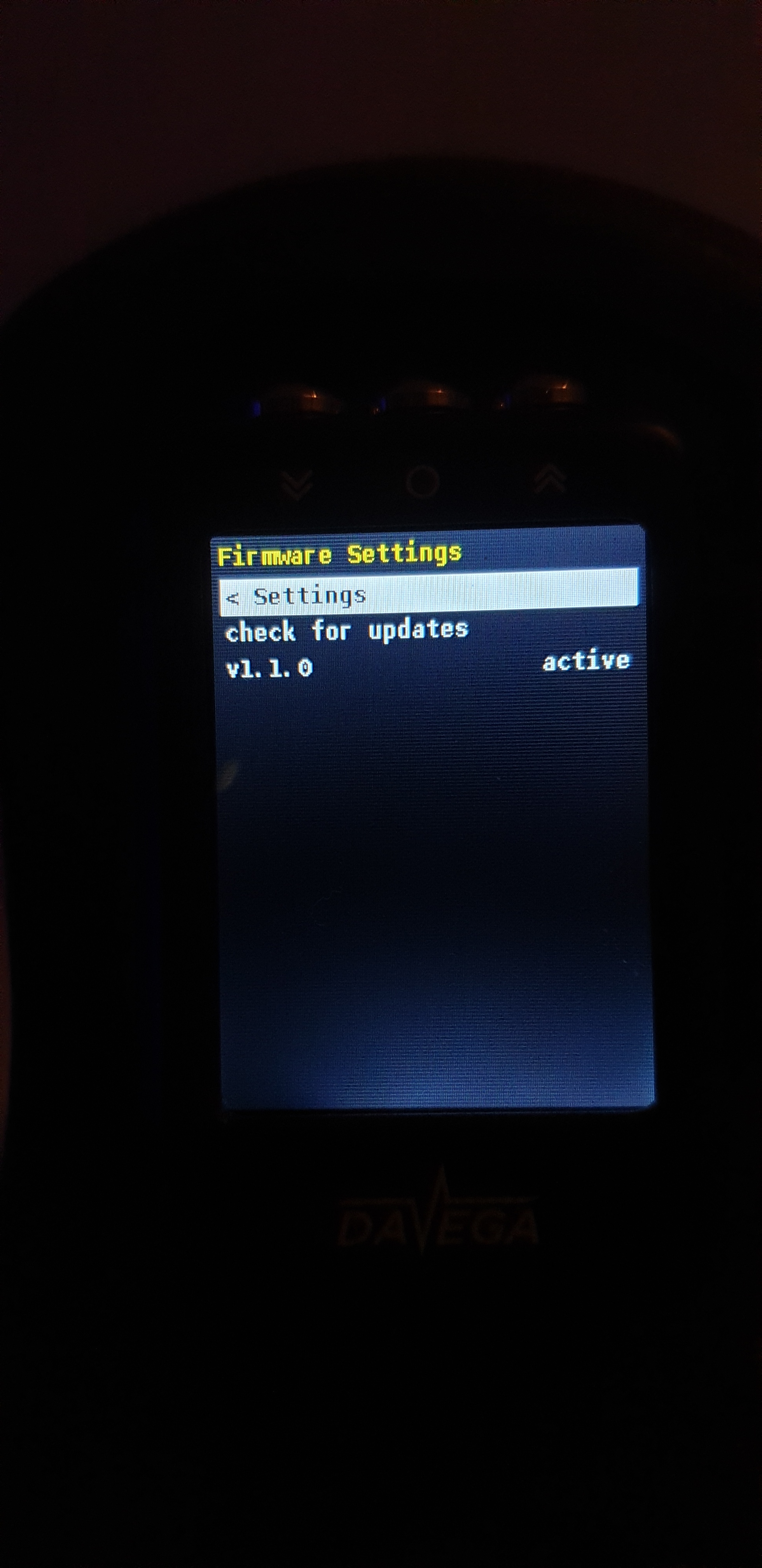

Switch to v1.1.0

I did also remove firmware v1.1.2 for extra memory…no luck :frowning:

Update: This turned out to be a problem with @Robin’s Unity. The DAVEGA WiFi connection works correctly with one of his two Unities but not with the other one. The problem likely is that the 5V supply on the faulty Unity is unable to provide enough power for DAVEGA to communicate over WiFi. Davega’s ESP32 requires ~110 mA @5V with WiFi disabled and ~150 mA @5V with WiFi enabled. Apparently the latter is too much for the faulty Unity.
