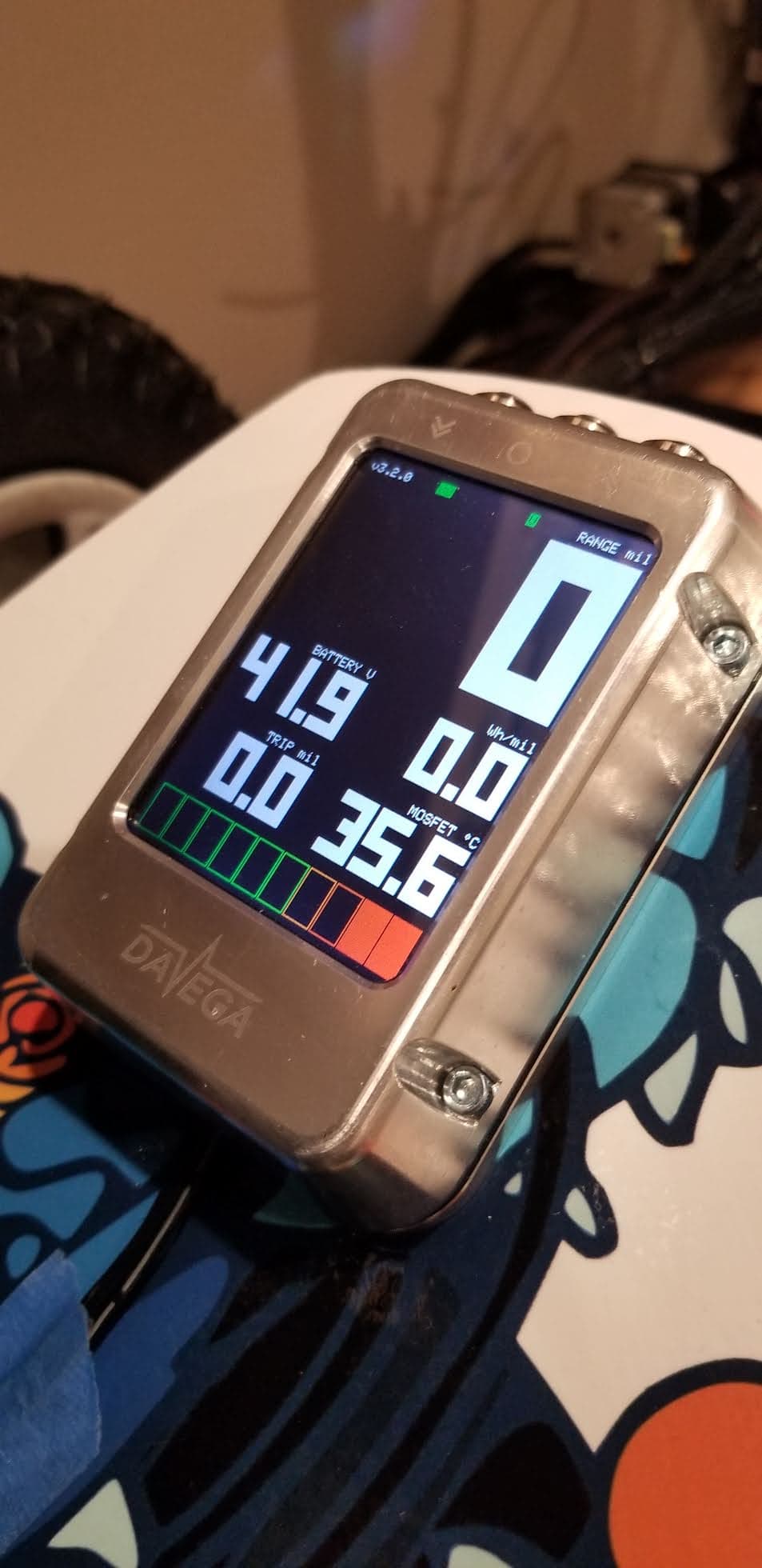

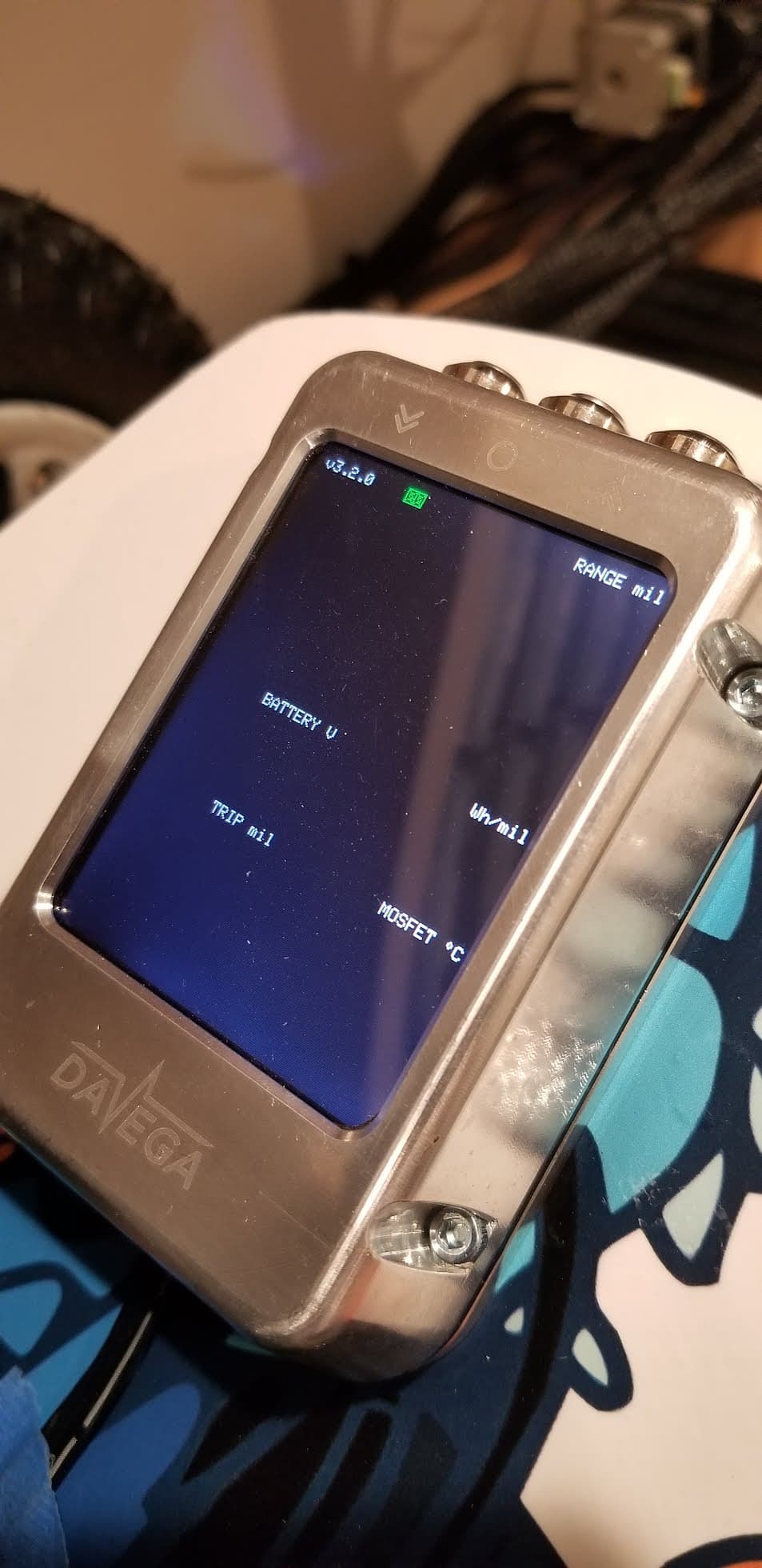

I have no graphics upon startup.

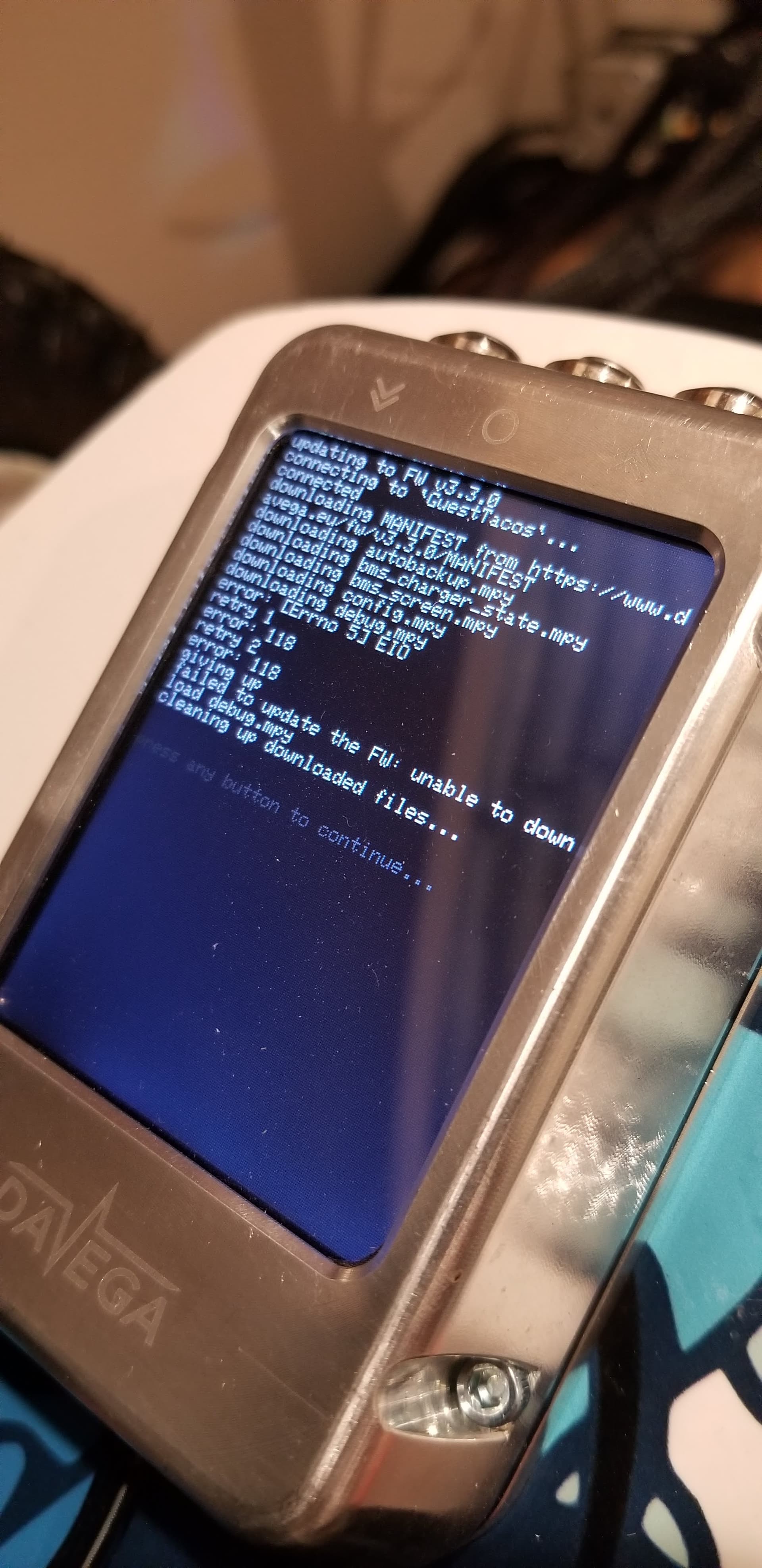

Connected to wifi, tried updating, but failed twice
I got this unit from @Skyart - it had v3.2.0 loaded and v3.1.1 on local
Tried both, no graphics either way
Switched to 3.1.1 and tried updating - failed again. Sometimes it appears to freeze / buttons become unresponsive after failing to update. Had to power cycle by unplugging.

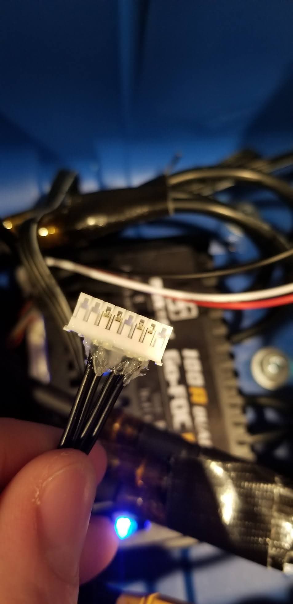

MakerX DV6 → checked VESC Tool → both sides set to PPM and UART. Buad rate is 115200
I did have to switch from 7 to 8 pin connector. Maybe a wire is loose.

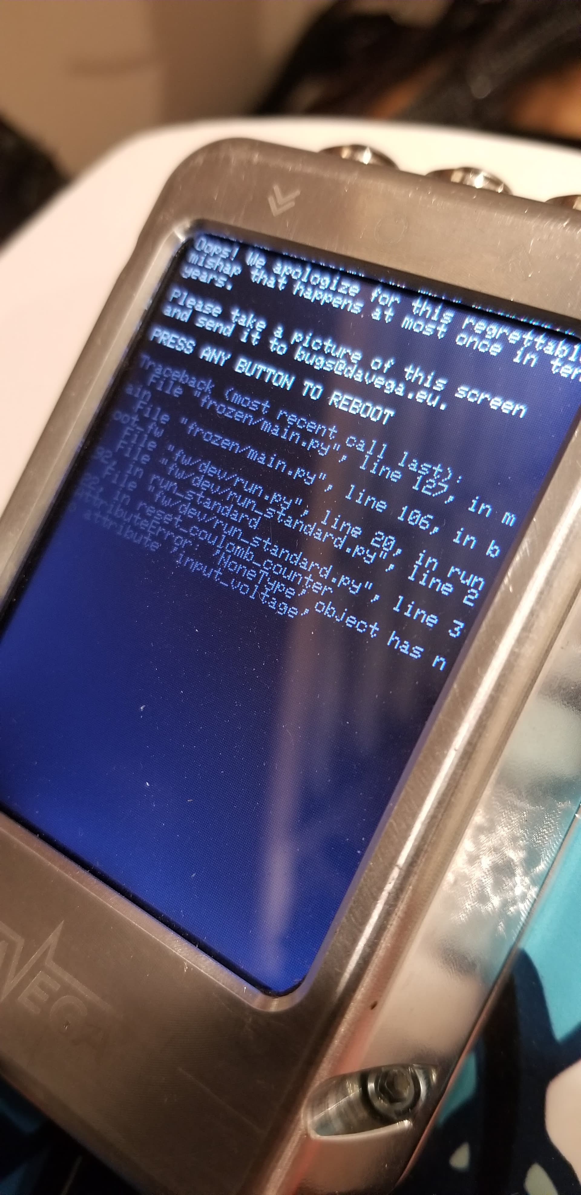

Got this error after factory reset and trying to update:
Connector on this side appears to be fine. Pins in all the right places. Not 5v
Hmm… maybe the TX and RX are switched
Success!
Now to make a backup before I try to change anything
Yes, RX/TX switched and you’re also running an old firmware otherwise it wouldn’t be a problem.
That’s why I assumed it wouldn’t be a problem per the instructions - when I wired it before powering it up!

Any idea about the previous errors I encountered? Those seem unrelated to TX/RX pin reversal. Hopefully a direct usb upgrade bypasses the issues.
Probably a bug. I imagine that if you reset the session without having the VESC connection established it could lead to an error. It’s not something that you encounter under normal circumstances though.

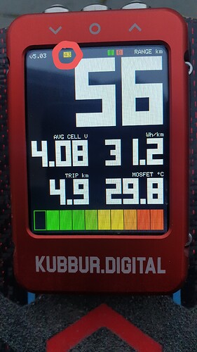

What does the 43 mean ?
And should the red b always blink as much as the green ?
It’s how many km you’ve traveled since the last data backup.
Red blink indicates a lost data frame. Occasional red blinks are normal but if it’s 1:1 with green blinks, there’s something wrong with your setup. Could be a loose connector or pinched cable.
