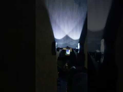

@janpom here’s video of the stuttering / slow updates on my davega - I mentioned this a while back, finally got video. If feels worse than before, but maybe I just didn’t notice.
I kept playing with it - the Davega almost never updates if I’m accelerating. Once I let off the throttle, it jumps. Although in this video it also doesn’t update the entire time I’m braking.
Any ideas?
Edit:
Sorry, I realized I’m not giving you much info. I’ll confirm what firmware it’s running tonight. It’s not the latest.
That looks as though the connection with the VESC is dropping off. It’s impossible to make out from your video but I suppose you’re getting red blinks on the top of the screen (instead of green blinks). Can you please confirm?
If that’s the case, you may want to check that the connectors are plugged in properly. Securing them with hot glue or silicone is a good idea. You’ll also want to check the cable is not pinched anywhere.
There could also be some interference. If the former does not help, try re-routing the cable (even just temporarily on a bench) and see if that changes anything.

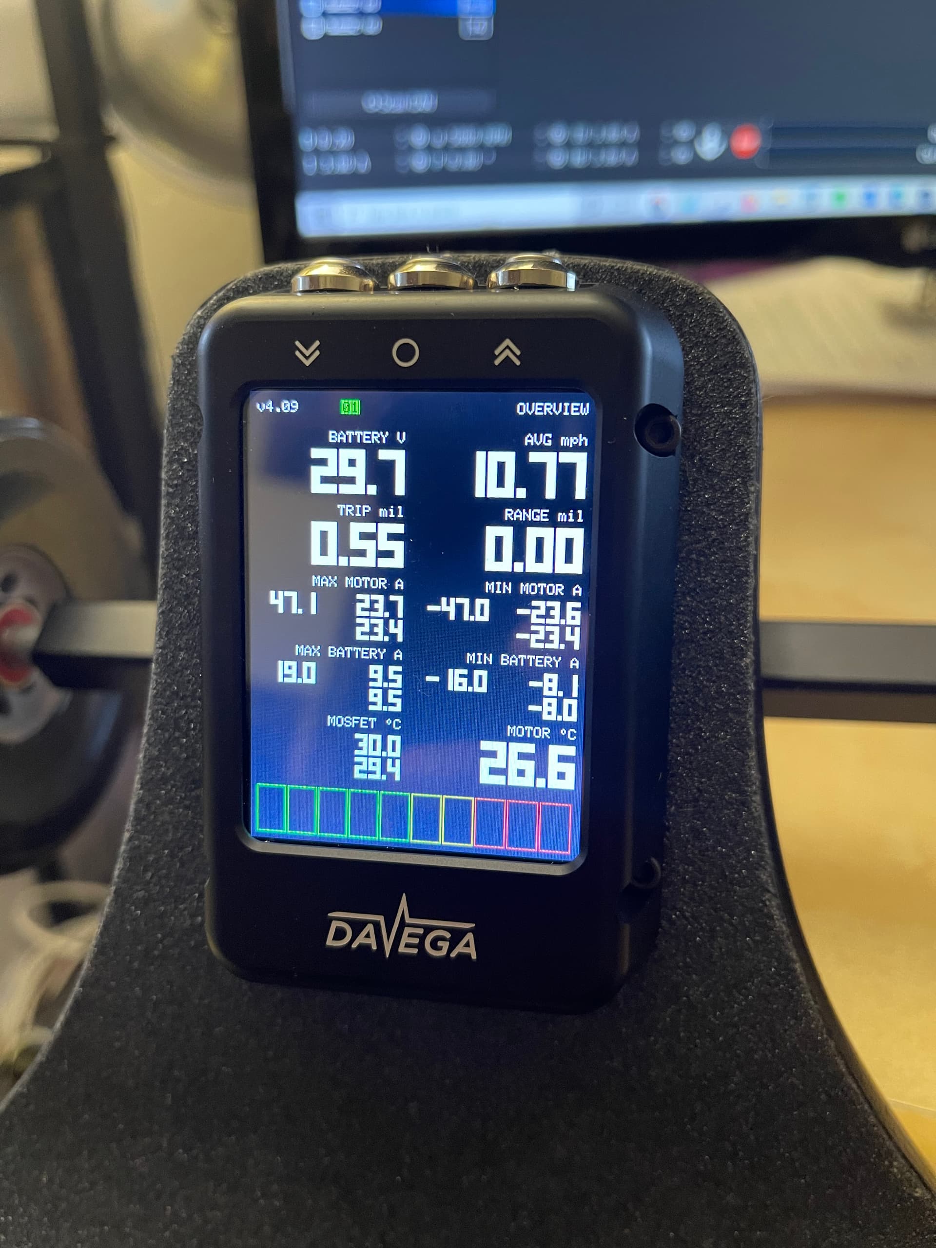

29.7V sounds like a completely depleted battery so that’s probably why. What’s your battery setup?

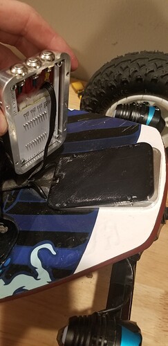

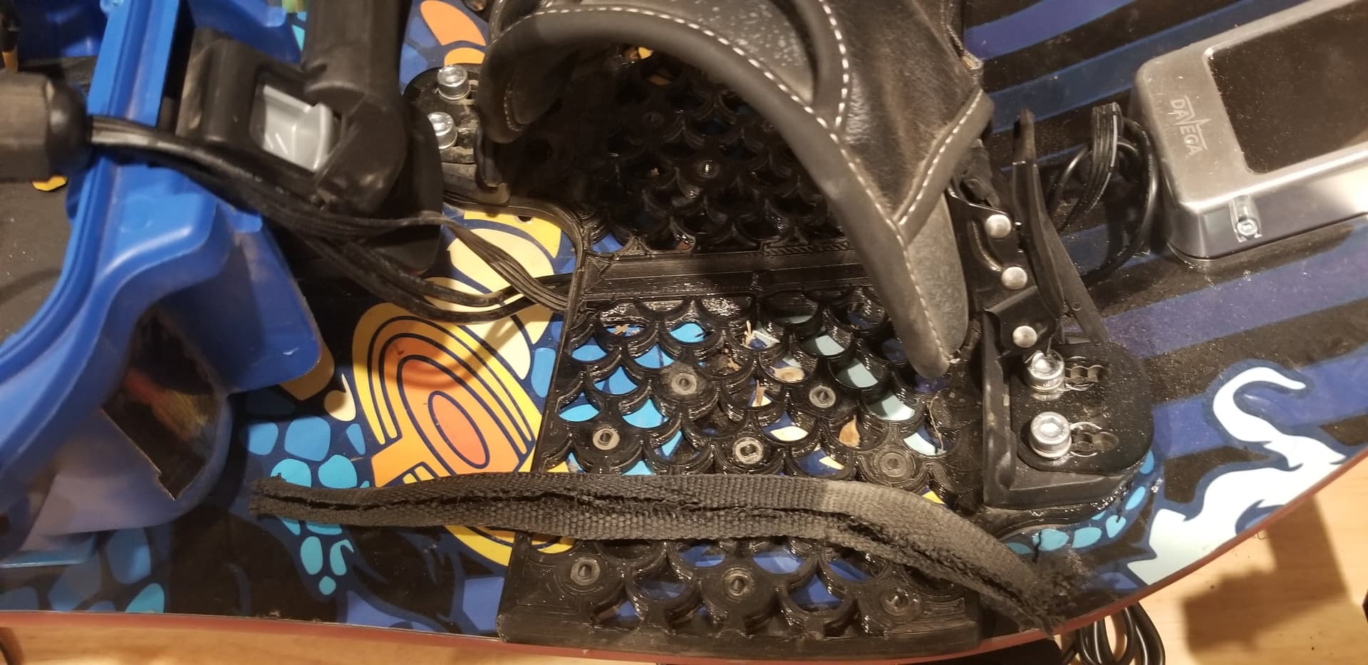

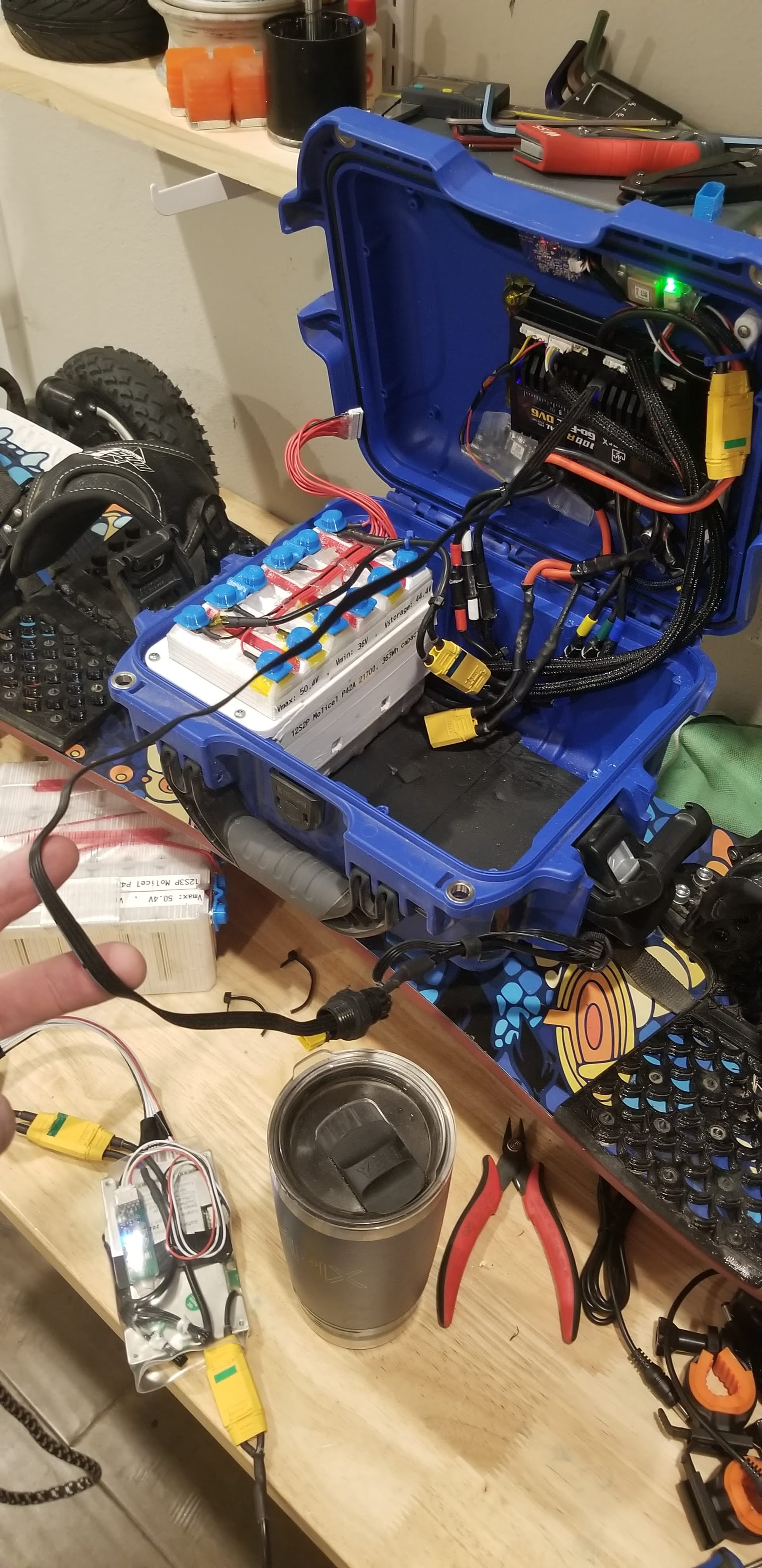

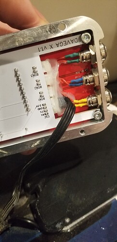

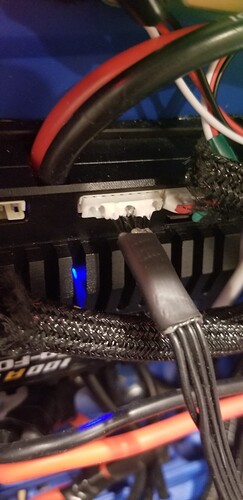

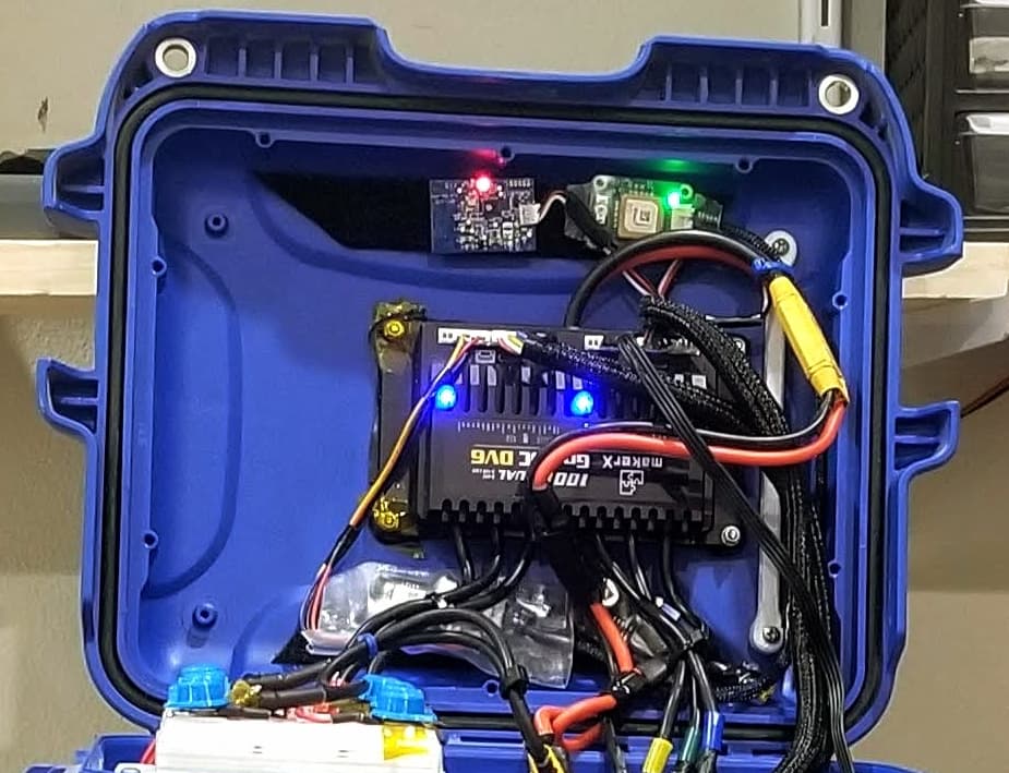

Troubleshooting update:
See video for clear example of red blinks / VESC connection drop off issue
Both connectors are secured as properly / tightly / securely as I can make them
I removed all zip ties, the grommet, and cut away the braided sleeve it was inside, to be sure it wasn’t pinched anywhere
I unplugged / depowered the lights that were wired alongside
I physically pulled / re-routed the cable fully away from everything else to minimize the possibility of interference
I checked the cable for nicks, cuts, or breaks - nothing

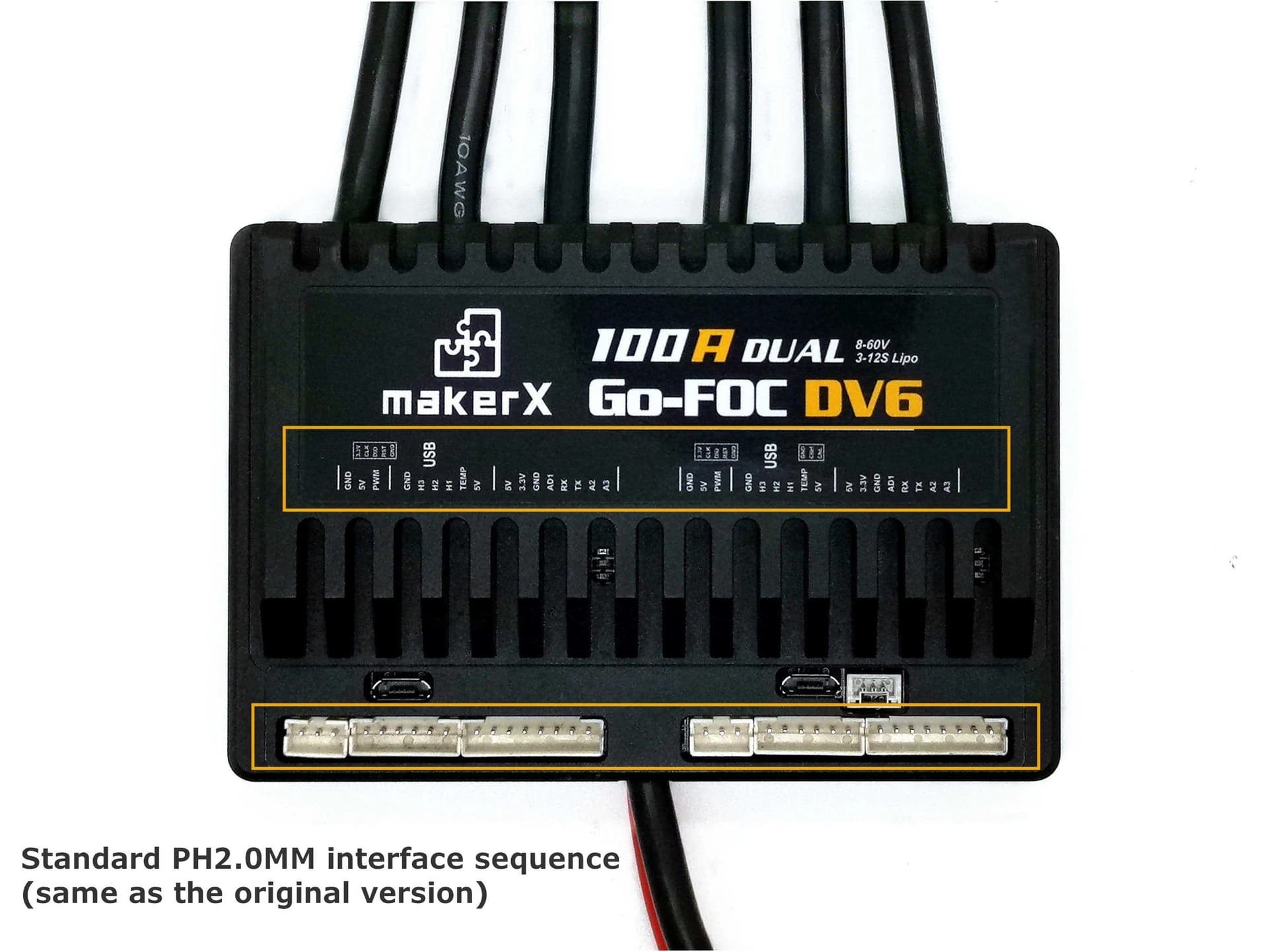

I tried swapping the ports on my DV6 to see if that was the issue - no change

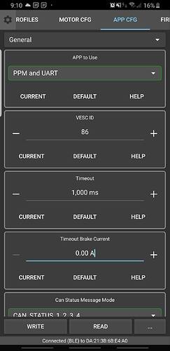

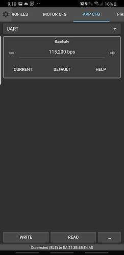

App settings are as required:
Any other suggestions? Updates are visibly slow and same behavior as before where the unit does not update while the throttle is being held. I am sad ![]()
I’m sorry about the trouble. This looks more like an ESC issue than a DAVEGA issue. Do you have any other telemetry device that you could test with the same port on the ESC? Metr Pro (not CAN) or Robogotchi?
