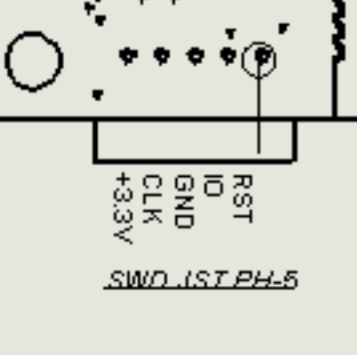

Does anyone know what will happen to a davega if you give it 5v instead of 3.3
Pzzzzt dead
Janpom is developing a 5v only one too, which he’s given out prototypes for.
Just give it 3.3? Uart has both (assuming you’re using stormies)

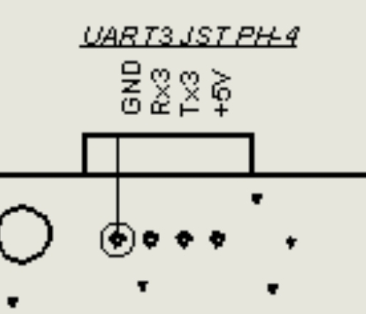

I am using stormies, but all uarts taken, accept for the one on the side which only has a 5v
I wonder if I can make a Y splitter for the 3.3v on the port that is occupied by metr…will that effect metr at all? Or will it just not work :sweat_smile:
I wonder if I can use the 3.3 on the 5pin connector on the other side :grinning:
Do you have space for one of those teeny tiny 1a buck converters?
You can buck 5 down to 3.3
Hmmm, going to try the other 3.3, should work!
The jst-ph5 ? That one has 3.3v on it

The jst-ph4 doesn’t

Yeah il use all the pins from uart3 and the 3.3 from the 5pin jst
Would clearly work. Just a matter of making that extra wire disappear into the background :wink:
