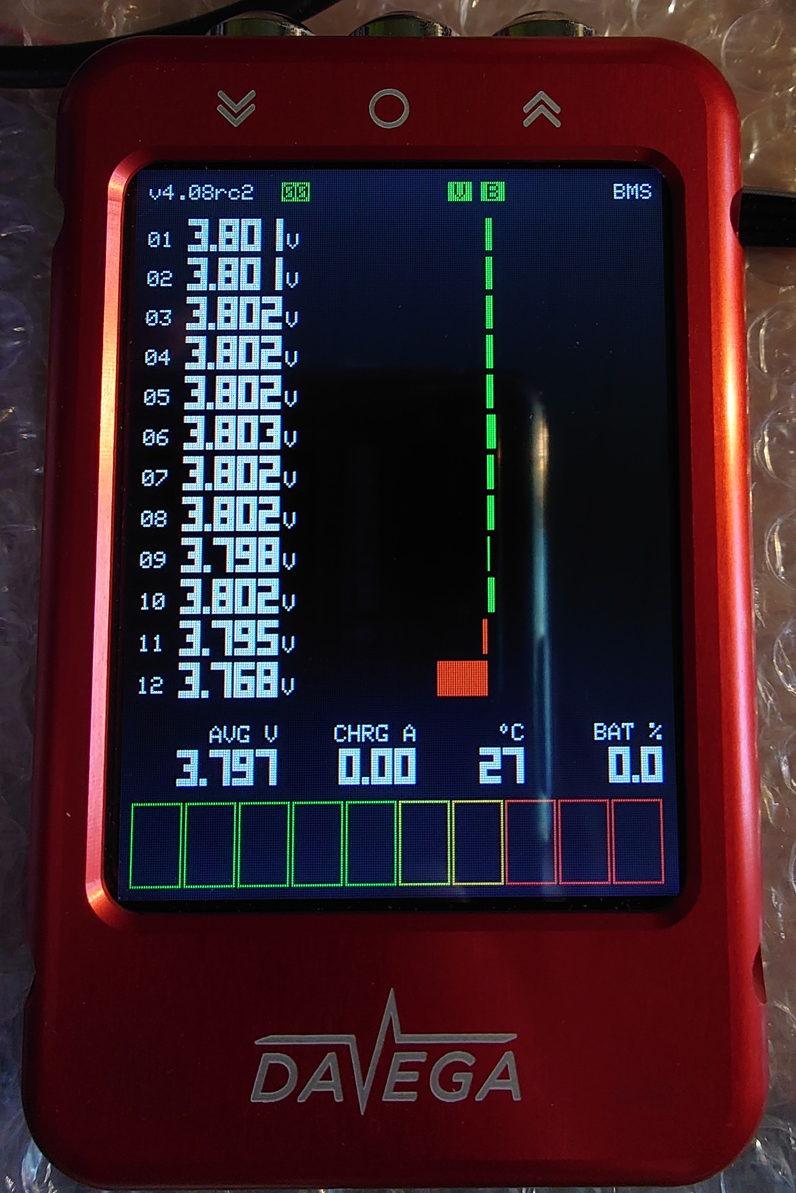

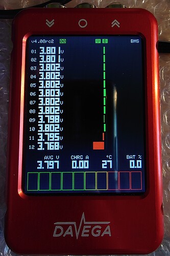

I just uploaded DAVEGA FW v4.08rc2, which might work correctly with Ennoid. I obviously have no way of testing it so I’m just shooting in the dark. @Prism, could you please try installing it and see if it works for you. Note that if you’re using more than 12S, you’ll only be getting detailed readings for the first 12 P-groups. The aggregated values (e.g. the avg voltage) should be correct though. Supporting more than 12S will require some extra work. I need to figure out how to fit more values on the screen.
very nice!
My suggestion would be to just add a 2nd BMS screen/page. 1-12 and 13-24
Would allow for up to 24S batteries. which is also the biggers current option from ennoid for a single board bms.
You might have to adjust pre scaler for current & bat voltage or SOC in davega firmware to get correct readings

Thanks for testing and thanks for the suggestion! It’s a good idea for making it work without having to fiddle with the UI, which is nice. One issue is that there’s already support for dual BMS setups, in which case the BMS data occupy two screens. Dual setups combined with 13S+ packs would then imply 4 BMS screens, which would probably give users a headache. I’ll see if I can squeeze the 24 values to a single screen using two columns instead. That should be more user-friendly.

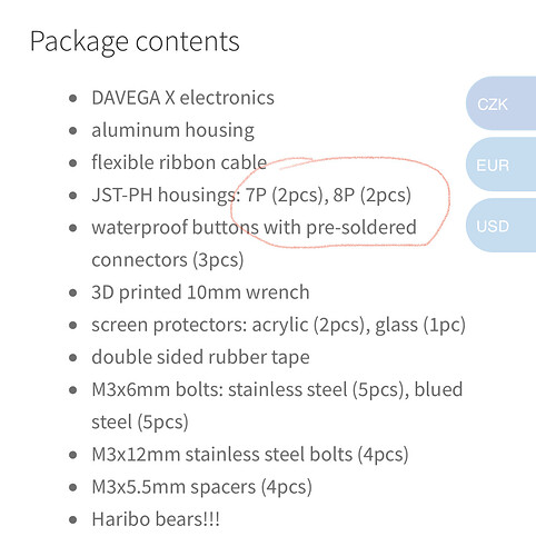

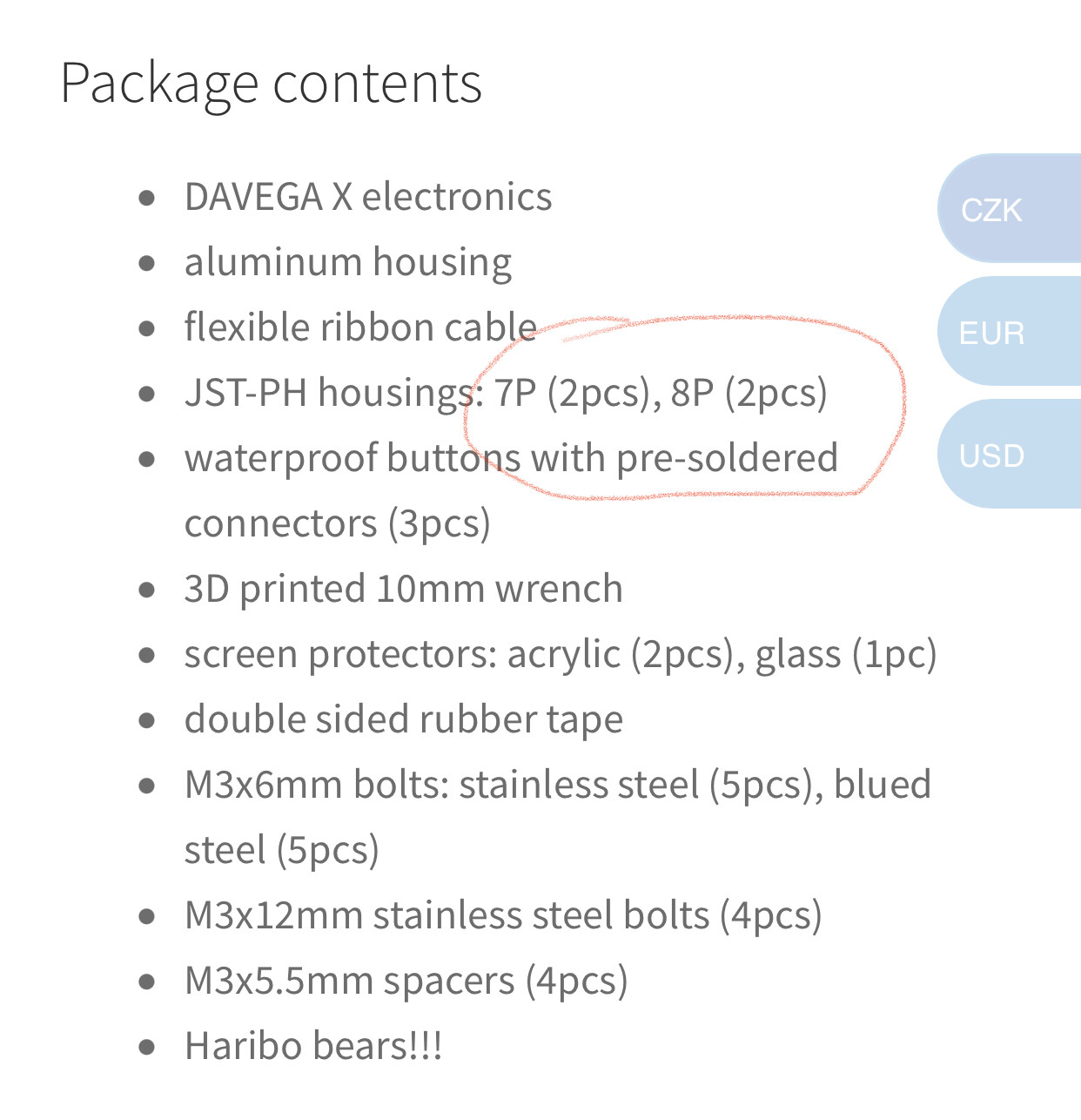

@janpom someone just asked me a question that made me realise something. What connector are you sending me with the kit I ordered? Do you guess, send both, or did I totally miss a dropdown for a “7 or 8 pin” option?
