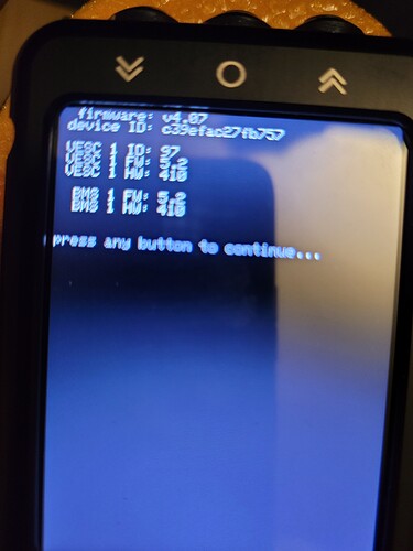

I got that to work, but my davega itself is having this weird issue. Happens on FW 4.6 and 4.7.
It also says I have a BMS connected… Which I don’t. I have a dual Vesc.
@janpom
Make sure none of your VESCs have the ID set to 10 or 11. Those are reserved for a smart BMS.
how do I change this?
In the VESC Tool or in whatever you use for configuring the VESC.

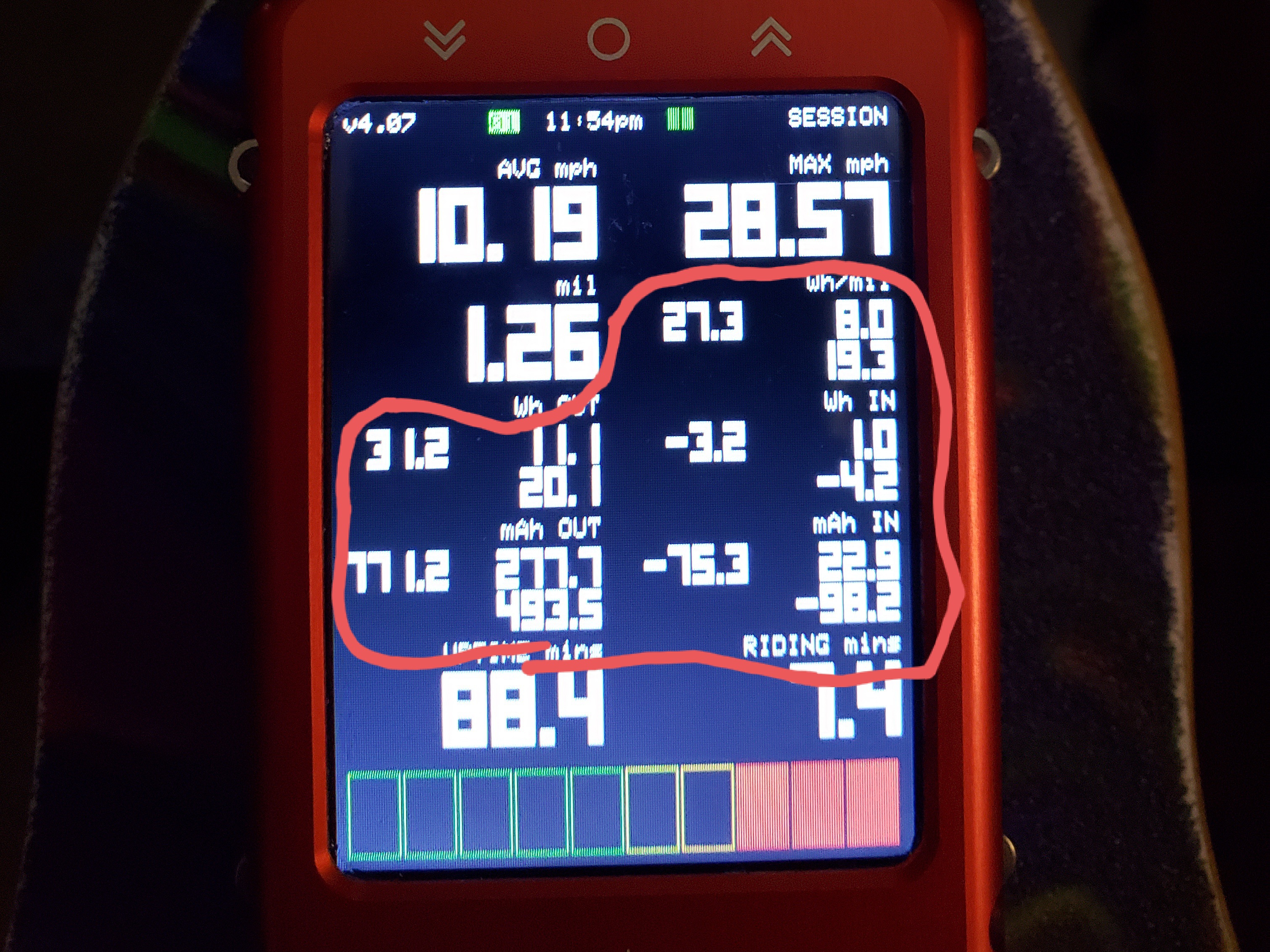

For each category, what are the different numbers representing? Per ESC, and total? Be concerned that Wh/mil is over double on the bottom than top? :thinking::thinking:
Ha! I had the issue reported by another user as well. What kind of VESC do you have and what firmware version?
And yes, you’re interpreting the numbers correctly and there indeed shouldn’t be that much difference between the two motors.
This is on a stormcore 60D+ with 5.03 beta 34 test firmware.
The other guy also has a Stormcore and running v5.2. Do you have any other device that you could use for cross-checking the values reported by the VESC? The energy discharged for each of the two motors in particular?
This was only one mile of data in a parking lot so far.
I’ll keep an eye on metr logs
