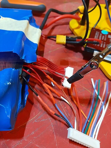

I have the Daly BMS and would like to swap for a Bluetooth smart BMS. Is there a direct replacement that’s plug and play I can buy? Or can anyone point to a guide for the simplest way to swap them out please?
The cleanest and most reliable way would be to open the pack and redo all the balance wires.
The next best option would be carefully cut and solder each wire one by one

Ew, fuck playing with hot wires. I’d much sooner make an adapter than either of those options
Its not so baaaaad if you go one by one
I’d be able to make an adapter quicker and with less butt clench. But that’s just me.
UR living large with your instock multiple pitch M/F 13 pin jst connectors
