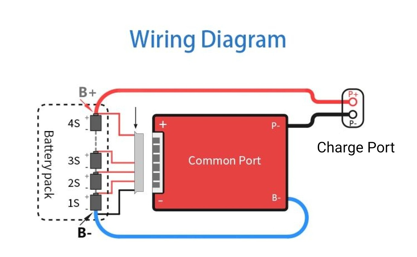

Building a bike battery and my daly just arrived from Ali. Wondering if someone can clarify the wiring for me. @BenjaminF provided a wiring diagram as below and the identica diagram came w the bms but most of the leads are attached to the POS cell terminals. Is this how everyone is wiring them? I would much rather wire balance leads to NEG terminals where possible to reduce the risk of shorts.
Edit: Also, I’m wiring for discharge through the bms. Don’t think that will impact the balance wiring at all but there it is.
The LLT has a similar wiring diagram to the Daly as per the website but you can wire it successfully as below and it’s def the preferred method. Wondering if something similar can be one w the Daly.
