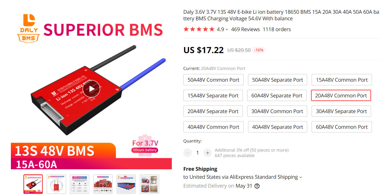

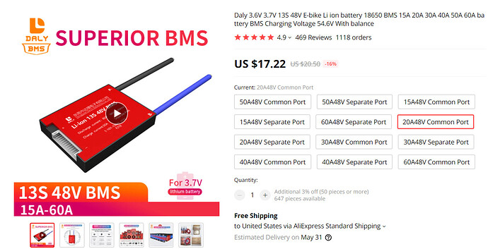

this is why ive been using daly 13s for my 12s builds and just shorting the last two balance leads.
Didn’t know you could do that, does it work with every bms ?
It works with Daly bms in my experience. I’m not comfortable saying anything about other BMS’s but in theory the bms is tricked into thinking group 12 and 13 are perfectly balanced with each other.
But the bms has an undervoltage protection so if it’s made for 13s won’t it be weird for it because the voltage will be always low ?
The under/over-voltage is based on the voltage of individual Pgroups. So it won’t matter.
Ho okay, I thought it also measure the overall voltage of the battery
Yeah, I can’t think of a reason to do that from the perspective of the BMS.
Yeah I agree, more hassle for an useless info
Good thing to know, it’s a nice trick
This is the model I use
