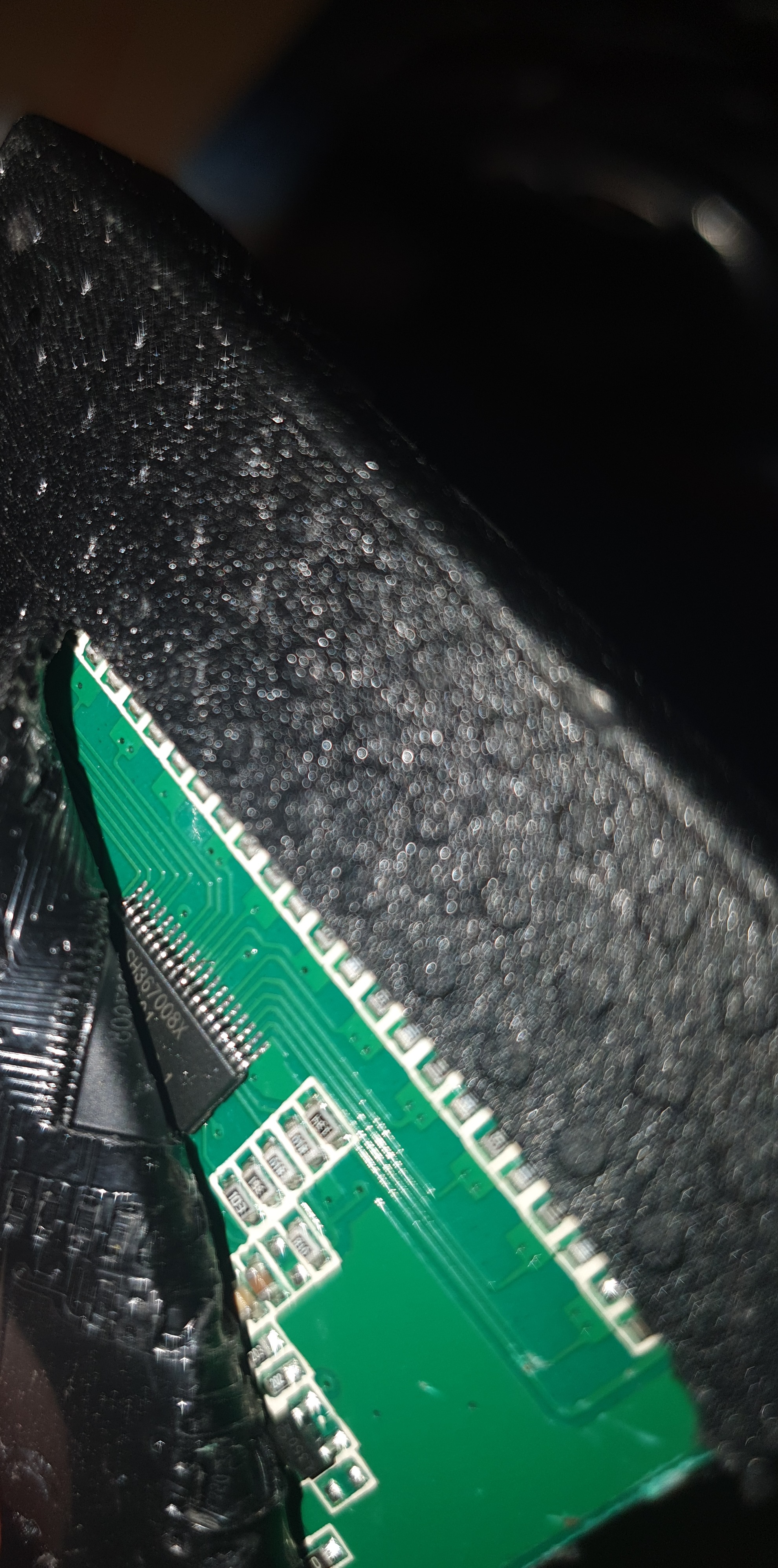

I just got a couple new 10s BMS. These have what I assume is an antenna? What are these?
Temp monitor?
Not sure but unlikely, this is not a smart BMS
I have seen plenty of dumb BMS with temp sensor. They can turn off the discharge based on a preset temp.
Definitely a temp sensor.

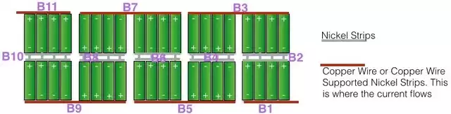

any diagrams of a bypass daly 10s common port with charge port?
Got no diagram but hopefully pics will help. The main negative is on the bottom right, and it goes in a S pattern. Blue wire goes to the main negative, and the black wire on the BMS goes to your charge port. Positive from the main B11 goes straight to your charge port

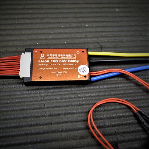

For a 10S5P 30Q pack, would most here recommend a “charge only” BMS or discharge as well?

I (and most others on this forum) recommend a charge-only BMS. Running the full pack current through the BMS is a really bad idea, even if you think you are buying a BMS that is rated for it.
@GnomeMeansNo put it really beautifully in a recent post: Would you be comfortable installing a system in your car that cut your brake lines if you press the brake pedal too hard?
If you are wiring your BMS charge-only, then the e-switch is going to do nothing (since your ESC is being powered straight from the battery, the BMS has no ability to cut off power to it). You would need
either an external antispark switch, a loop key, or an ESC with a built in switching function like the Stormcore.
