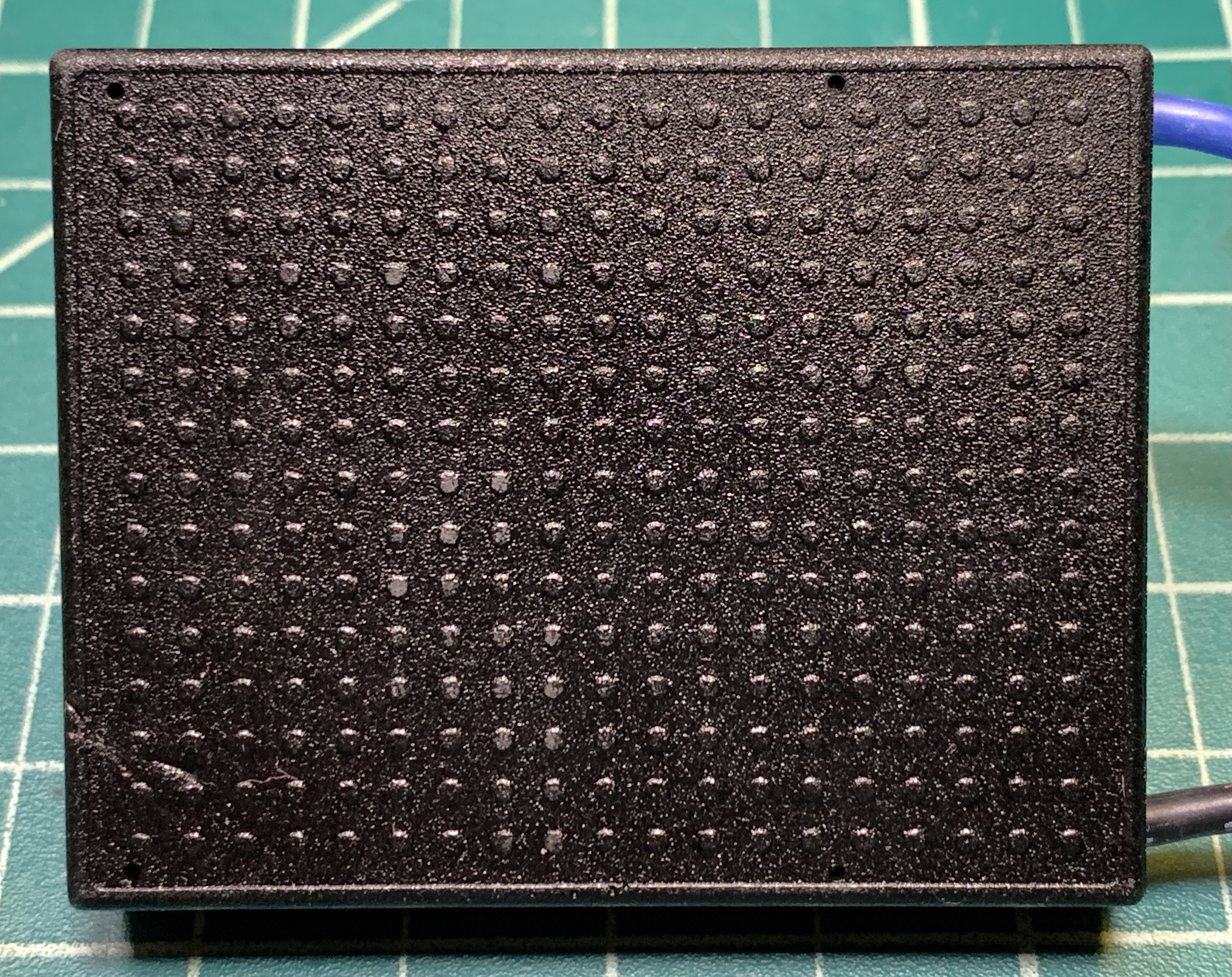

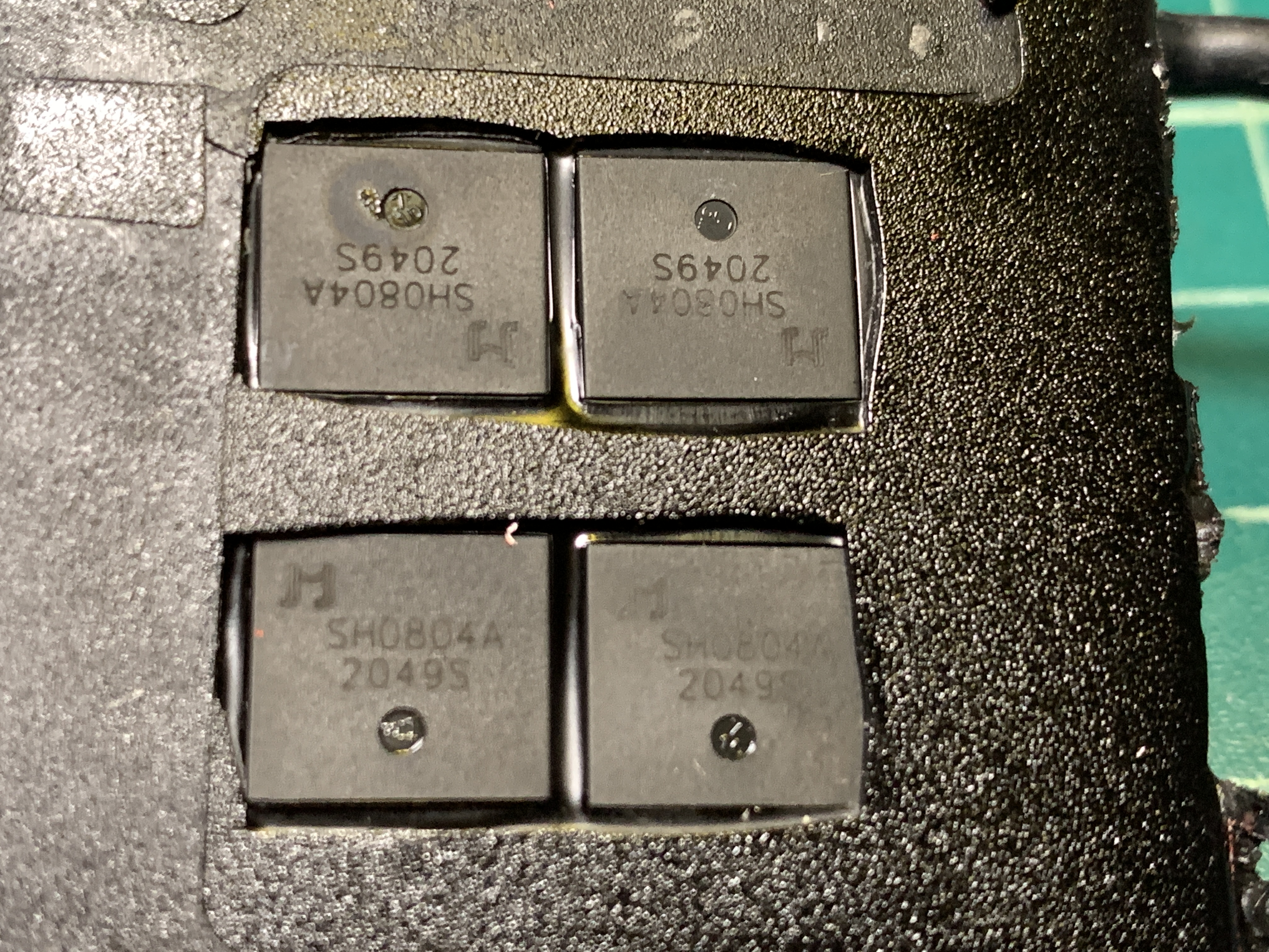

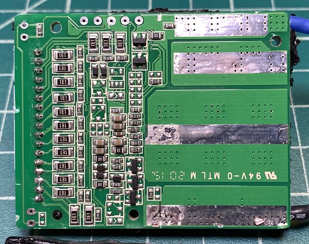

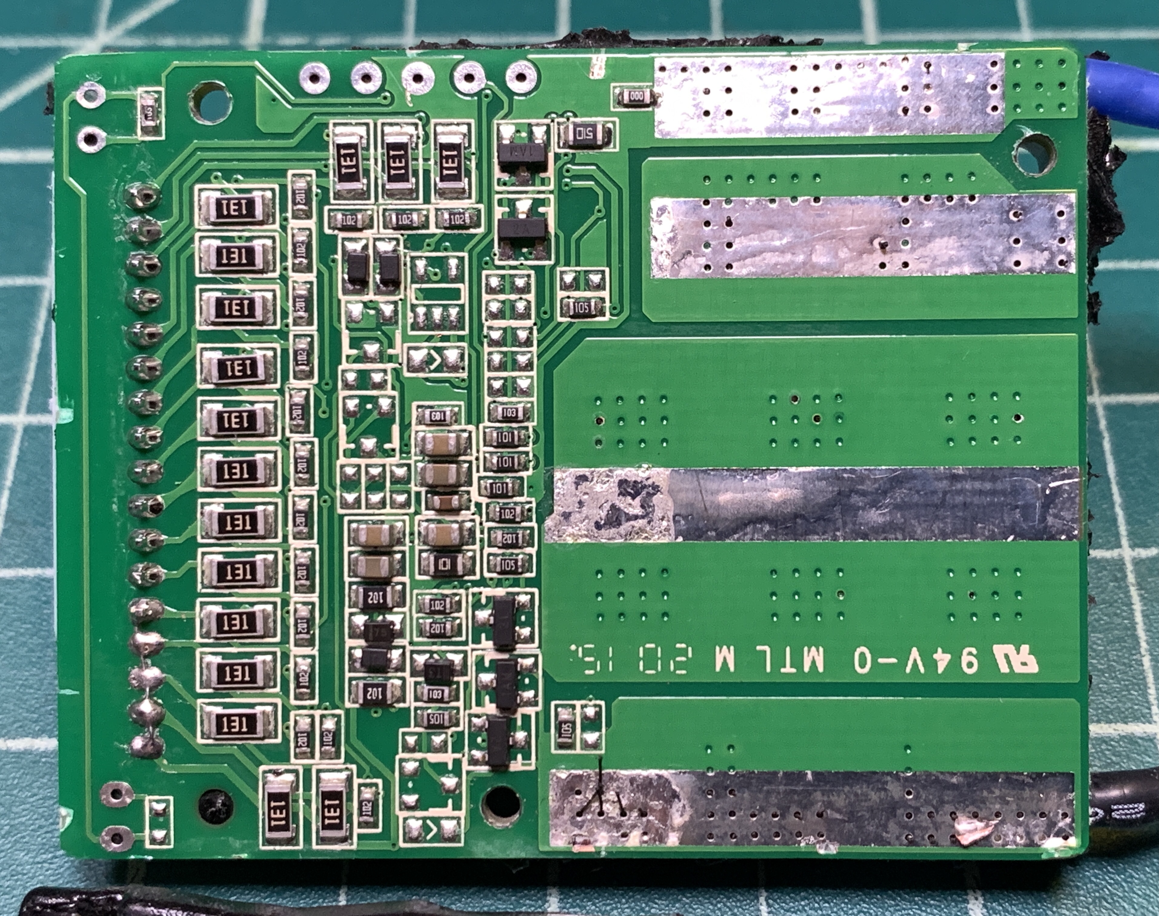

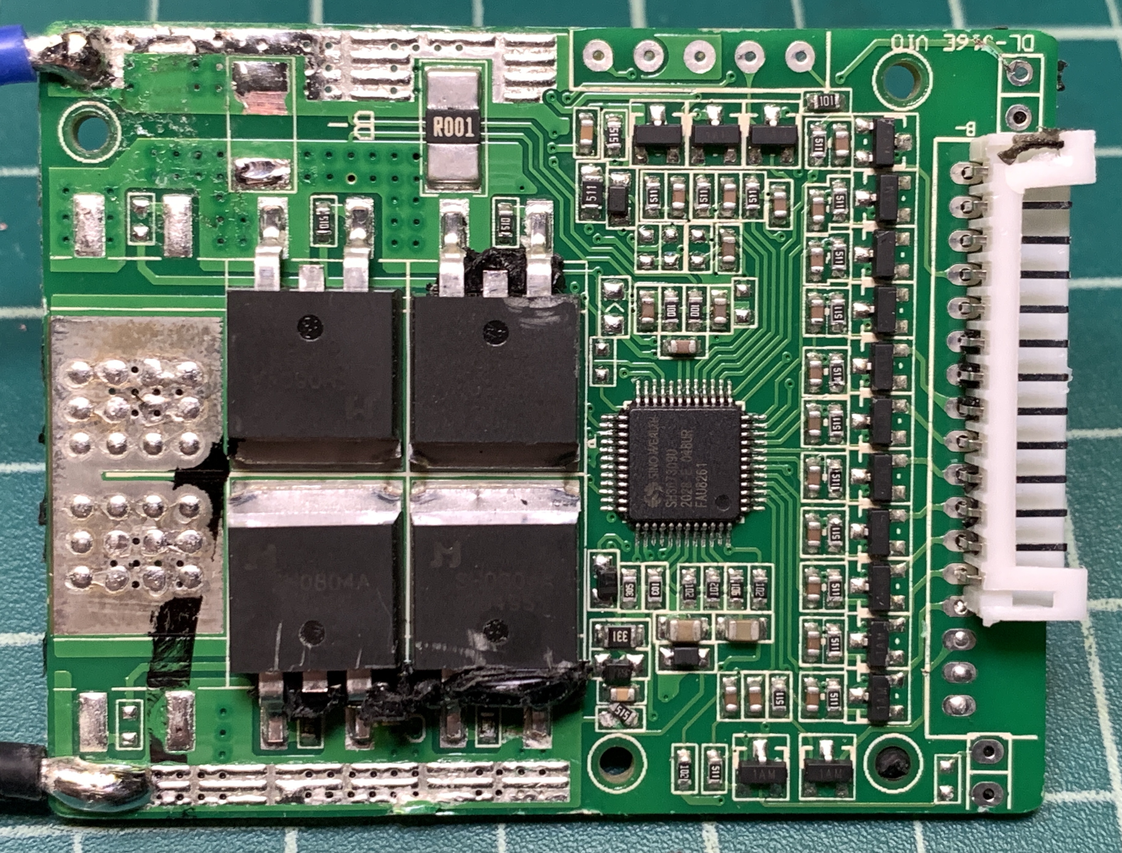

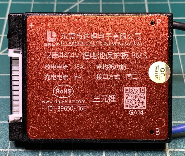

Daly GA14 teardown, received blazingly fast from @BenjaminF.
12S Li-Ion, 15A discharge, 8A charge.

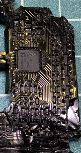

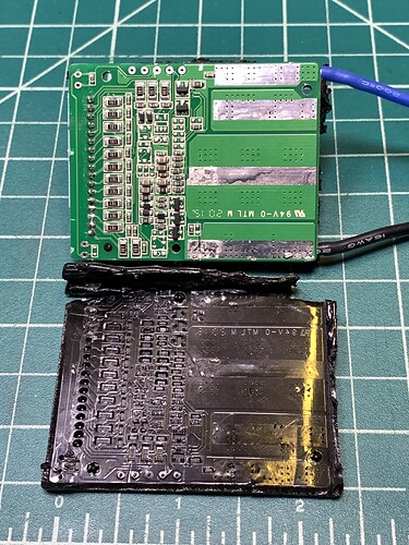

damn, this part :eyes:
Very cool injection molded chunk. :grin:
Even picks up the printing on the components!
How did you het them open so nicely?
I had to solder a longer cable on one of them and Used the swearing and hitting it to get it open and then damaged a bit of the pcb so it went to the scraps box
Years of practice tearing down products from the competitors of my clients. :slightly_smiling_face: It’s mostly just patience though.
I did plenty of damage to this Daly if you look closely, i.e., I was not patient. I would have taken at least another hour if for a client.

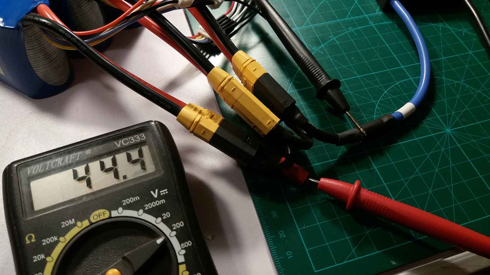

@JoeyZ5 I have a 13s Daly BMS which I wanted to use for 12s. The seller said it’s working on 12s, too but it didn’t. Then I had a conversation with Daly and they said it’s working without connecting the last balance wire like the seller said. They also said don’t connect 12+ and 13+ of the BMS to cell 12 because I asked if I shall do it. Anyway then I connected both 12+ and 13+ connections of the BMS to cell 12 like it works on some other BMS. Still not working. With not working I mean the voltage output of the BMS was wrong, not even close to real battery voltage.

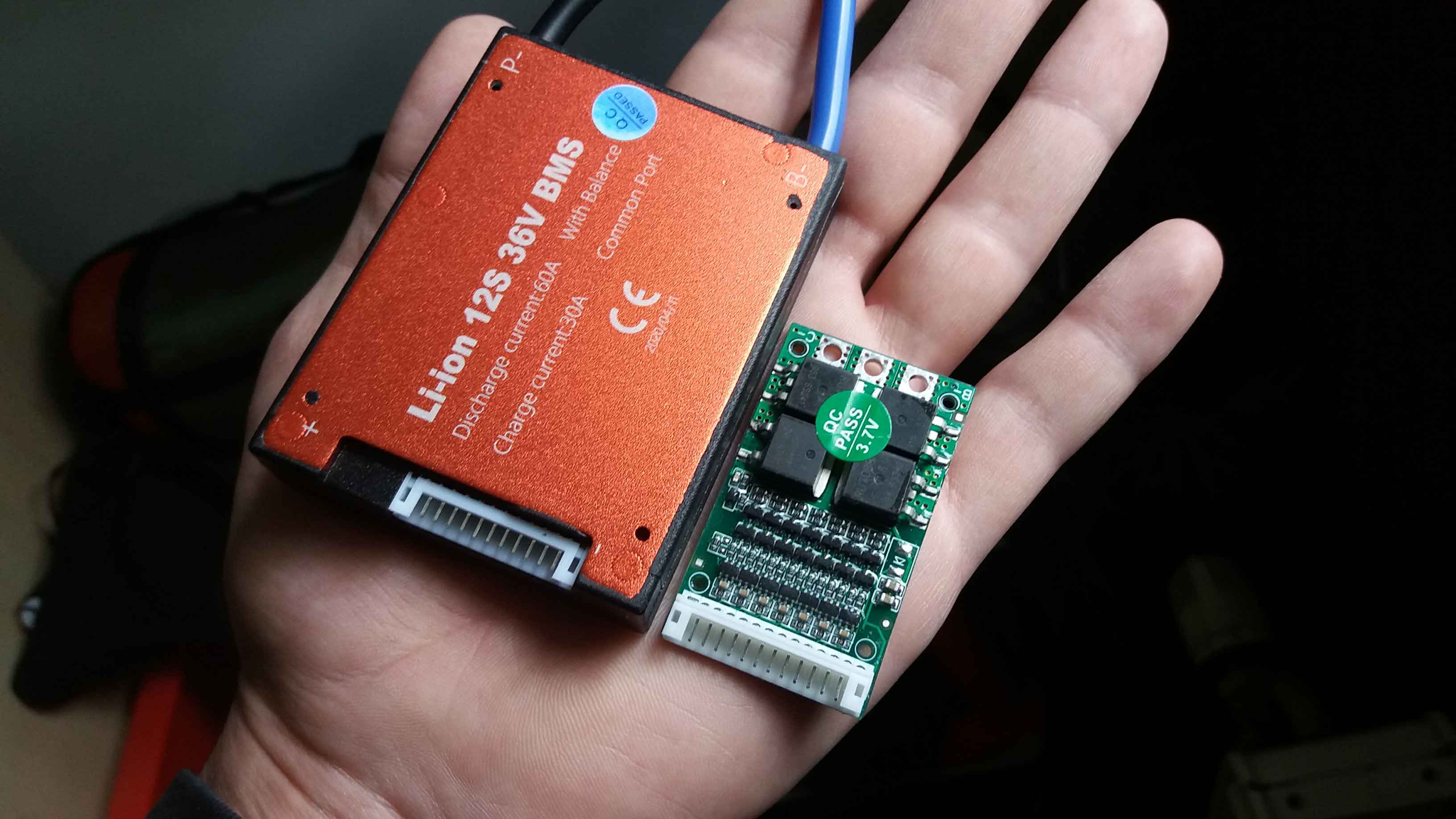

Meanwhile I bought a 12s Li-ion Daly BMS, labeled with 36V :joy: I hope it works.
I was told many times but I never actually tested it.
All the BMS I own have the extra pins shorted as you say. That’s why I connected it first like this.
I found the pics, here the battery voltage
and here the output voltage of BMS no matter if pin 12+ and 13+ are shorted or not.
It seems the BMS I got is faulty. :man_shrugging:
This is probably lifepo. Chinese brands love throwing every related word into the name of the product
Don’t shock me :pray:
Just realized it’s not Daly but similar, sold as 12s Li-ion BMS. I hope the 36V is a mistake and you are wrong. Not sure how I could check if it’s lifepo but I guess the BMS would not charge in this case.
Ah, yeah, i got screwd once, they are lifepo
