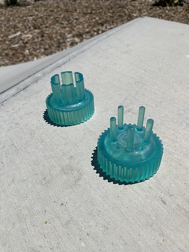

Custom printed pulleys are up for sale!
FDM nylon
Yeah just saw the picture
Resin might do better as they don’t have the layer adhesion problem in the Z direction and the Blu resin has roughly 50% higher tensile strength.
But I agree still super sketchy.
Maybe try printing the spokes seperatly at an orientation where the layers are 90deg to the shearing force?
nah, just better off not using FDM plastic I think. that will introduces other issues. like weirdly shaped teeth. weaker teeth, a pulley that is not balanced, support structure on teeth and so on so forth.
I’m starting to test with partially flexible resins now. They should behave similarly to something like sintered nylon.

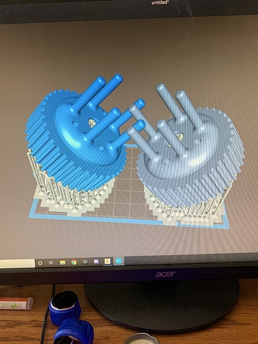

Kegel press fit / bolt on design update. Stronger and can be printed in pairs!
(Excuse the messy desk)
What printer are you using? :grin:
Upgraded anycubic photon. I’ve given it a lot of work and it works much better than it did when I first got it.
Cool! What upgrades did you do?
I replaced the linear rail to a higher quality one, put in nonFEP film to the vat, and added an external heater and an extraction fan.
