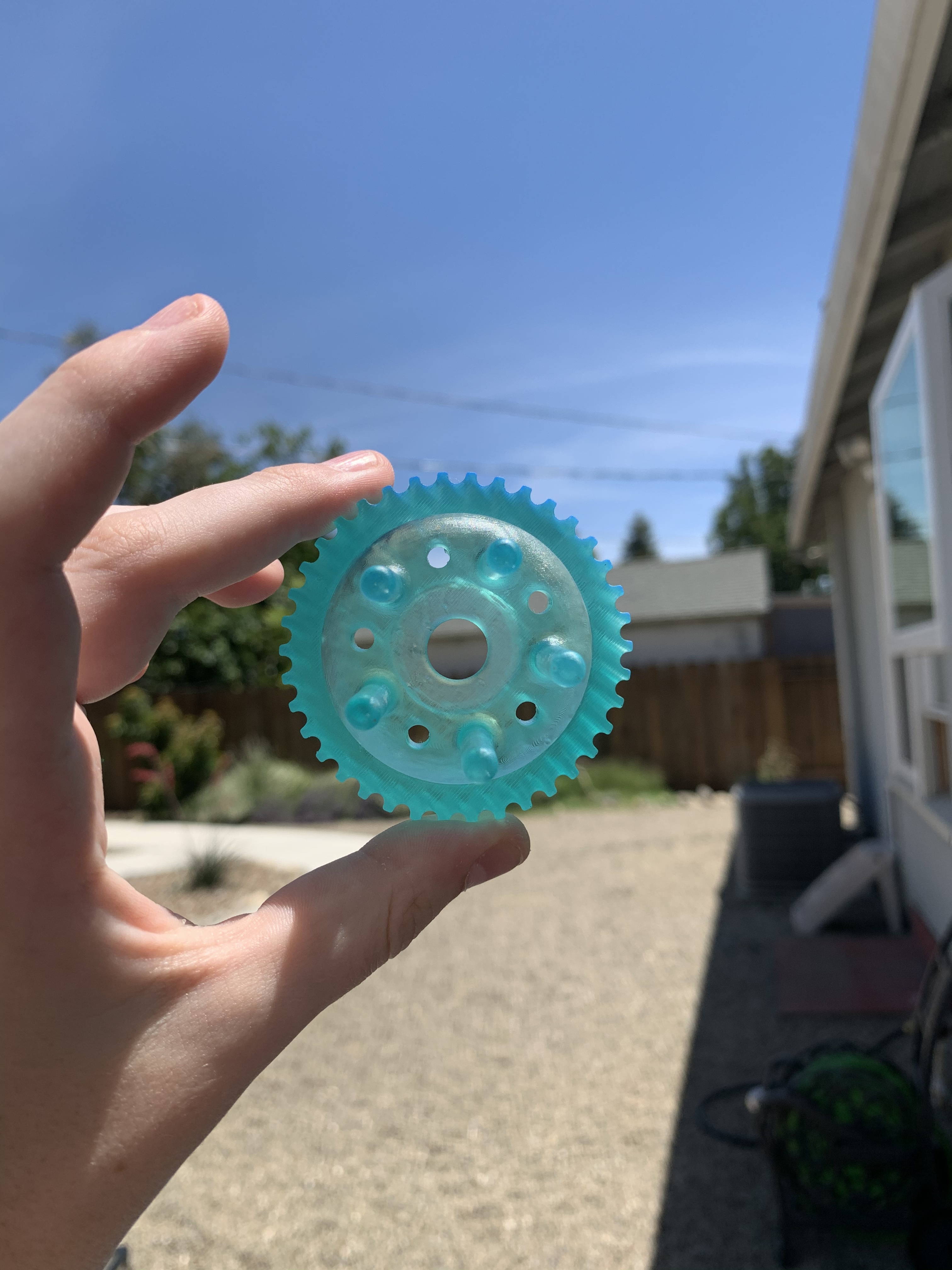

Custom printed pulleys are up for sale!

Why not use screws instead of these ‘‘pins’’? weight?
also for the fdm printers screw reinforced parts are nuts
The kegel pulleys use the pins to keep them centered and aligned but there are holes in between each pin to allow for bolts to go through.
Just did another 20 miles today on my pulleys today. They’re showing no signs of wear so it’s looking good!
Yeah this is what I do, I haven’t had any of them break, just the teeth wear down and eventually break
Another 14 miles today. I don’t see any wear at all on the pulleys so all is good!
For a wheel pulley, resin may last virtually forever, if nothing gets in the pulleys…
For me, plastic pulleys have a downside in that they’re softer, so if any rock gets jammed between the teeth, the teeth are more subject to wear or even worse, the rock can wedge itself in. Aluminum is just hard enough to prevent this.
I’ve tested with this by doing heavy off roading and while I noticed rocks being flung up and hitting all over the pulleys I didn’t see any issues with chipping. I’ve been slow curing my pulleys to allow them to cure more evenly and this seems to really work a charm.
Time will tell. A few thousand miles can bring the unexpected.
Om sorry but I have to agree 50 odd miles is what what many people do in two three days. I would hang back and relax and ride the shit out of them. Get a pulley or two out to friends but selling that’s too early. My opinion anyways.

I think your teeth will be okay for over 1000kms but those kegel pins might break under heavy braking.

Those kegel pins are mainly for alignment. There are bolt holes in directly next to each pin.
