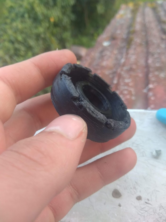

@Printedprecision I really appreciate your effort and I wish you best of luck with this. Resin prints ARE indeed much stronger than FDM, we know this because of the aforementioned reasons. However, I agree with some others when they mention the testing. My FDM pullies didn’t even start to show tooth wear (ABS) until about 100 miles in. After that, they wore quickly and some of the teeth broke. While I don’t think the resin will wear quite the same or have the breaking issues, I would heed the advice and get some more quality testing in here.

There are loads of test with resin vs FDM printed parts if you google around. The issue with printed pulleys is not that they break but rather the tooth wares down. I would assume however that a FDM printed Nylon would last longer, because of its toughness and slippery nature. Blue is stronger but also way more brittle than nylon. I have used printed pulleys for the past 2.5 years or so. The ones I’m currently using has about 700-800 km on them. And are still more than usable. Will probably use them for another 300-400 km before I swap them out. And that will be because of the rapid belt ware.
And like anything there are loads of factors when it comes to how long pulleys will last. Belt width, Tooth count, belt tension, the amount of dust, sand gravel and crap you roll over and get in to the drive. And most importantly how aggressive you ride. I’m on a street setup, riding mostly on roads doing 50-60 km/h most of the time to keep up with traffic.
