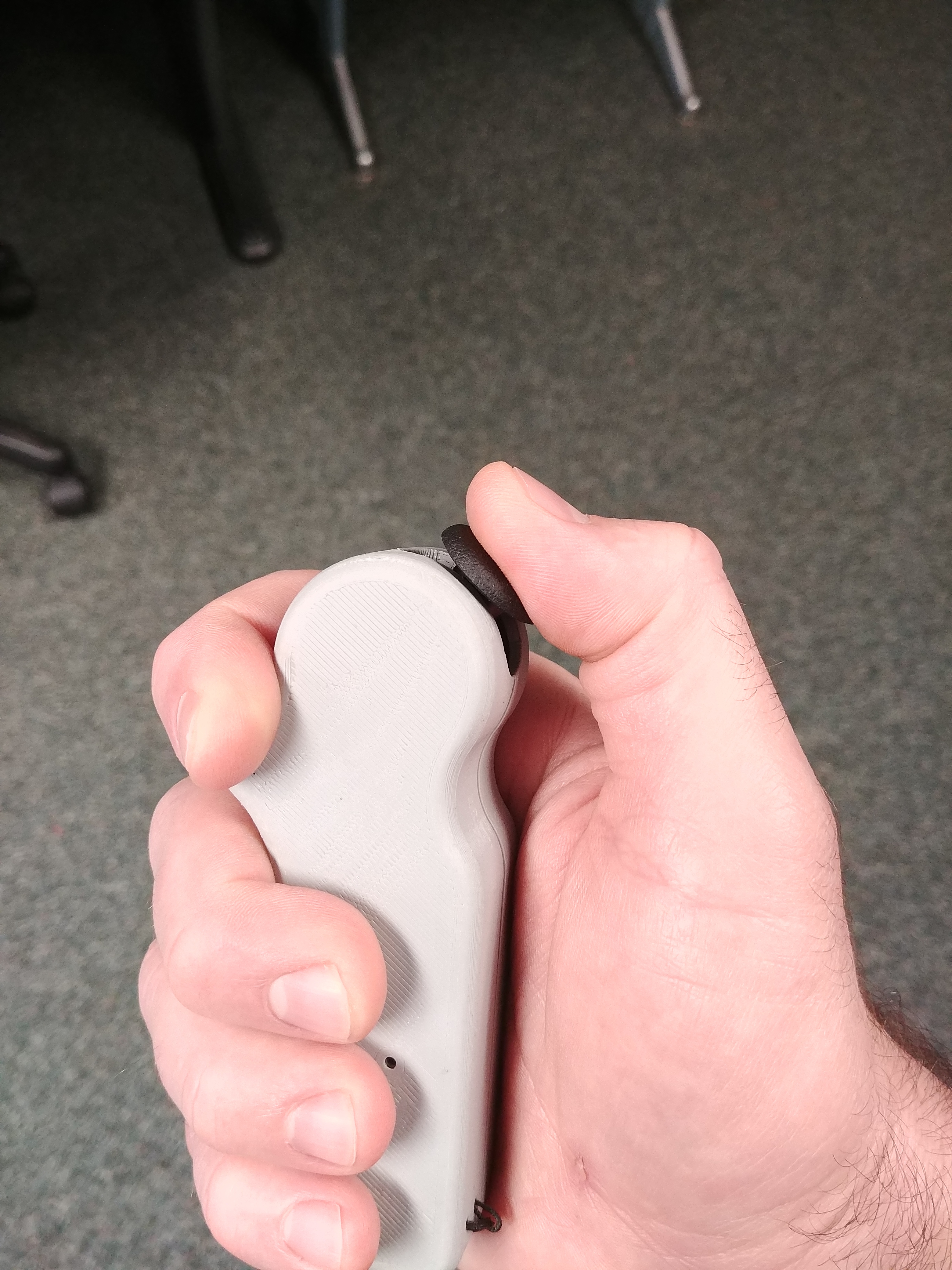

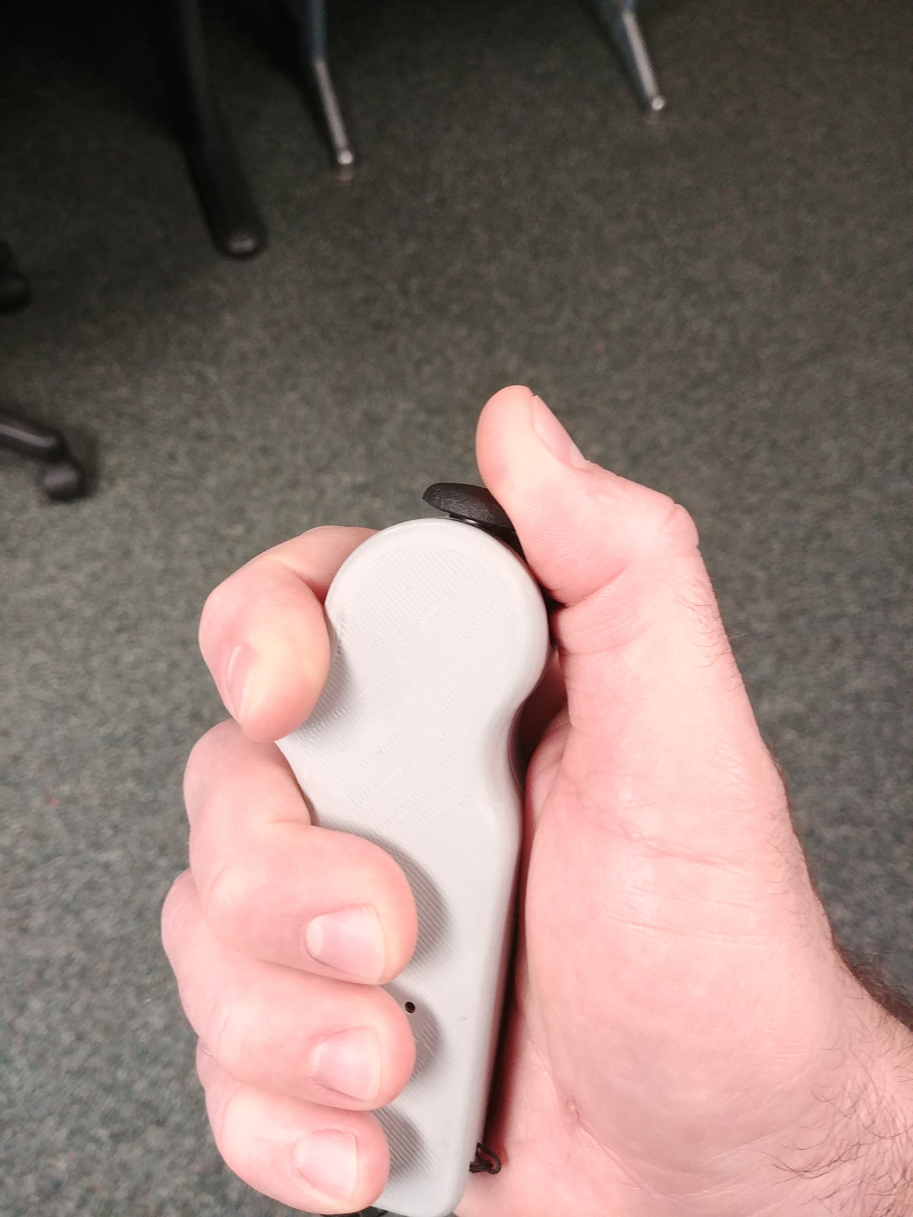

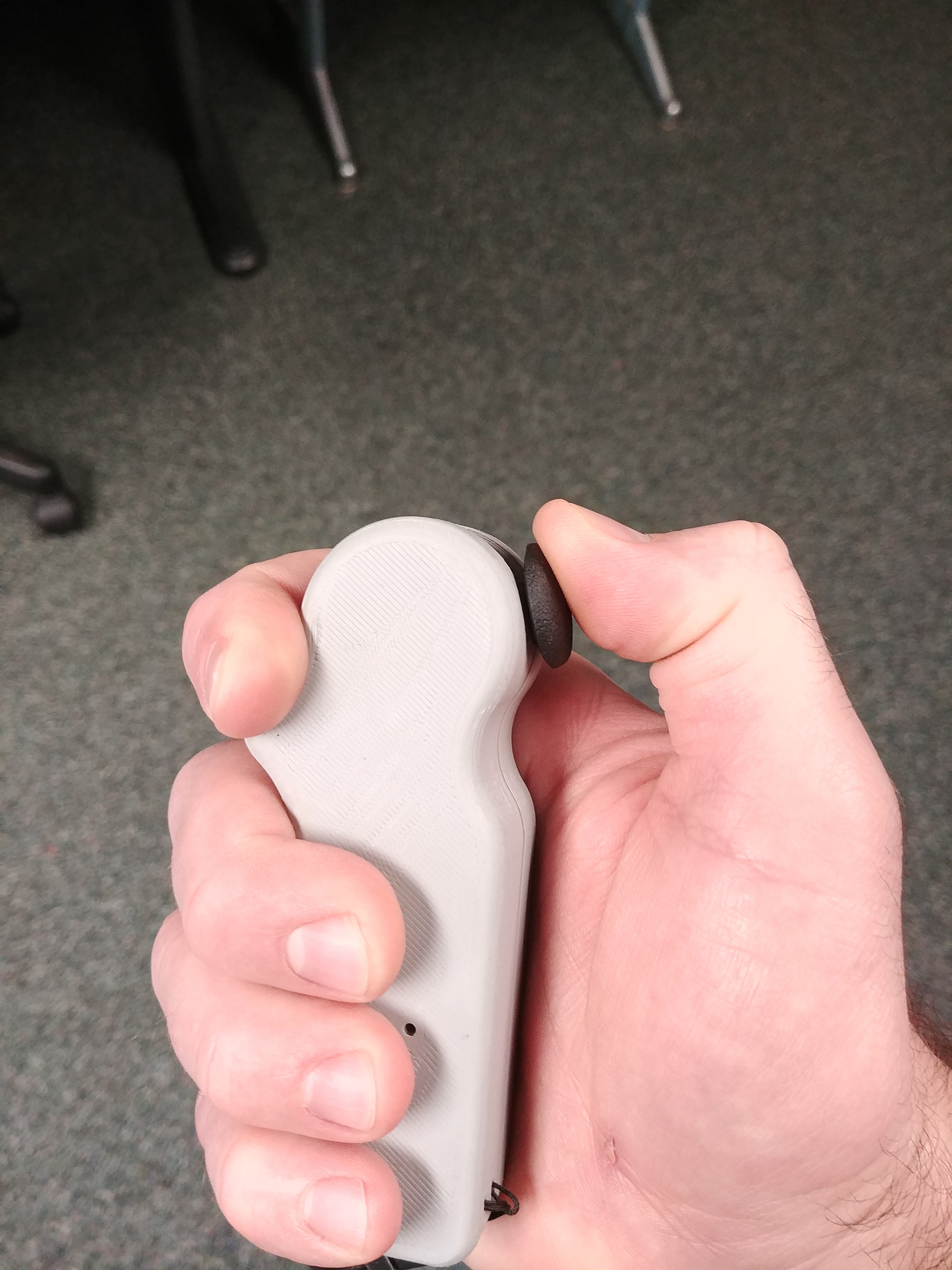

My first impressions are unfortunately not great :frowning:
Use wise for me that is. Design/print is perfect. I really just think it’s the size of my hands. I feel like the joystick wants to be flipped 45* back towards my thumb from the center of the pot.
Forward on the pot is fine… but my thumb just doesn’t seem to sit in a way where I can finely control breaks. Also, the resistance on the pot is much less than I thought it’d be.
That is however my impression from feeling it and not actually riding with it though. Should hopefully be able to ride with it by next weekend.
@dani is it possible that you could release several versions of the .stl that have the pot clocked at different angles? Probably not a huge deal, so if it would be difficult and there isnt much demand, then dont worry about it :grin:

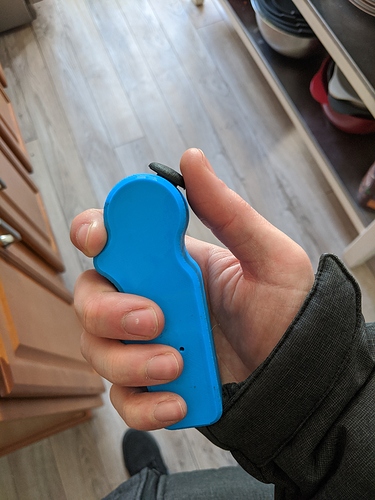

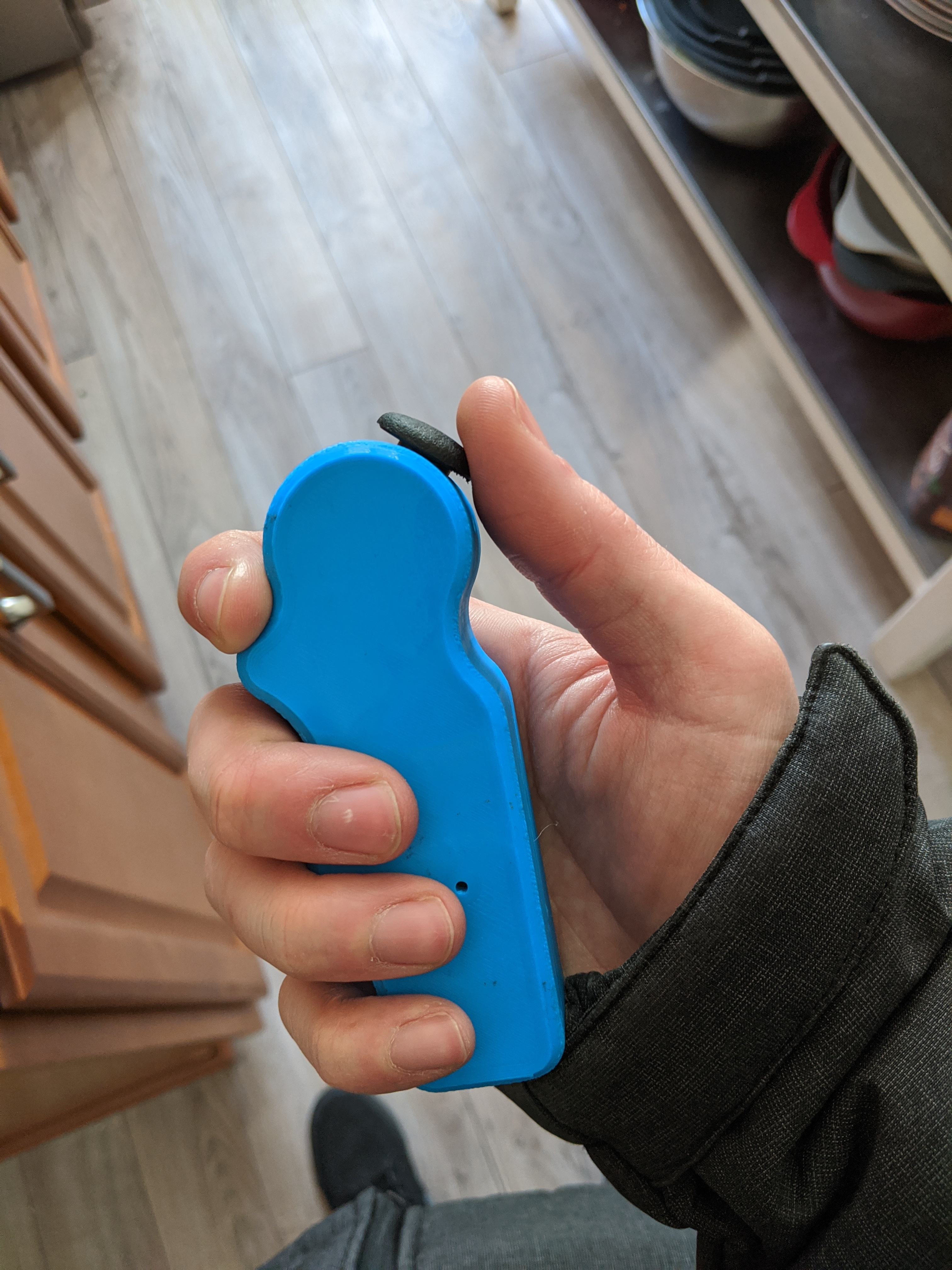

After riding a bit, I am noticing that I am not using the real estate of the gigantic thumb pot, but instead I seem to find myself pushing on the edge for throttle. Maybe I am holding it wrong, but it does seem like it could benefit from some angle adjustment
I was gauging my hands, when in the middle.
Some shifting is bound to happen, but the middle is mostly engaged.
