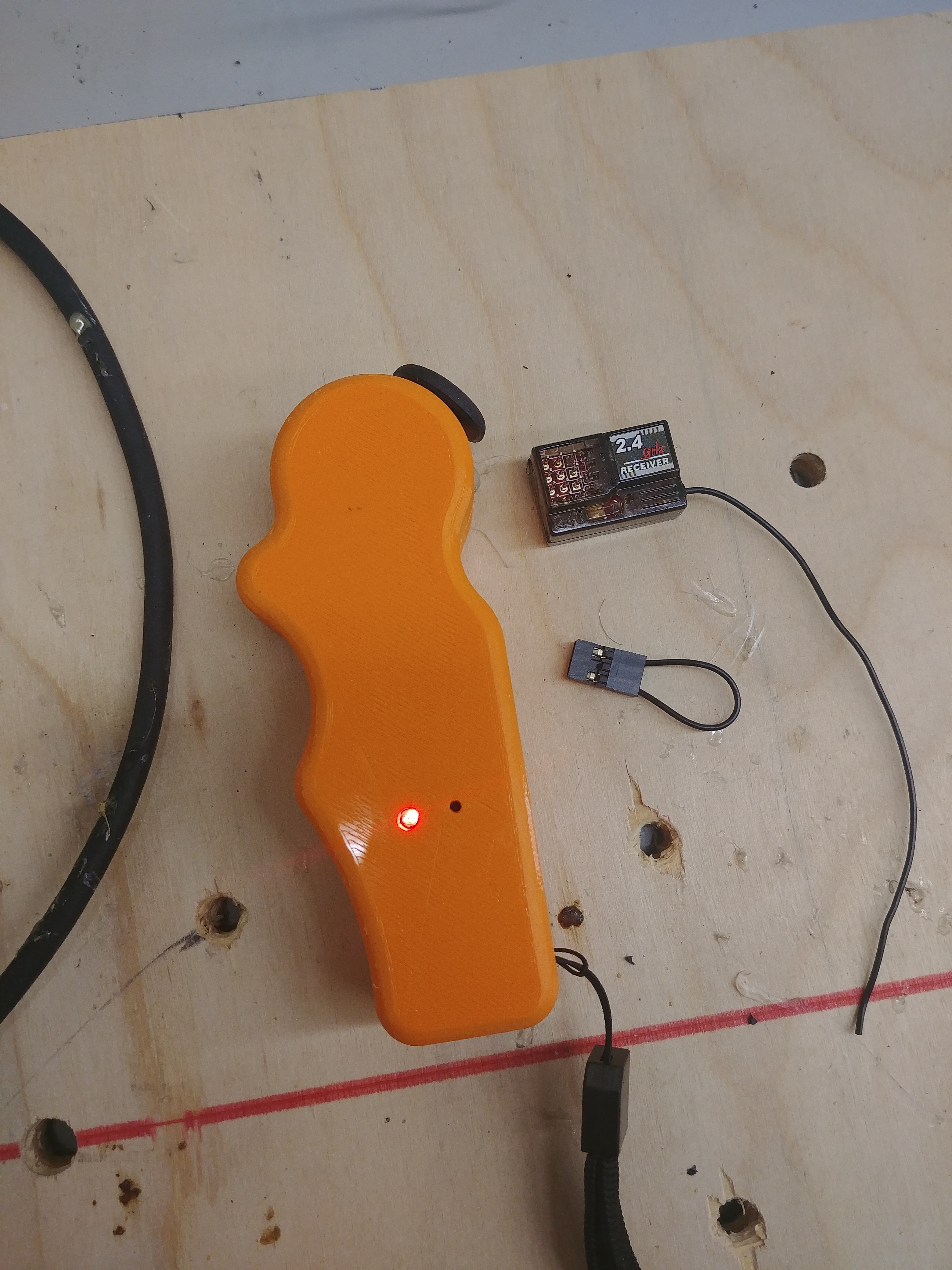

Just put it all together, does the red light turn on when it’s tuned on?
Yes, 10minis

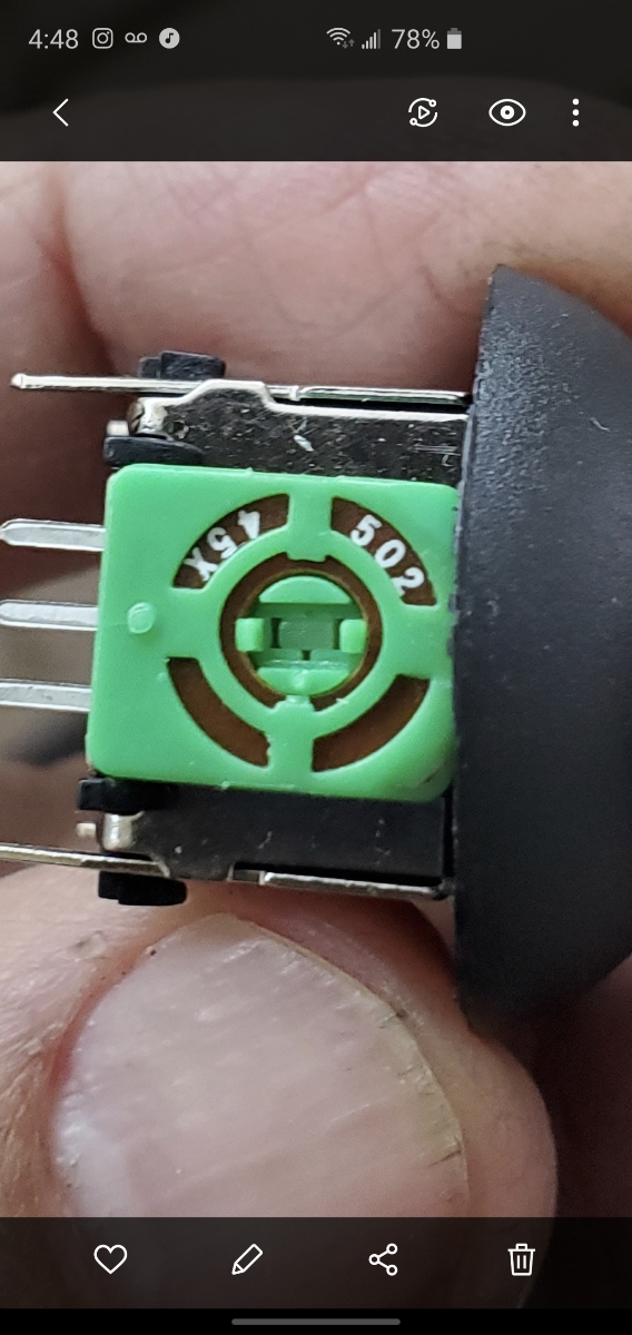

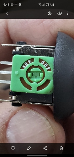

I set up my chubby with a 502 45x potentiometer. I just found out I am meant to use a 502 60x potentiometer. What is the difference and can I still possibly use the 502 45x?
… wut? Those the ones I sent?
Nope… The ones Ed had :stuck_out_tongue_closed_eyes: The ones you sent are at Ed’s so I can’t grab em and check
Nvm… The ones you sent were also 502 45x :man_facepalming:

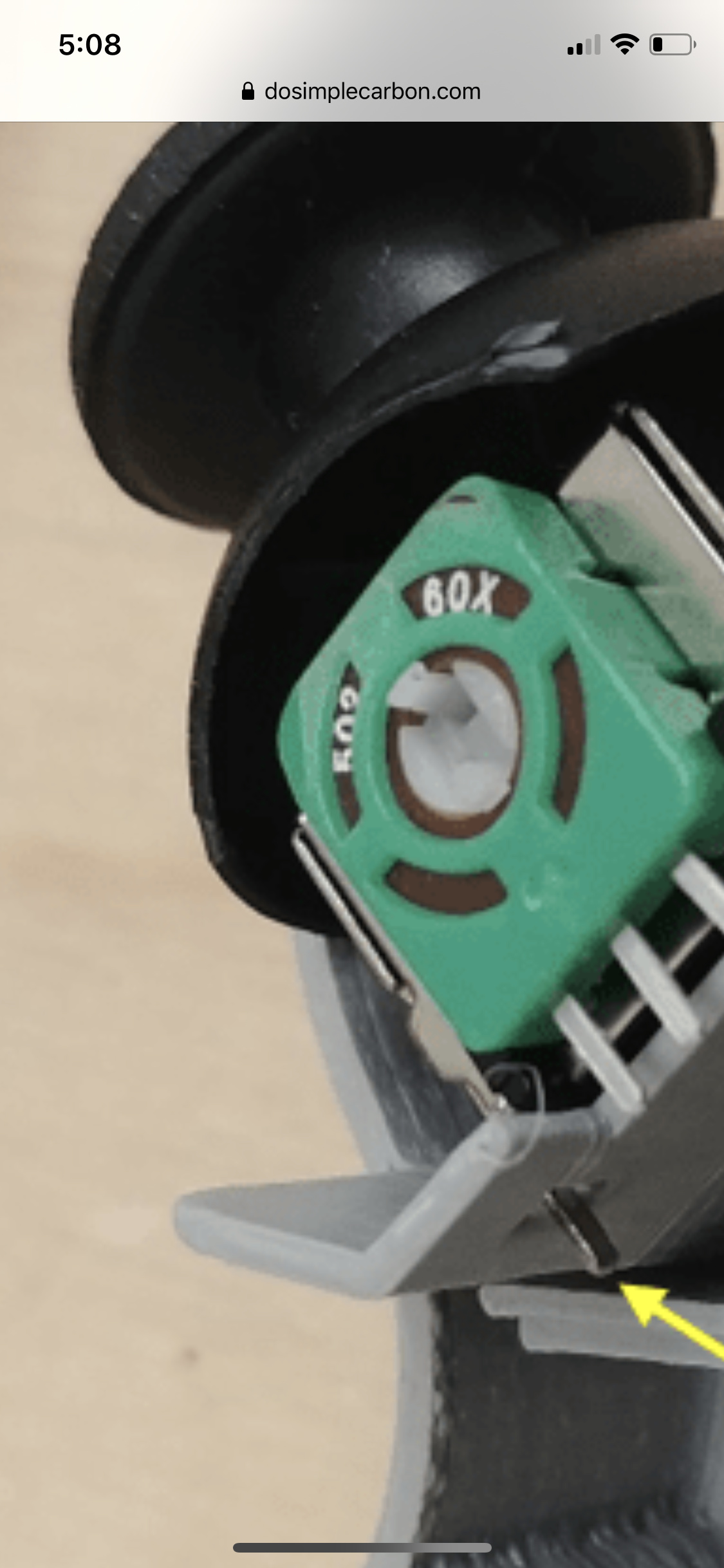

Where are you seeing it should be 60x?
Hmm… I see on Dani’s pot pics…
I wouldn’t worry about it :wink:
Could be sensitivity/throw stuff tho.
That’s Dani’s photo
Here is the pot you sent
I have no idea
But curious to know
