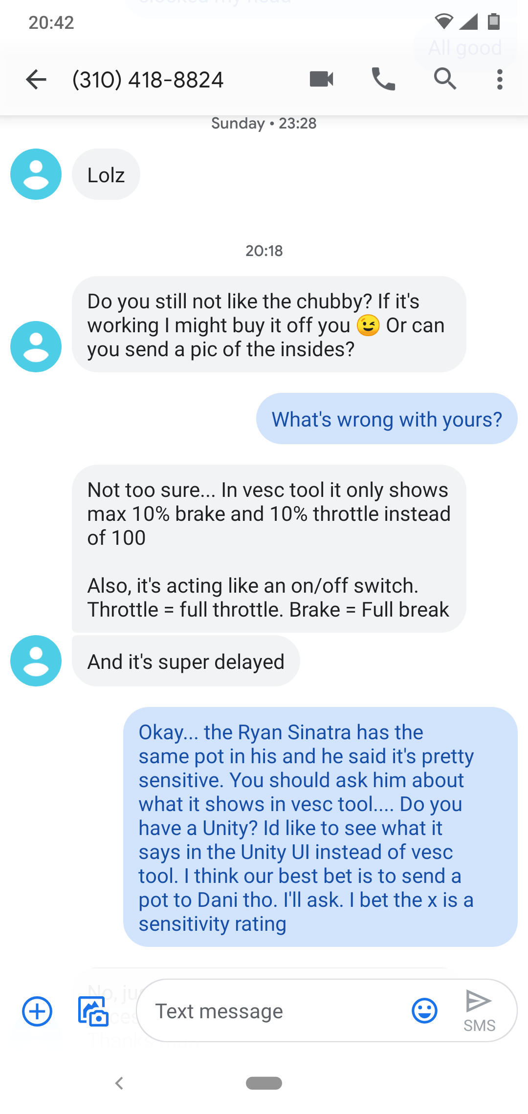

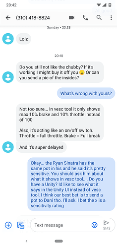

I think our best bet is to send a 45x pot to Dani. Everybody having issues seems to be using one, and the issue seems to be one of throw sensitivity.
I have a single pot. Can self sacrifice of necessary. @dani , if we get one to you are you able to do a bit of troubleshooting against your 60x? I’m making a presumption the x value is throw sensitivity. Can send a mini as well if needed… for the sake of science IG
I think @DEEIF has the same issue as @ryansinatra - could you post your calibration values?

I had no issues with mine as you saw in the video.
The 45/60 difference might be just the reason.

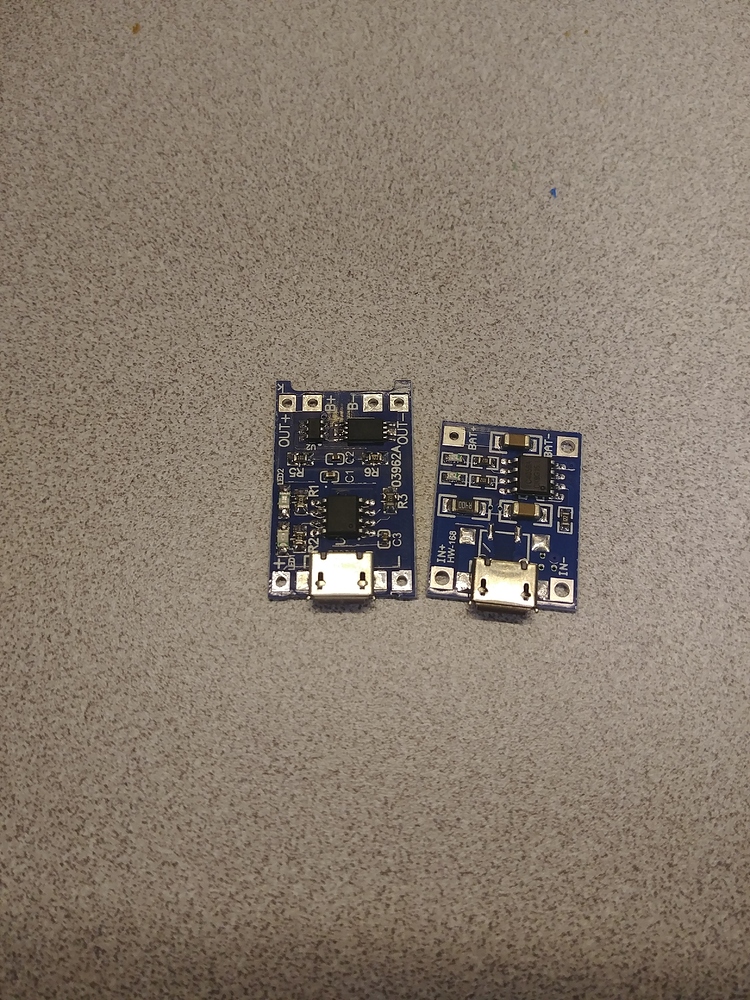

Hey @dani and @midlifecrisis , did you ever find out if the in + and in - ports where the ones to wire to for discharge from this 1s board (on the right)?
Or would you just wire it to the battery terminals?
I was leaning towards the latter seeing as the design of the larger boards terminal pad locations for the battery power and discharge pads seem purposefully close to one another…
I checked it recently with the Chilly.

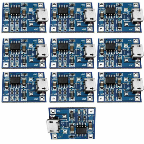

My understanding is the smaller one is only a charger, whether the bigger one has also some discharge protection.
The +/-IN near the socket do nothing, maybe some monitoring signal.
For the chubby I recommend using the one on the left as it will also protect your cells. The closeness of the pads is no problem if you’re careful with the solder.
Edit: with the smaller one the discharge go straight from the battery
Oh so the larger one has a discharge protection to avoid over-discharge of the cells…

I ran my old hook remote dead a few times with the smaller one and when I plug it to a charger it charges so I assume it protected my lipo but I might be wrong.
Correction. It is a charger only.
I measured on one of my minis – it stops working around 2.4v. Next time you run it dead, check the voltage. 0v on the output means cell protection kicked in.

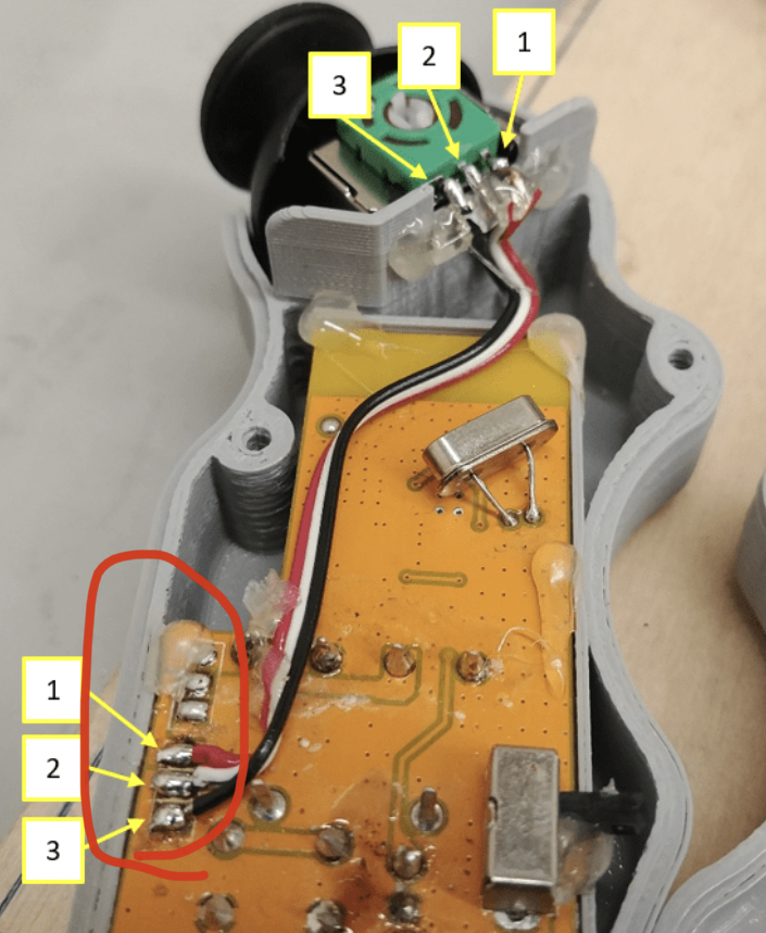

I had also wanted to know if the potentiometer wires/pins where needed to go to the lower sensor port. This confused me because these wire ports you have shown where used for the steering unit of the mini controller, and not the throttle… any word on this @dani ?

You can choose either, just use other channel on the receiver.
