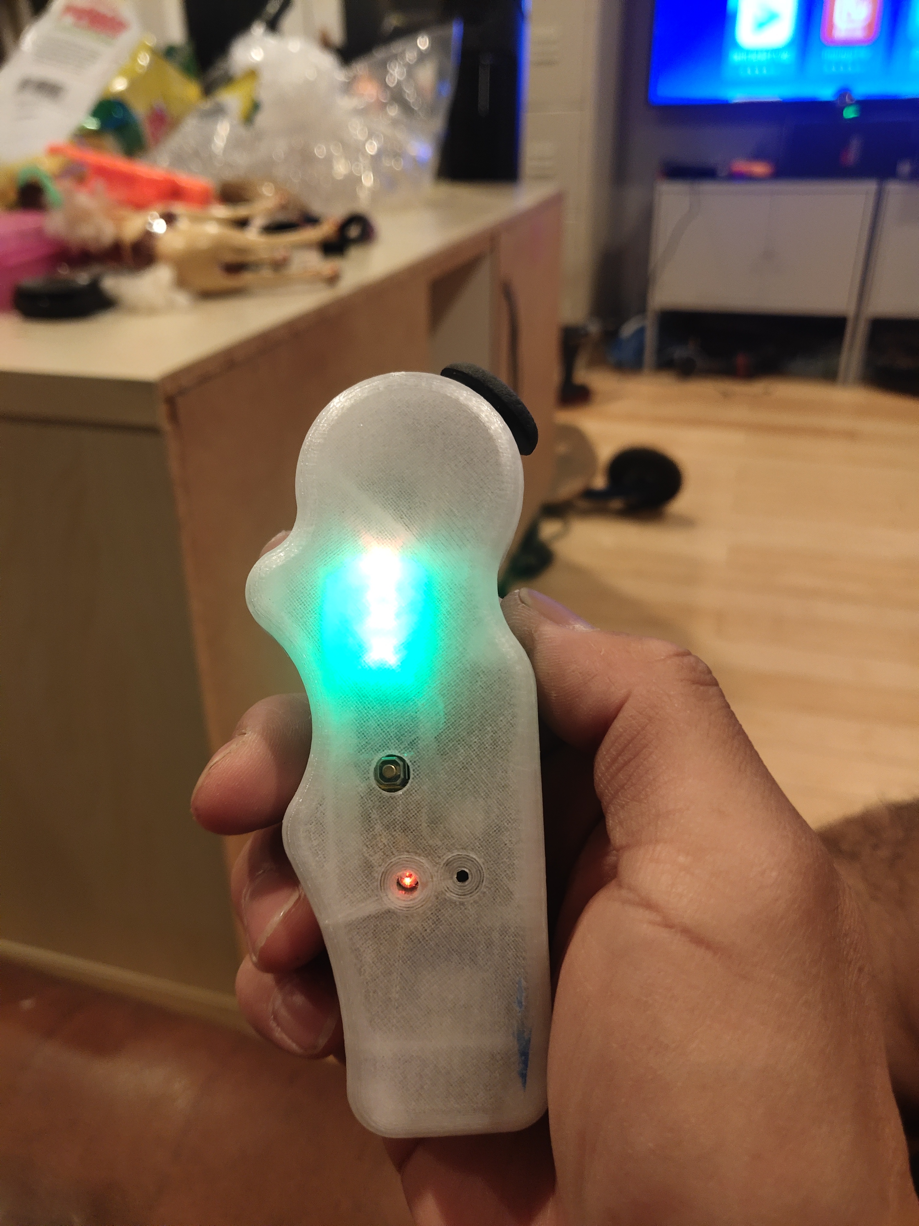

I built my second ch
ubby this evening and was able to find space to put in a led battery monitor. Very happy. Thank you dani…
Looking good!
How’s the throttle?
No. I built 2 chubby and none of them have any problem with throttle.
Excellent!
I’m happy that you like the design

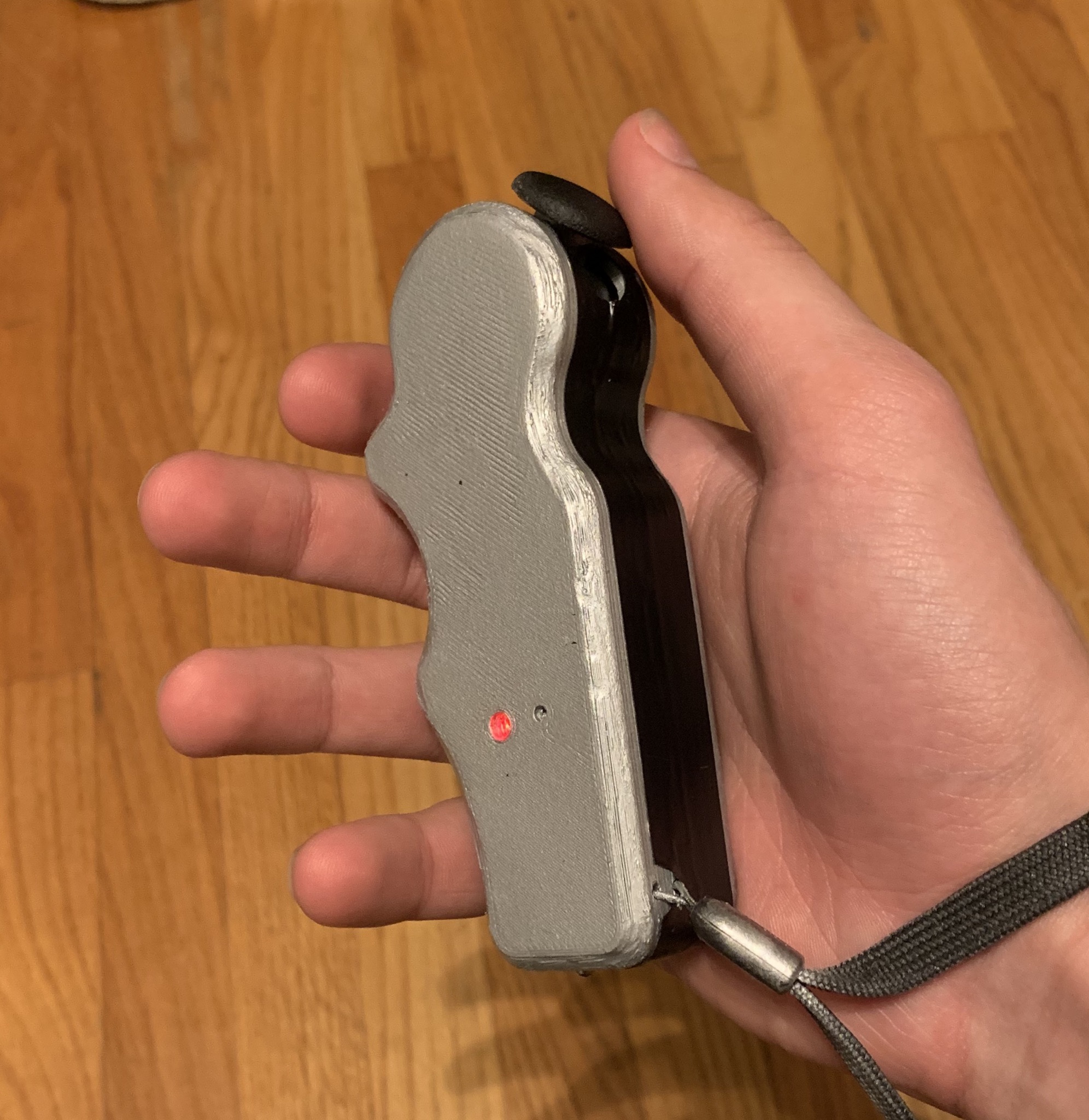

Finally got it pieced together, took a while to setup correctly in the vesc tool but now runs great!
Beautiful design Dani
Looking good!

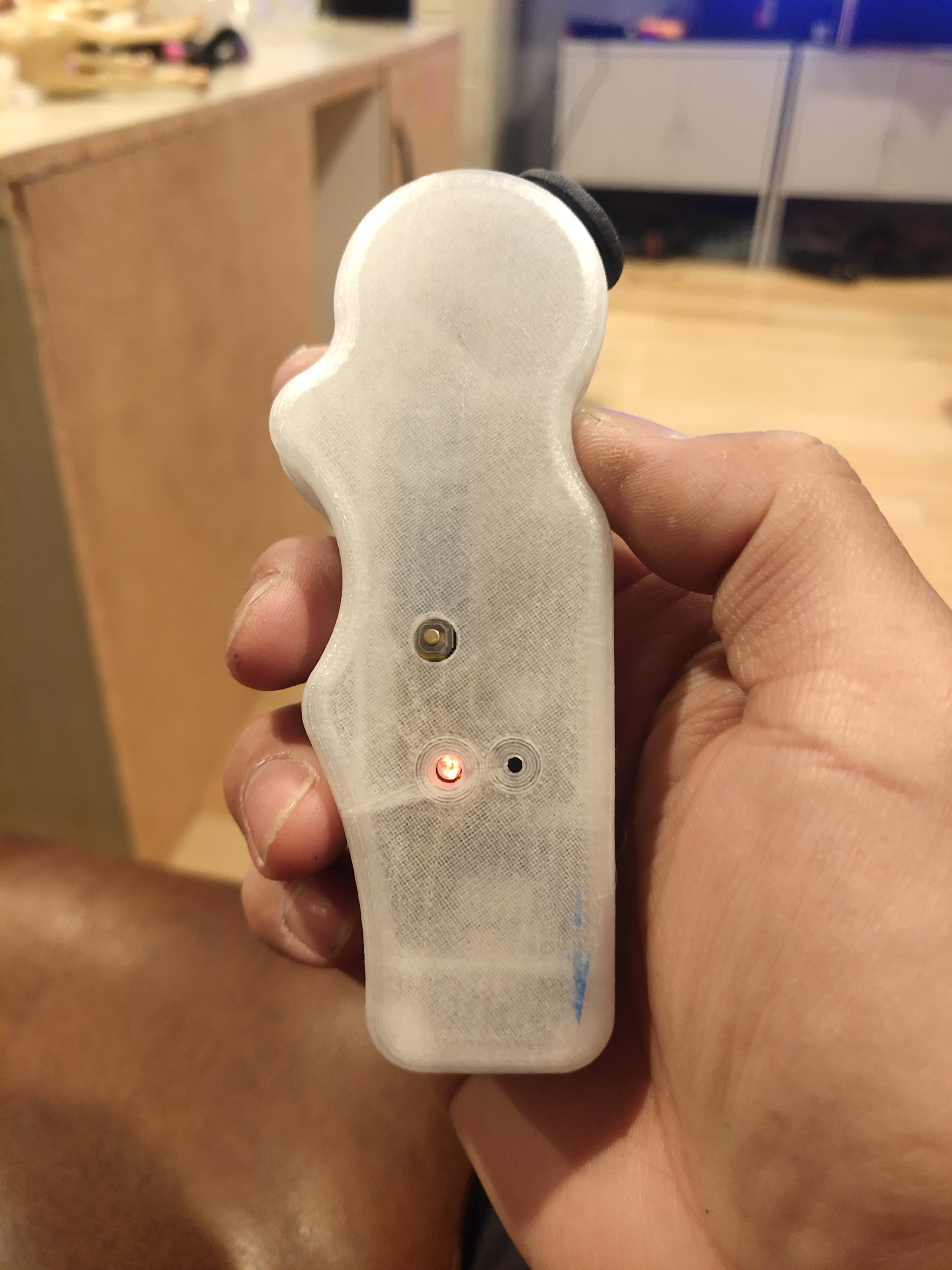

Went for a decently long ride with mine today but still convinced that the throttle is weird.
@dani what was the device in your video that you used to check the throttle curve map? Is it cheap? I wanna test mine.
I just measured the resistance while working the pot, simple DVM will do.
Maybe @Rob can chime in about the settings?
Check your throttle curve as well as the ‘input deadband’ tab in the vesc tool. Depends on your issue, but if have cutouts, mushy throttle, or strange inconsistent controls, just experiment with the settings in your ppm tab. A deadband increase would probably help with any signal peaks/spikes, as would a slight change from a strictly linear throttle pid setup. Also maybe check the ramping time… And maybe ‘recalibrate’ your range of the pot sensor while your at it… idk. I’m no tech wizard but that’s what worked for me.
I also noticed that if I push on the joystick, it won’t carry an outgoing signal, so if you are holding the controller wierd and pushing on your joystick, it may feel like the controller is cutting out when it’s really just a fault of the pots design. Just troubleshoot or give more info cause that’s all I got rn :man_shrugging:
