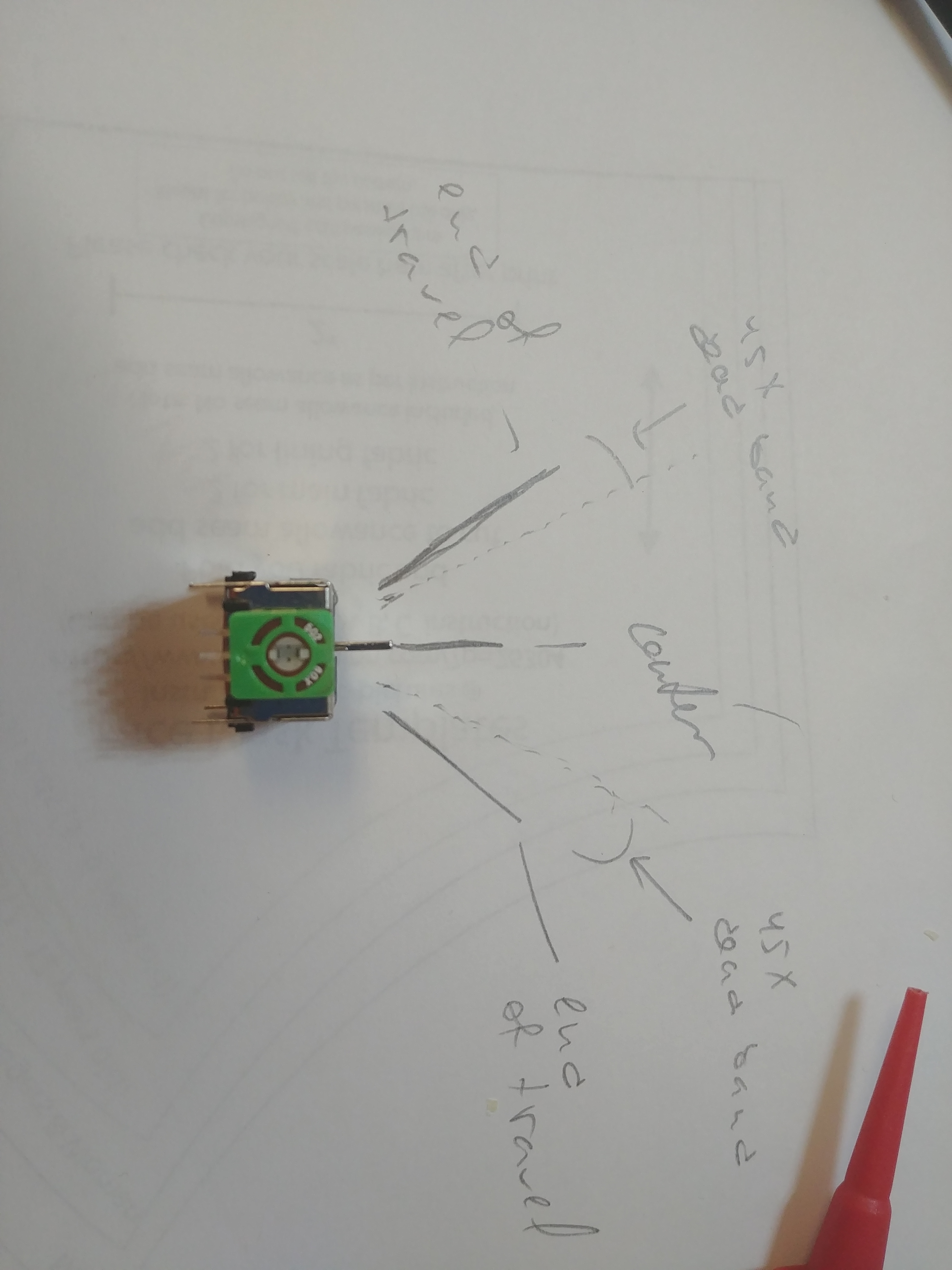

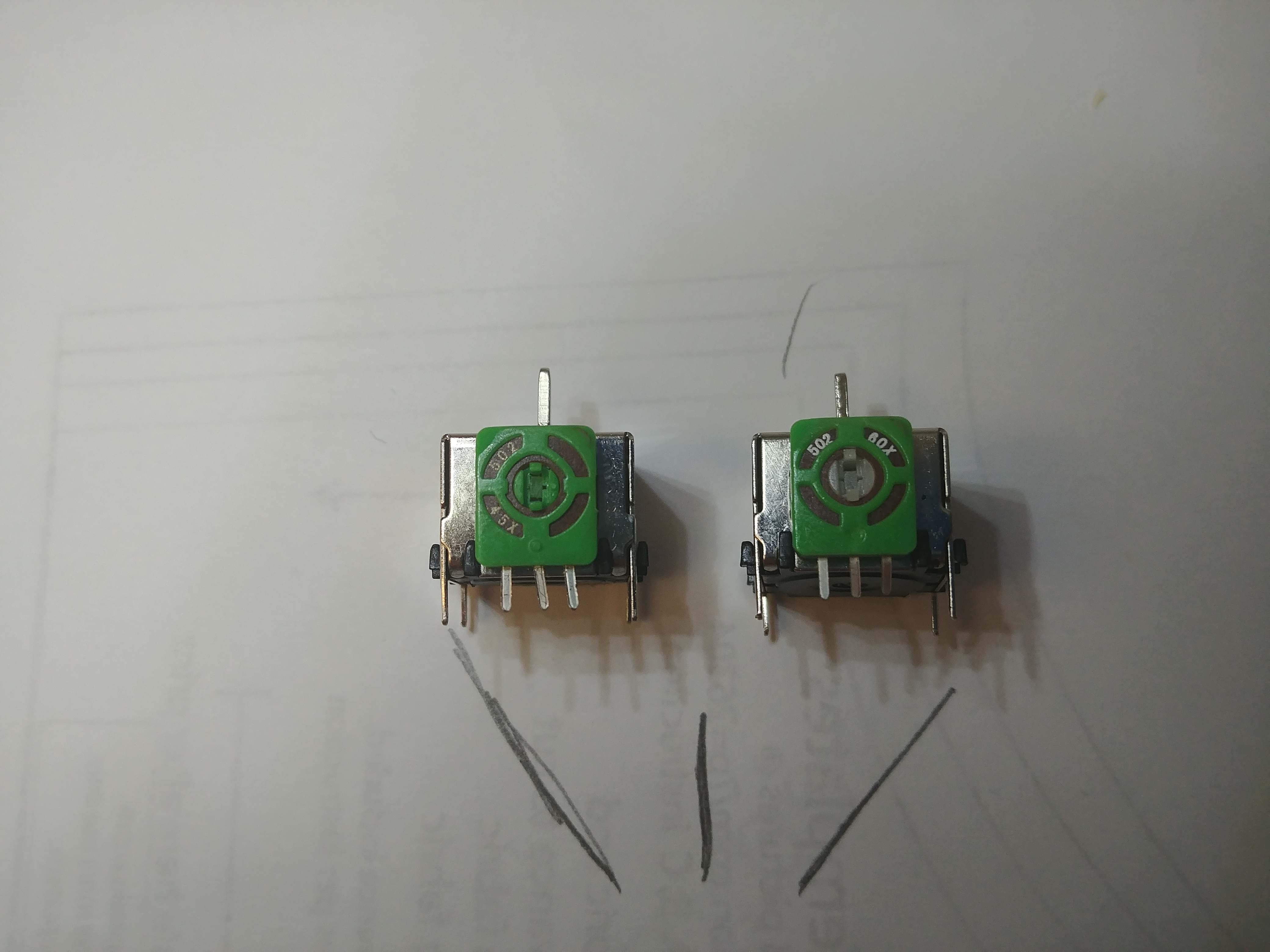

So I’ve finally got the package from @Bindings_McGee a week ago.
Ran some comparison today between two the two pots.
45x is what he got me and 60x is what I have.
I worked them both with dvm with resistance reading through the motion, here are the findings.
  1. Center reading is closer to the middle with 60x: 2.44k vs 2.27k on the 45x. I don’t think it’s a game changer.
  2. The dead band on the 45x starts sooner, see the attached drawing.
  3. Overall these are very similar.
