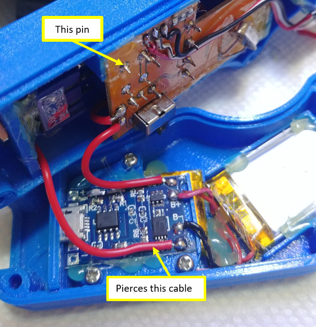

So I’m struggling with my chubby (ha) atm. Fitted everything into the housing. Looks great, but when I go to close, there seems to be a short somewhere. Even if it’s switched off, the red light comes on when closing the 2 pieces together. Couldn’t see any evidence of why. Anyone else had that happen?

So, made three units today, and couple of them had this problem, here’s what I’ve found:
When you’re closing this happens:

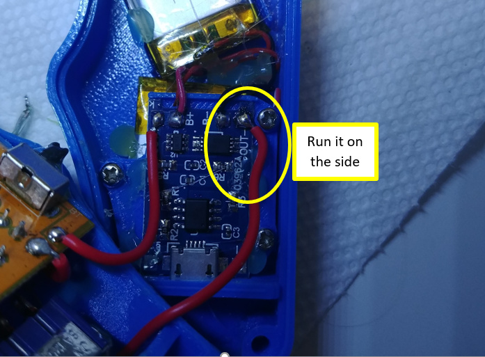

My solution was the following, just run it to the side a little bit:
It will probably also help to clip the pins a little.
