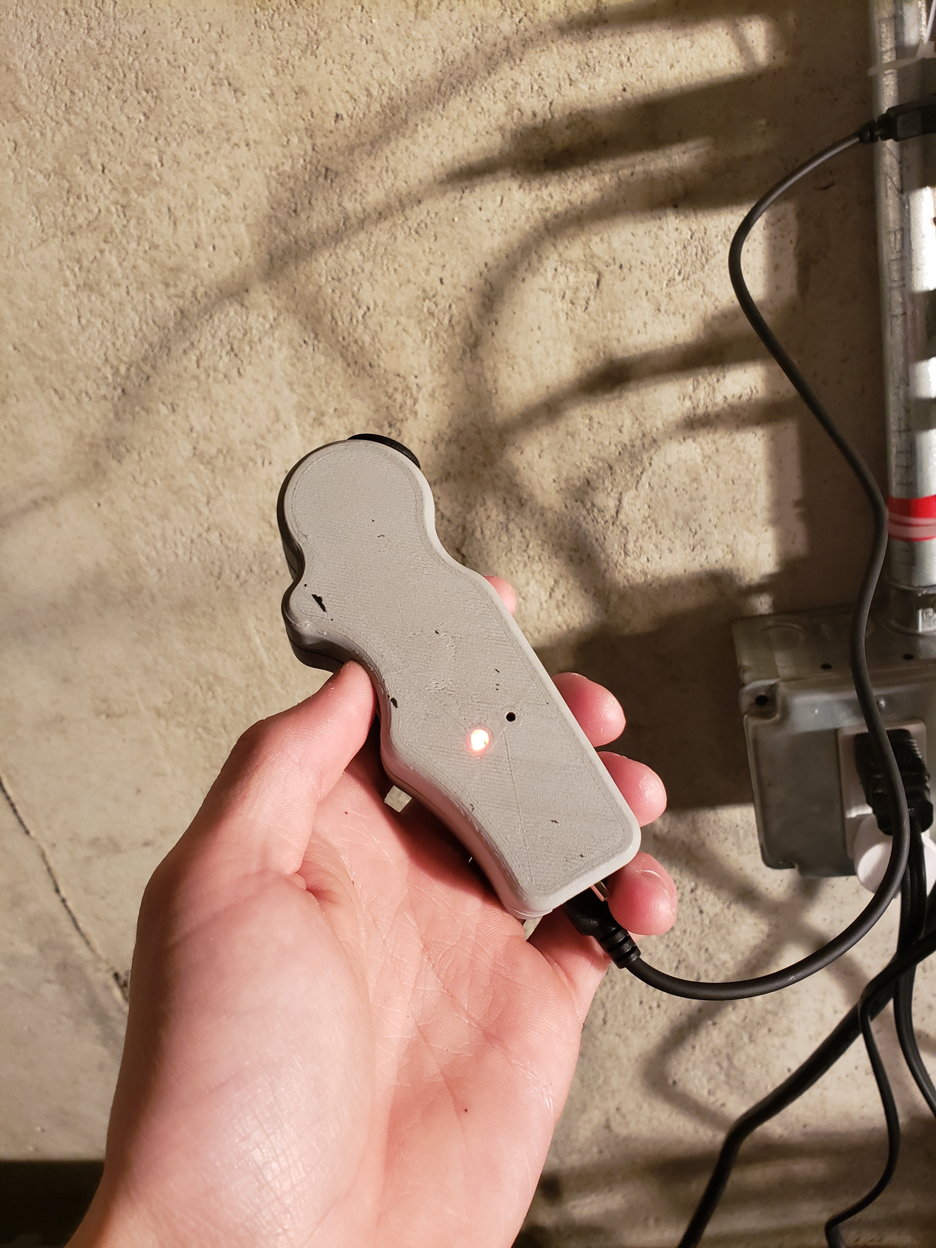

Just finished my Chubby.
First Impression is its FUCKING SPECTACULAR
Cant wait to go for a ride with it.
Love your first impressions!

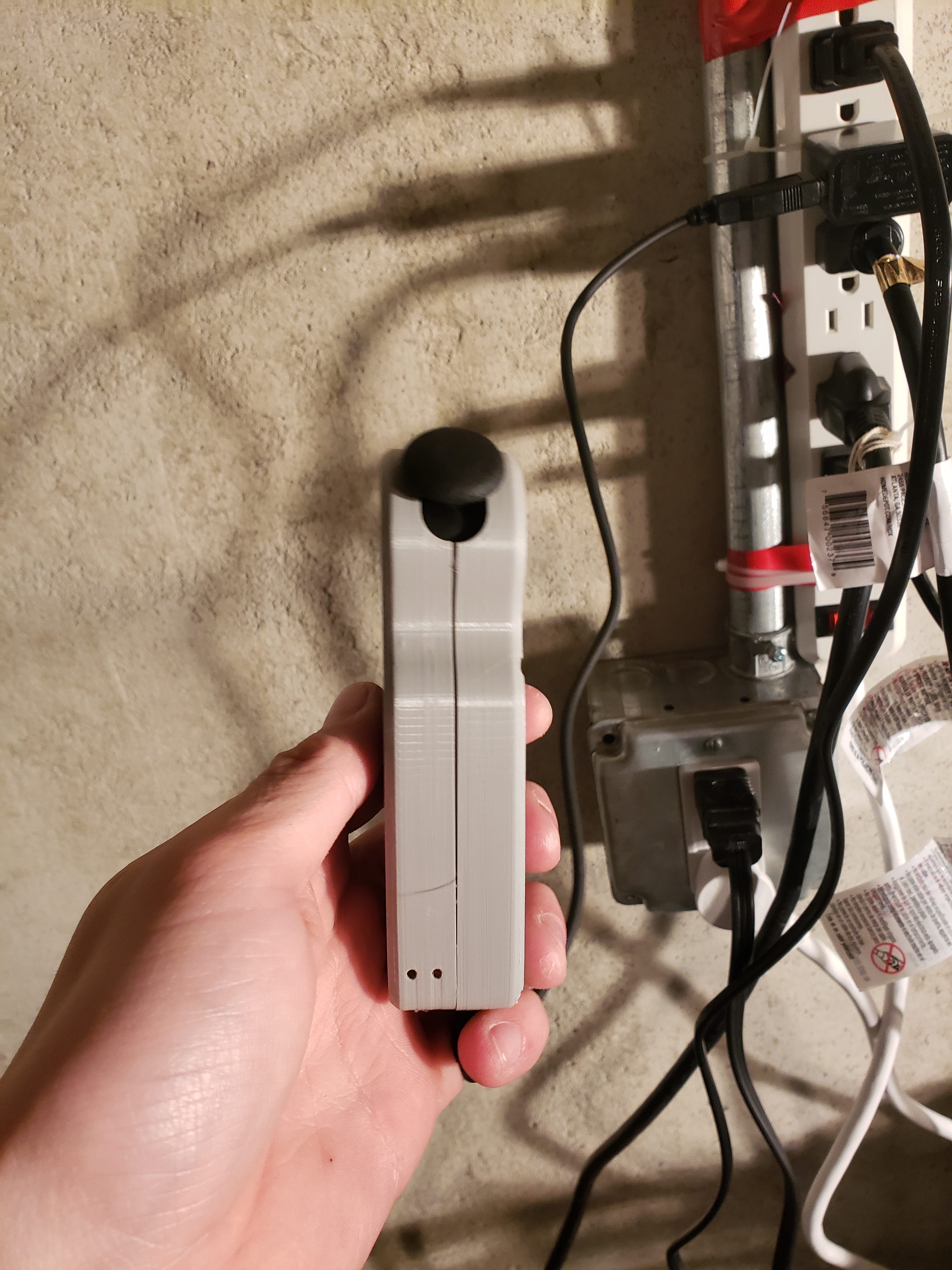

Why the space man!?
Close dat crack

Is it just the picture or the case is cracked?
Lol, I didn’t wanna be the one to say something
The space is closed currently, Had to find a diferent screw for that hole. The old mini one didnt grab that well.
@dani thats just a pencil mark or something, not a crack.
