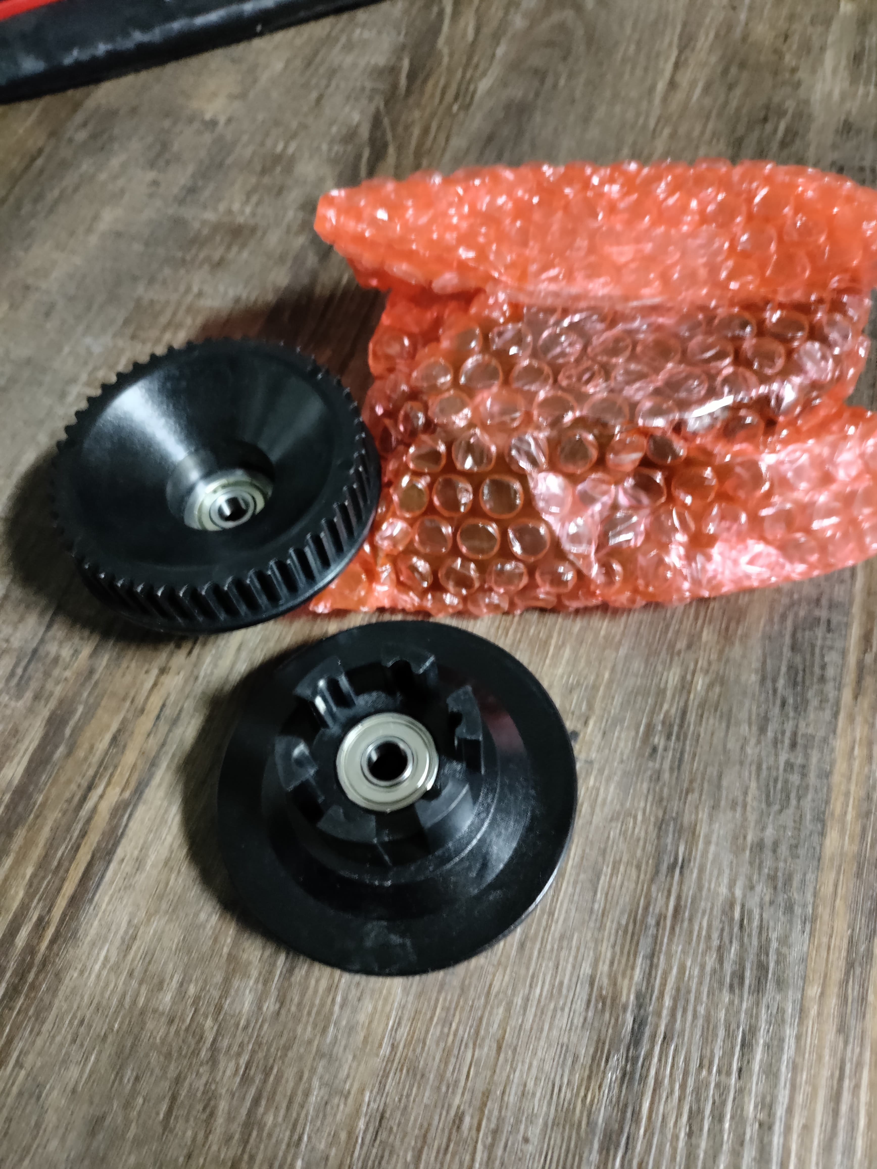

48T pulleys came in !!
BUT not only did I order the wrong type (abec) but also purchased 2 sets. Obviously my fault for not being more attentive when ordering but bkb has no specific description wether they are kegel or abec, just a single pick of the tooth count.

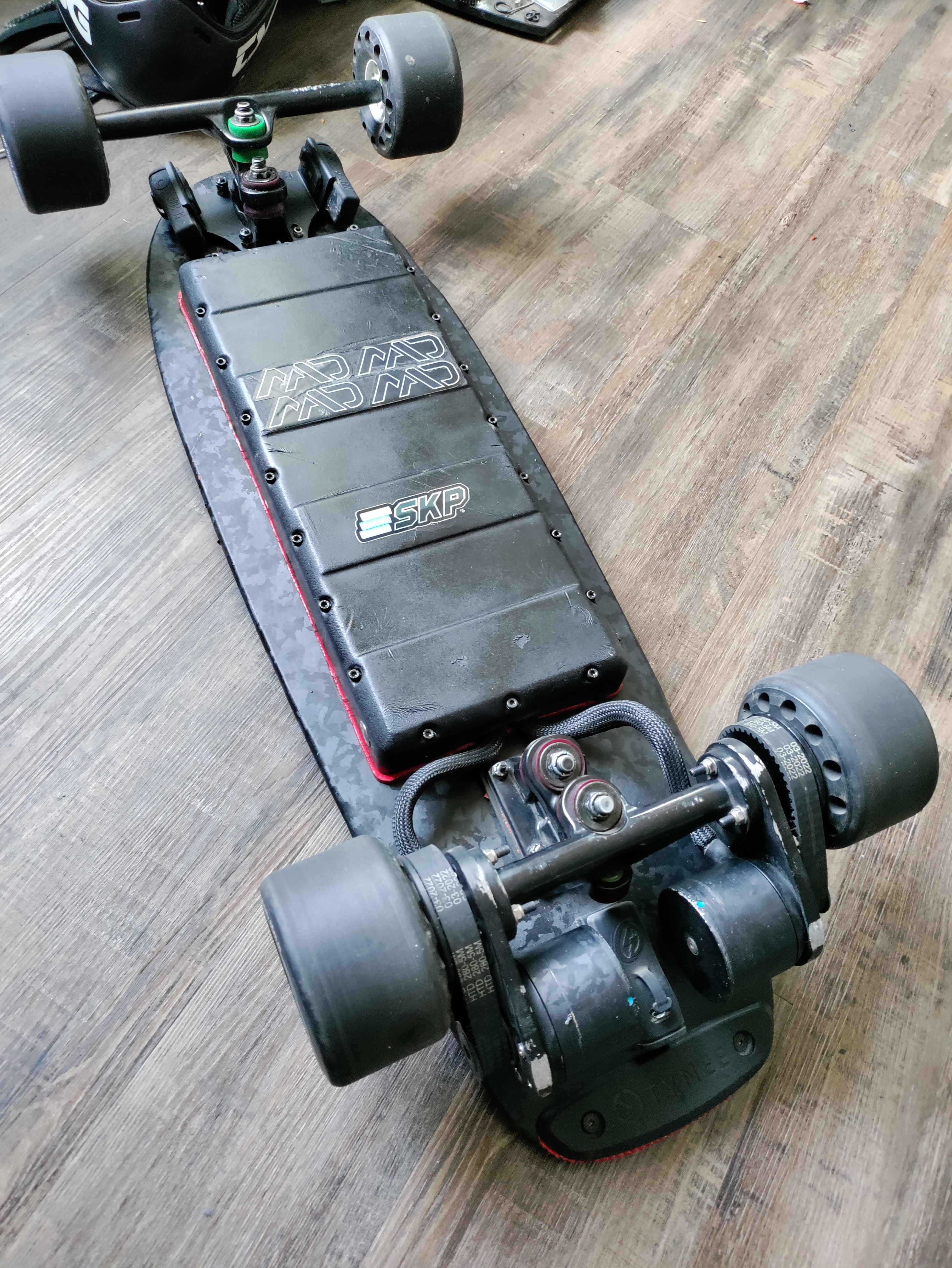

Though this enclosure is marked by my impatience, I still find satisfaction in the underside of this board.
The stickers provided by @fujio001 and @Skyart were the only stickers cool enough to match this boards swag, while covering up my biggest mistakes.
