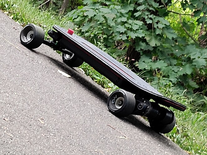

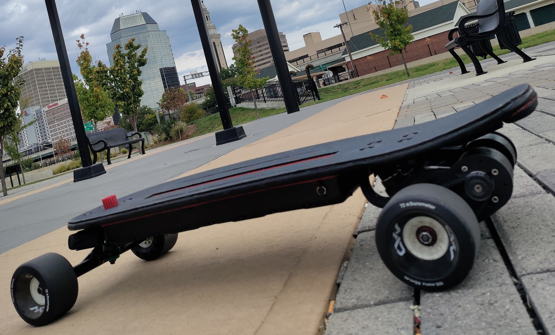

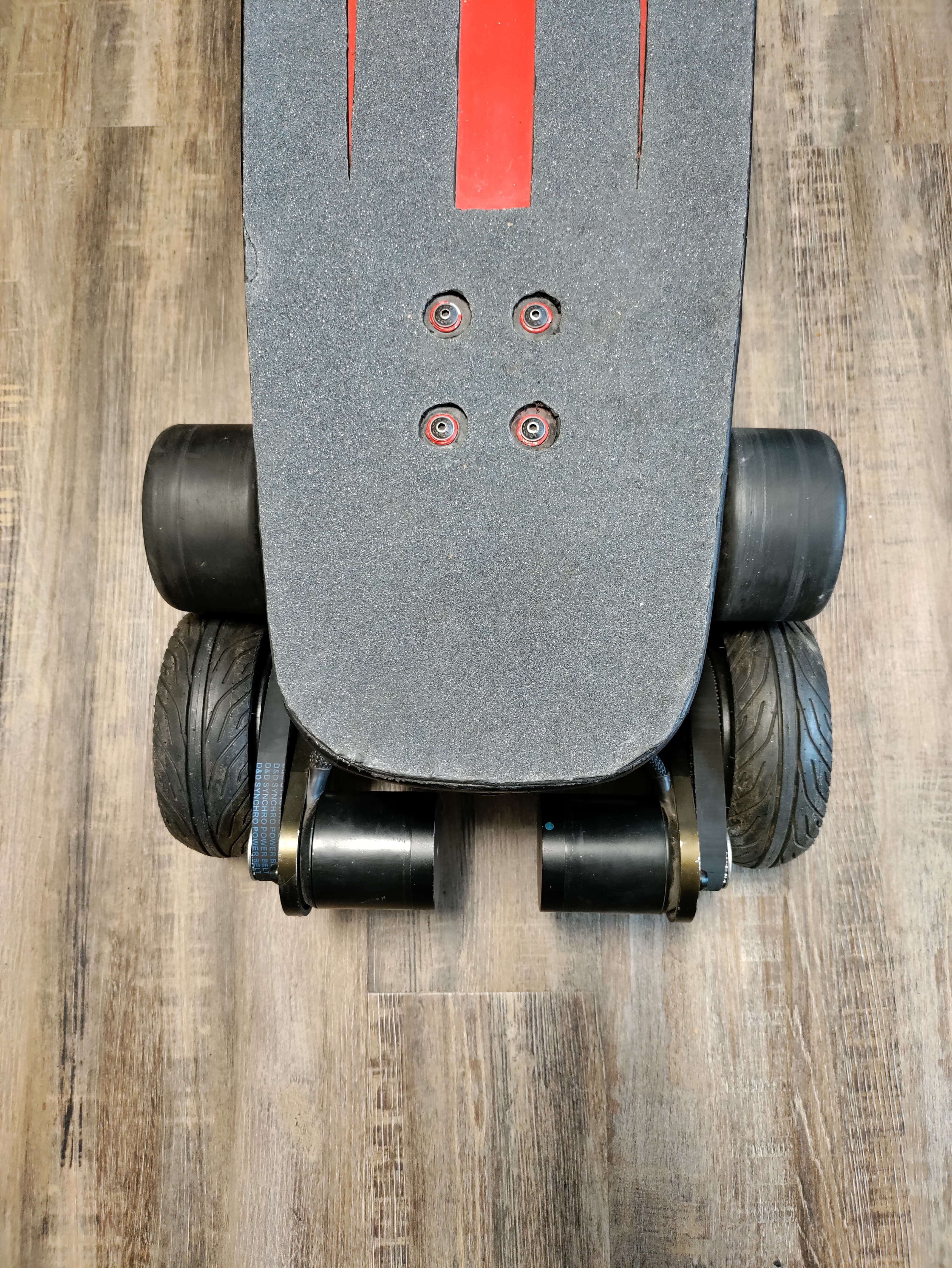

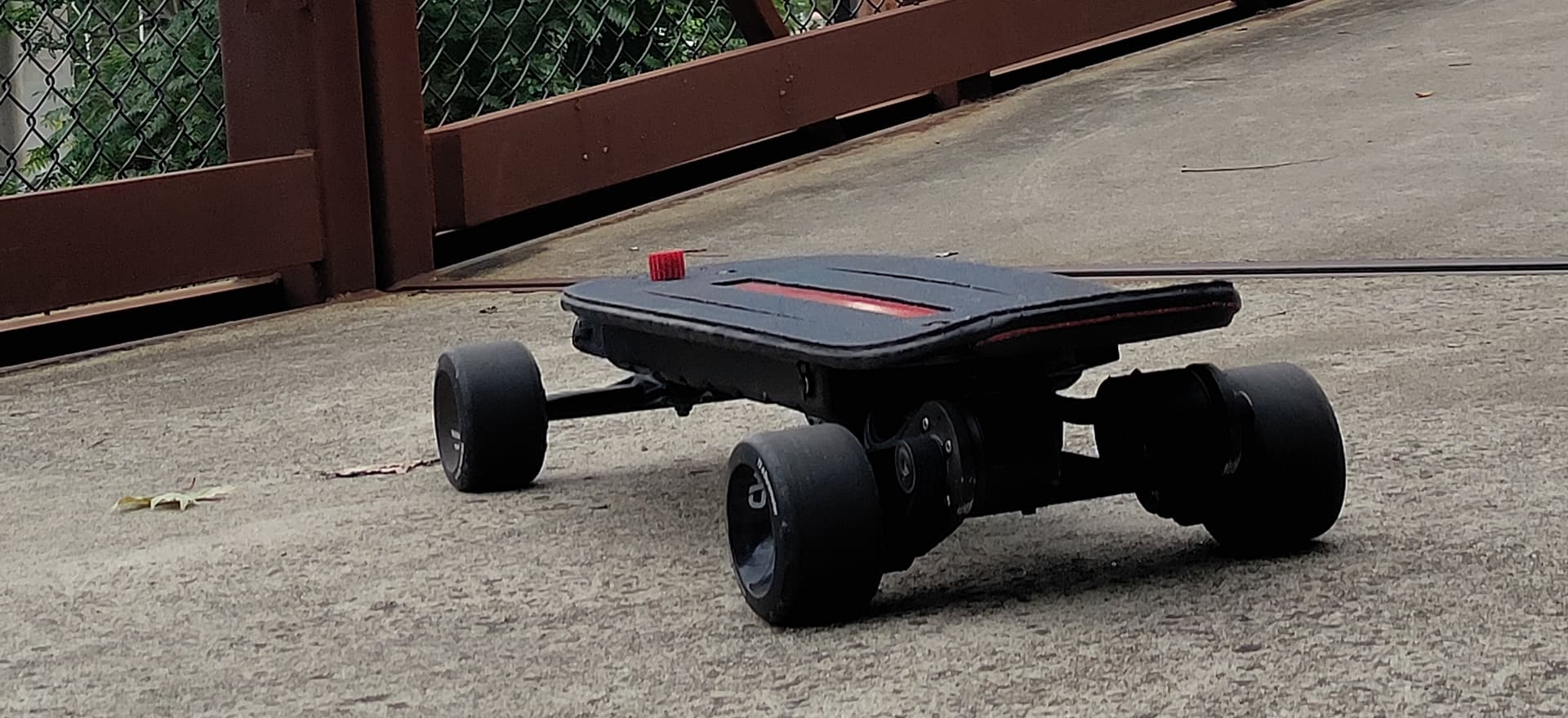

Cherry Angio | 31.5" Old School Pig | Xenith 2.1 | 12s2p P42A | Dual FSBH 6354 190kv |
12" DKP w/MAD 105’s VS 13.75" DKP w/TB 160’s
sHFI 45deg punch on Tenka.
(It’s much easier to pop the front end on Xenith)

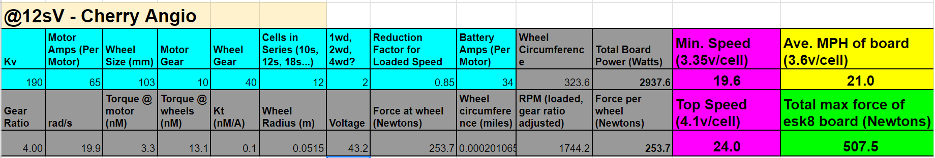

10T Torque upgrade?
all i hear is belt skippage
10T motor pulley on HTD5M is no good
@b264 What’s the lowest tooth count you’d go on HTD5M?
I personally would prefer 15T but in a pinch you could go down to 14T
I personally wouldn’t do 14T
Making the wheel pulley bigger and/or using the biggest wheel pulley you can is almost always better
These things also matter more on 1WD than on 2WD, which matters more than 4WD

@yoyotinker this is a good question. @Shadowfax’s calculator shows a handful of builds running 8,9,10 or 11T motor pulleys.
Are all these 10T builds running wider hardware?
I did 12T for a while and it was pretty miserable, I think it was at about half that torque as well. 14 ain’t too bad I think
I haven’t double checked all of them but I think most of the small number pulleys are either gear drive or chain, both are metal to metal so they have a much higher torque tolerance. The first two (hercaleez and space Invader at 11 and 9 respectively) are definitely gear drives
