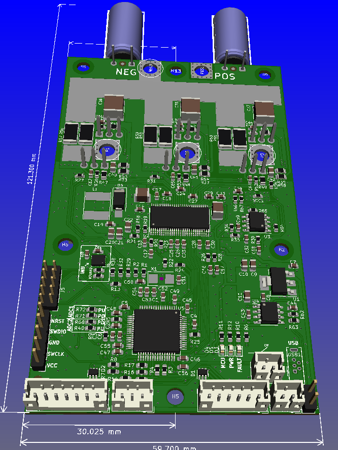

So I’ve been experimenting more with this thing. As of right now there are some limitations. Max safe motor current with FOC is 50A. Around 55A to 60A the controller throws a DRV fault and sometimes doesn’t operate correctly thereafter until the controller is power cycled. With BLDC mode, I went up to 75A with no issue.
Motor detection with newer firmware doesn’t always yield the correct measurements. I think this has more to do with how the newer detection algorithm is working with my specific hardware design. FW3.62 works like a champ though. I’m still working this issue as I would like the CFOC2 to be compatible with the latest and greatest features that Mr. Vedder and @Deodand are cranking out (like the HFI thing).

A lot of other “cheap” HW6 ESC’s claim 50A max, but likely are not safe running FOC at 50A for any length of time. If this unit can safely run FOC at 50A no problem, then its already miles ahead of other “50A controllers.”
50A checks out on the bench. See my testing results earlier in this thread

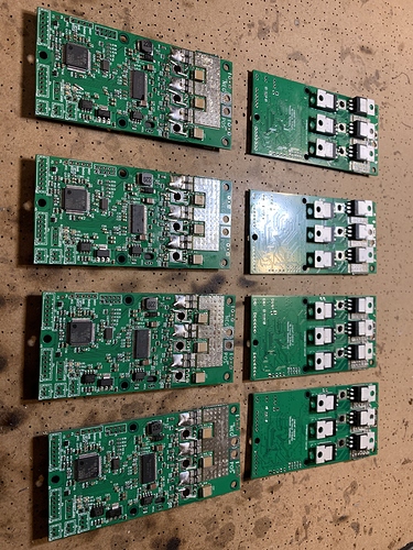

Also got the latest revision ready for JLCPCB once they get their SMT service back online. Assuming things go well with the beta units, I’m just going to validate this revision myself. Then I’ll kick it out to world.
I hope with the current coronavirus situation JLCPCB is still producing. Could be a real problem.
They are but with limited capability and a big backlog. No SMT service and no ENIG finish (gold plating for fancy PCBs)
Ran out of FETs but I had enough for these. I’ll snag some more FETs this week
