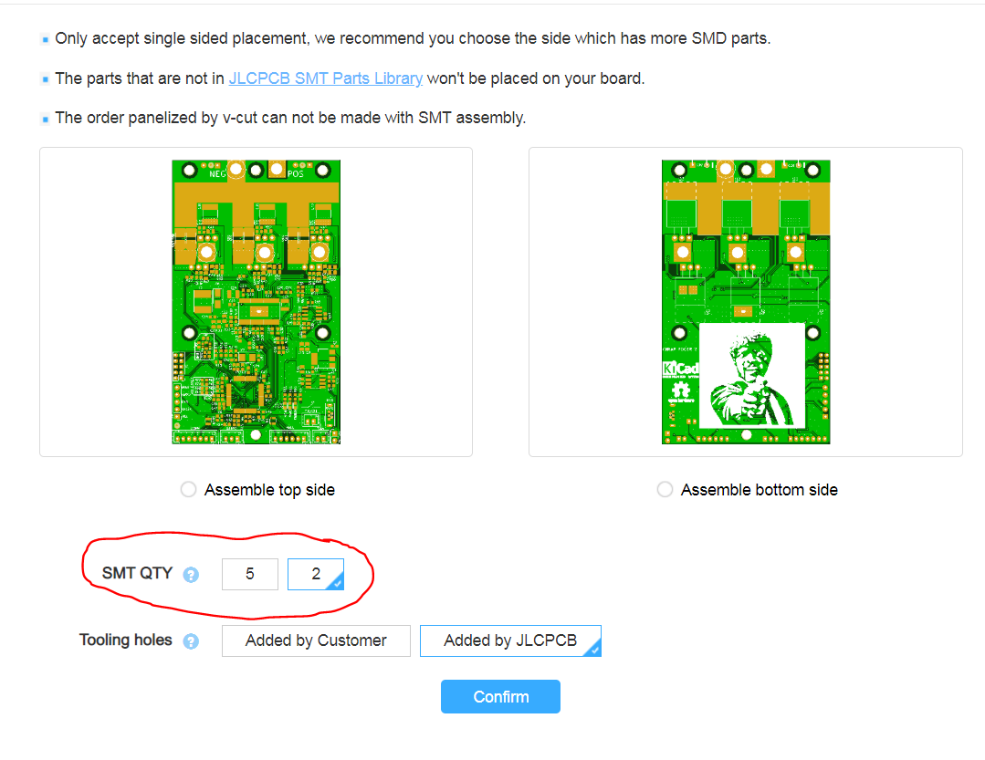

Hmmm. Looks like JLCPCB has an option to assemble only 2 out of the 5 PCB minimum. Seems perfect if you ask me…

Cost of 5 CFOC2 PCBs with only 2 getting SMT assembly
Cost of remaining components(FETs, caps. connectors, ect) from LCSC
Just putting some pricing into perspective. Using JLCPCB’s assembly service with the intent to have them assemble as much as possible causes one to have the “extended components fee” tacked on. This is $3 per component they have labeled “extended” which essentially means a component they don’t typically keep loaded in their pick and place machines. They have to do extra work to load up the “extended” components. This fee is $15 in this particular order. Would have been $18 if they had the DRV8301 in stock but they don’t as of this moment. Now one can avoid the “extended components fee” by choosing to purchase and populate those specific components them self. Not hard but it it will take a bit more time. Of course this pricing gets much better per unit with the more you have made. The “extended components fee” carries much less weight and becomes much more worth it. Making this in larger quantities is where the “cheap” in the Cheap FOCer really shines. Even so, this order of the 2 assembled PCBs is $60.76USD before shipping.
So JLCPCB isn’t going to have everything to complete the CFOC2. One will have to order anything that’s left over (FETs, large caps, connectors, possibly the DRV, ect). I loaded a cart in LCSC of these left over components for 2 CFOC2s which came out to about $21. Thankfully I’m grandfathered into LCSC’s old shipping deal. They used to offer free shipping if you had a corresponding order with JLCPCB but they had to nix it due to tax reasons. Now they just heavily discount the shipping if you were a member at the time of the old deal.
So there you have it. You still have to account for the other hardware such as cables or the heatsink but at the end this will run you about $95 or so after shipping and hardware if you only make 2 units. Still cheaper than 2x VESC 6. I’m sure the community could come together and do group orders of this to get the better price points. Yall would have to figure out the shipping everything to the individuals though.
