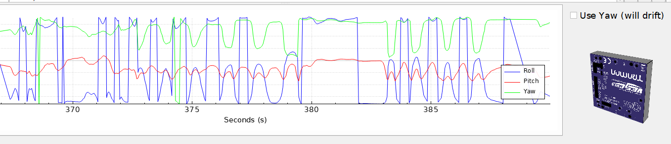

Assembled and fired up the new rev. Spun a motor on the bench at 60+ amps FOC sensorless with no trouble. The beta units started having trouble with DRV faults at this point. Seems like my gate drive improvements worked but I’ll need to do further analysis to be certain. Expect waveforms soon!
Let me configure the Cheap FOCer for your eBike, so it does wheelies :smiley:
Maybe. One step at time though.
The IMU does work though!
