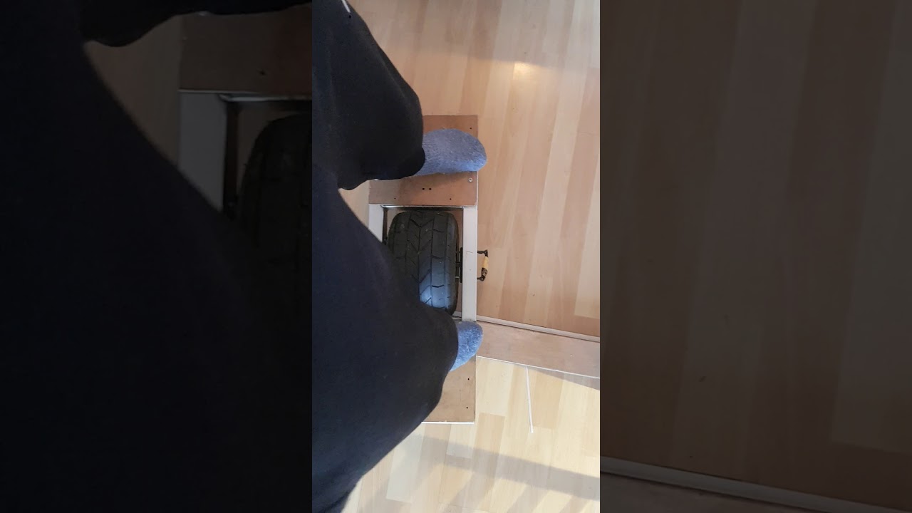

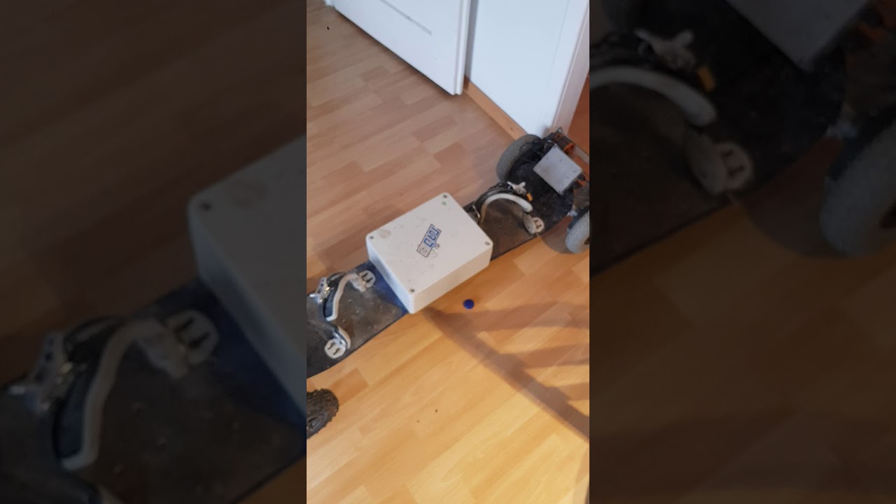

Today i flashed the new beta firmware (5.03) to the mountainboard and the onewheel. ASS seems not to be working well and when switching to sensorless its doing the same thing (HALL mode on the onewheel works fine):
ASS seems to have a dependency on motors with temp sensors and other factors that may or may not have been disclosed by Trampa. I’ll be experimenting with ASS on my own very soon
